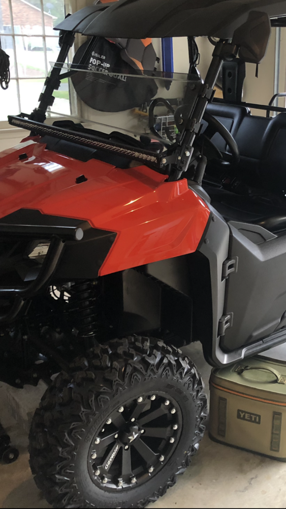

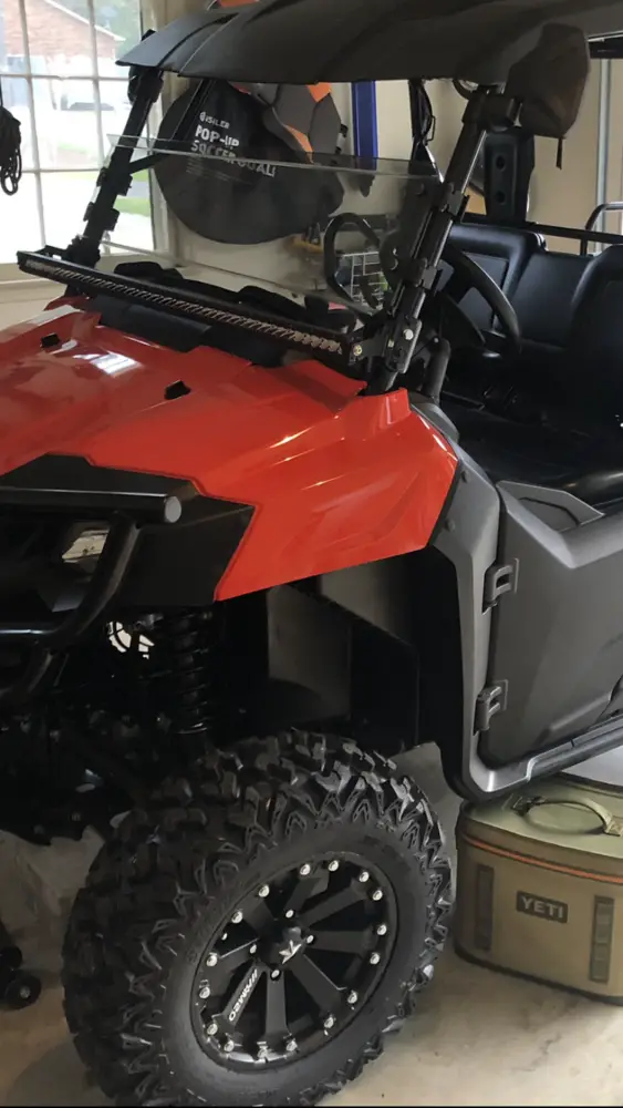

No issues with binding yet and I hit the trails last weekend pretty hard to test them out. I can take some more pics tomorrow, anything in particular you’re wanting to see?

@Rickg83 thanks, just a side view shot and some front and rear of the suspension.

@Cdaily3
These work?

Ps hard to tell from the pics but my driveway is on an incline, the pioneer actually sits flat

Thanks those work great, my main concern is the angle of the CV axles and it doesn’t look to bad at all. I like how yours sits too what size tires are those?

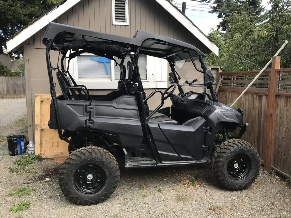

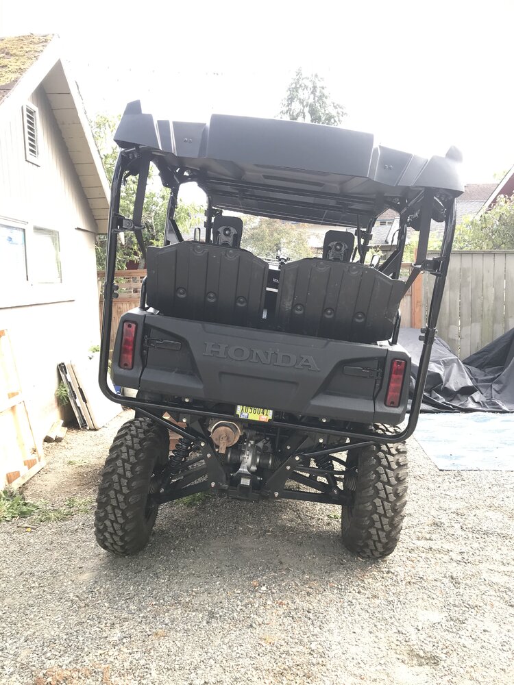

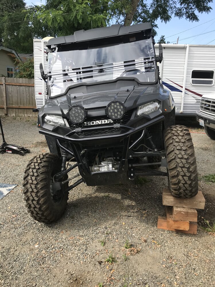

So got the P1000 shocks installed in the rear today. Gained 1.5 of lift new ground clearance to bottom of the rear skid is 14.5” thanks @ohanacreek for shipping those out to me, can’t wait to see how it sits with the fronts on. I flex it out at the same height as stock and now at about 19” off the ground all for tires are still on the ground ( that’s with the rear sway bar off) hopefully with the fronts I’ll get a bit more articulation since every bit helps when it’s not a sport machine.
View attachment 218277 View attachment 218278 View attachment 218279
You’ll like it, it made mine much better.
