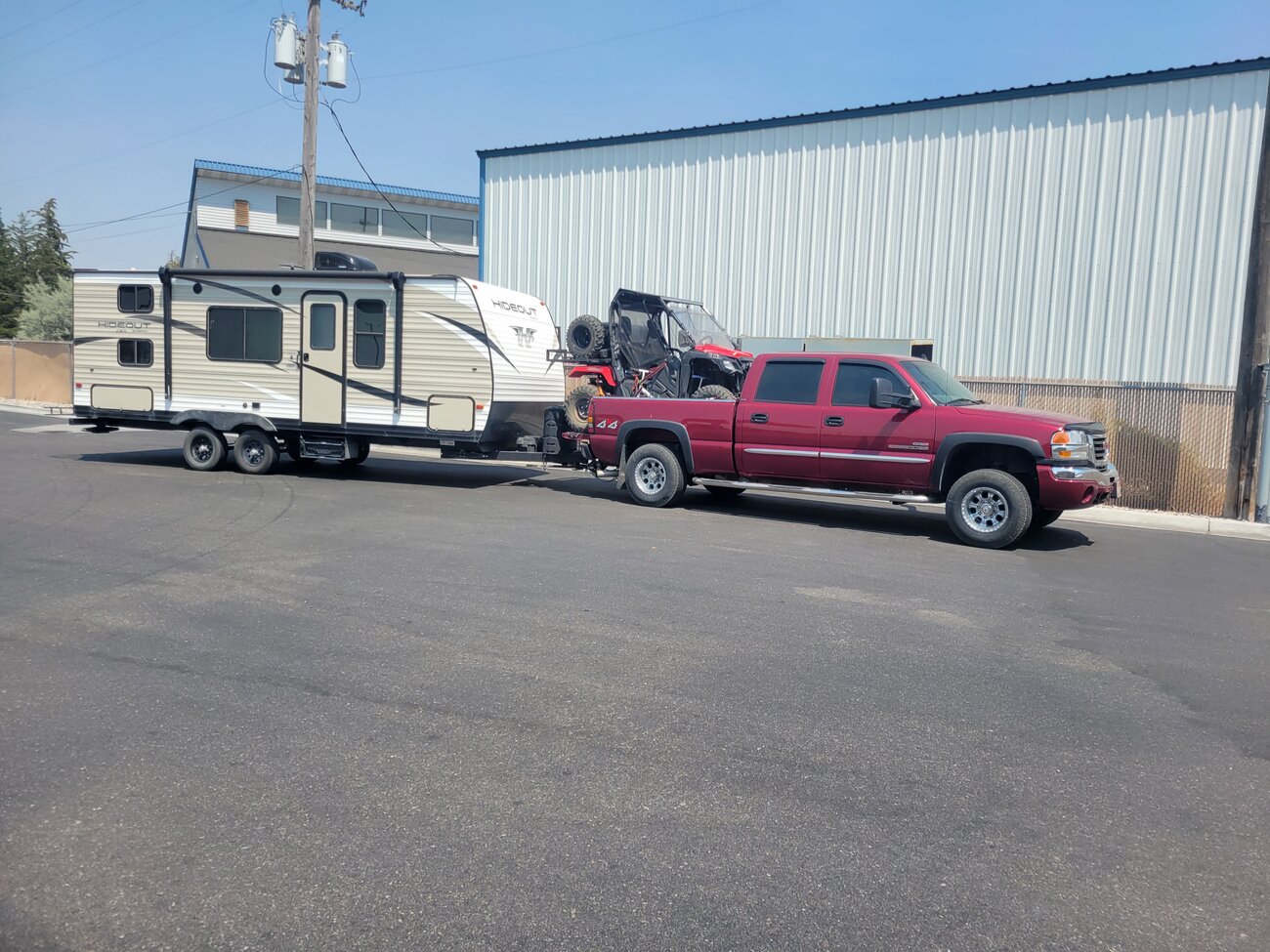

P500 with 1.5" spacers fit in my 6.5 GMC bed with tailgate down. I believe I drive over the wheelwells with the spacers on. Back tires rest on tailgate.
As noted on the other threads: heavy duty ramps, tailgate supports, and 1.5 or 2" straps.

when you drive over 48in. wheel wells, doesnt the lower frame(ropes) then hit the wheel wells?

Mine does not, but I am running 27" Tusk terrabites, so the added height might be the trick. It is very close to fitting inbetween the wheel wells.
Also +1 to the titan ramps comment. I use the 9 or 10' long, extra wide ramps. Pricey, but solid and safer. Expensive ramps are cheaper than damage to your truck and machine plus a new pair of shorts...
I only haul in the truck bed when pulling my camper at the same time, otherwise I trailer the P500.
