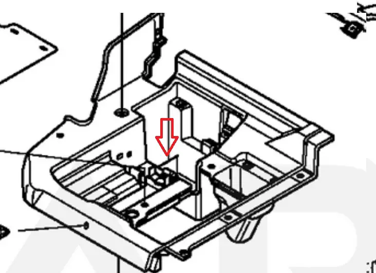

It is a piece in the battery tray that restricts the SMALL batter from moving left and right. I just took a razor knife and was able to cut it out easily. I have no idea why honda engineers thought this was a good idea putting the smaller battery in, but after trying alot of other things, the bigger battery fixed my issues. Heck even the Rincon atv and Canadian 700s come with a bigger battery. I guess 75% of people won't have trouble with the smaller battery but the 25% that live in the cold will find it's weak link. I don't know if the 310cca is needed but I figured if I was going to go through the trouble, I wanted the biggest battery that would fit. Best of luck but I remember your pain well.
