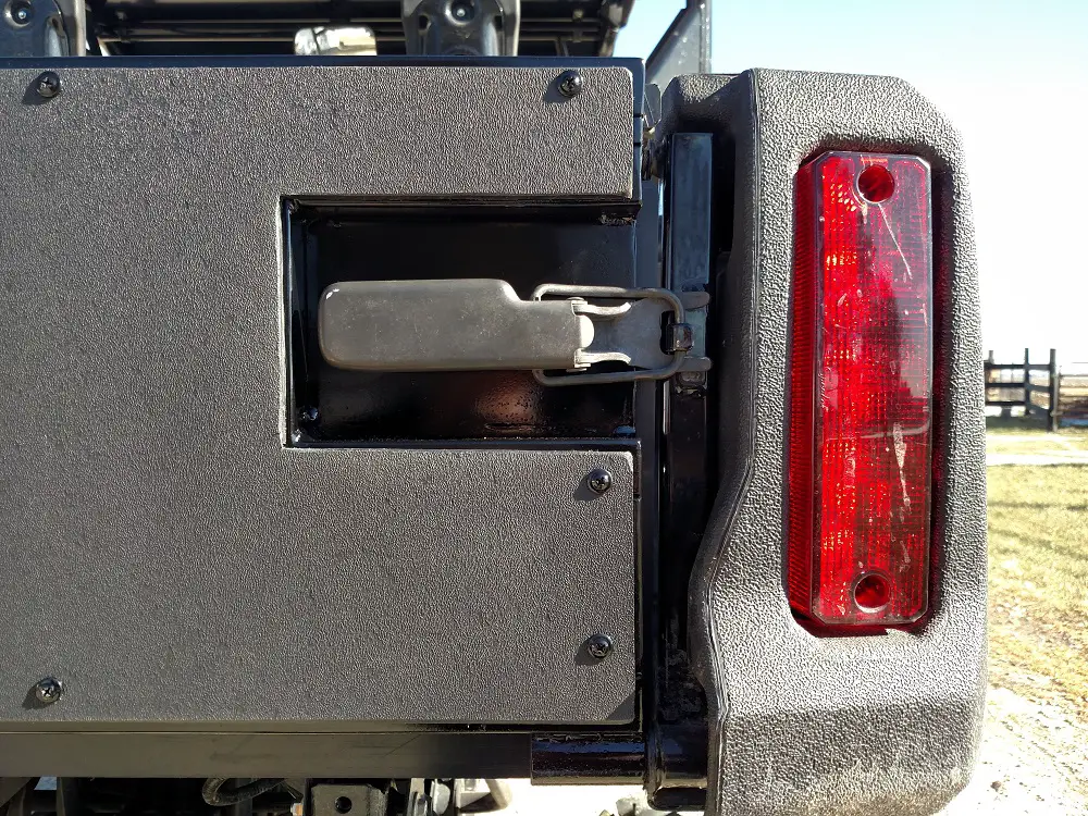

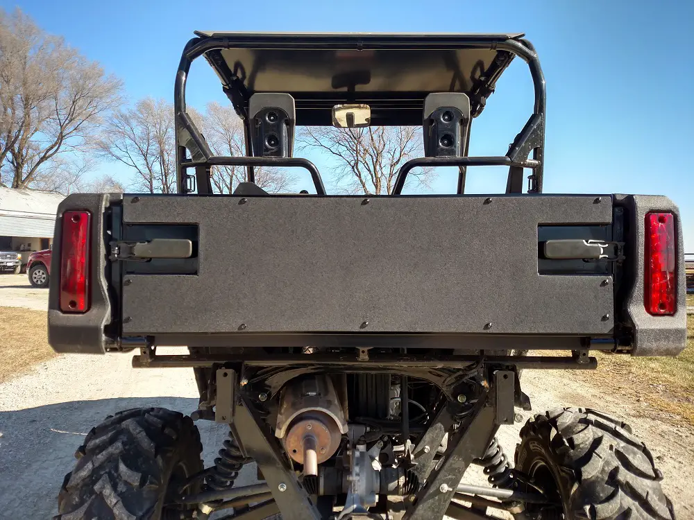

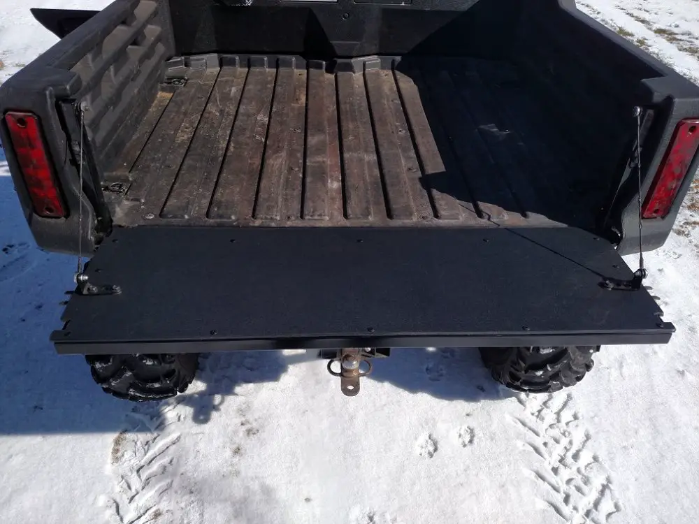

Hey guys, I finally got around to addressing the other half of the crappy tailgate scenario that Honda gave us. I just couldn't live with that flimsy piece of plastic any longer. So, this happened.....
IMG 20160204 113434894 HDR
IMG 20160204 113629964
IMG 20160217 120648331
It doesn't bend. It's has a flat surface so your beer won't spill. You can sit on it. And it lays flat with my special cables installed!
I went ahead and made two of them. The second one is listed on ebay....Honda Pioneer 700 Tailgate
Let me know what you think!

Thanks! When I started I was worried about the looks being too square or blocky. It might be eye of the beholder, but it seems to look ok. For me it came down to strength over looks anyways.
Forgot to mention here that I tested the HDPE for expansion from 0F to 155F. The point is to avoid a wavy surface.

Ended listing for now. Had a ray of sun cooking one edge of plastic and it buckled. I tested for this but missed one thing. To be continued....

Re-listed the tailgate with a lower price. Never had time to tinker with the slight warping that mine did. But, it hasn't done it again. Might get back into these later in the year.

No sorry... The "plastic" was just too temperamental to release to "the public"... I ended up replacing the plastic on mine with aluminum sheet. Unfortunately the aluminum makes the tailgate much more expensive. And... after dealing with having my cables cloned by china I wasn't really excited about having my good idea ripped off again. Maybe someday.
