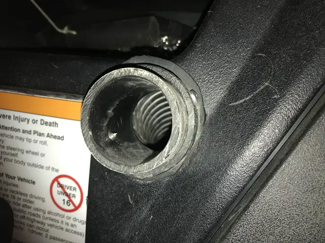

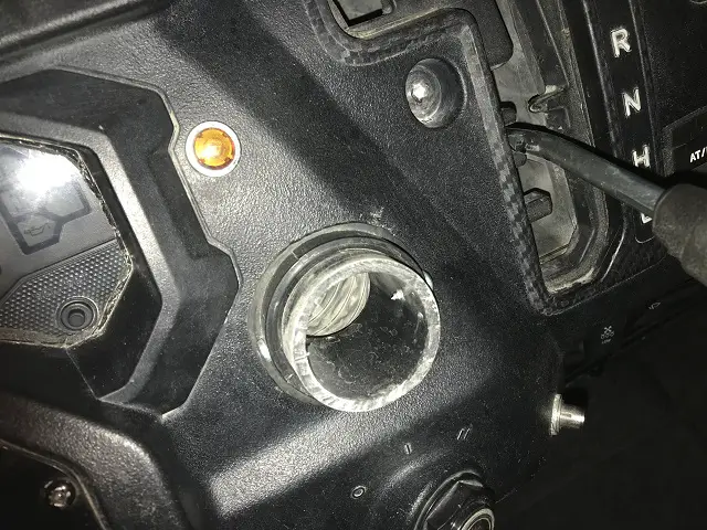

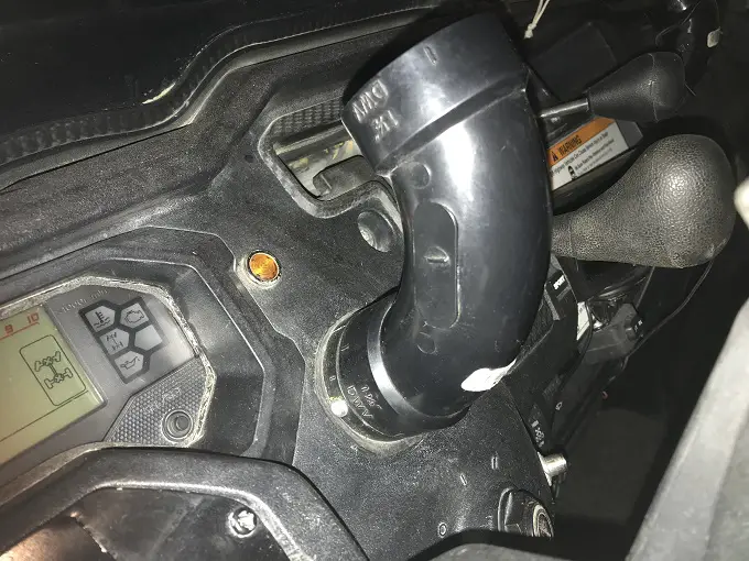

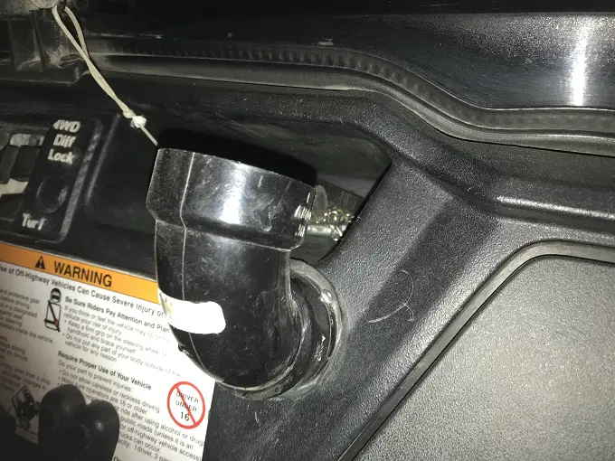

I've have mine set up like this for the windshield since buying it [used] This keeps the windshield clear untill you drive through water and it steams up for a short while. This only happens in the fall when the water hasn't turned to ice . In the winter it very seldom steams up . The placement of the vents is important so that when you drill through your not drilling into something important . More so on the speedometer side you don't want to drill into that . By the glove box you want to keep the hole in the raised portion of the dash as well. I used 1 1/2" pvc to go through the dash left enough sticking under neat and on top to be able to put a a 90 on top and the hose on the umderside. I used a short piece of the pipe joiner on the bottom [that is glued on] and on top the short piece of the joiner is screwed on with a rubber inner tube as a gasket between the dash and joiner. Clamped the hose on the backside and the elbow just sits on the top. Driverside is a long elbow passenger side is normal elbow. This works for me so juts throwing this idea your way.
View attachment 378469 View attachment 378470 View attachment 378471 View attachment 378472
I like that! I am thinking more along the lines of a 1-1/2” or 2” pvc pipe for a “header” of sorts. Caps on the ends, and tees spaced out. One for each end and 1 or 2 in the middle for heater vents/defrost. And one tee facing down for the hose connection. I’m thinking that I can get or make a couple brackets to attach to the ROPS that will be low profile and clear the windshield, or possibly get longer grade 8 bolts for the ROPS bolted connection to add a bracket and come up and out, to attach the pvc header to. Amazon and Summit both have several options for flexible heater hose ducts and vents, so it’s just a matter of choosing the size that will fit best into the pvc pipe or tees and that will determine which size pvc to go with, but I’m thinking it can be 2” with a size change down to 1-1/2” for the hose connection. Anyways, I’m glad to see this. As I get some things worked out, and actually build it, I will post a new thread about it. I really need to go through and document everything I’ve done, it’s a lot, that people might like to see how to do, or for ideas. Thanks for sharing yours, it helped me out!!

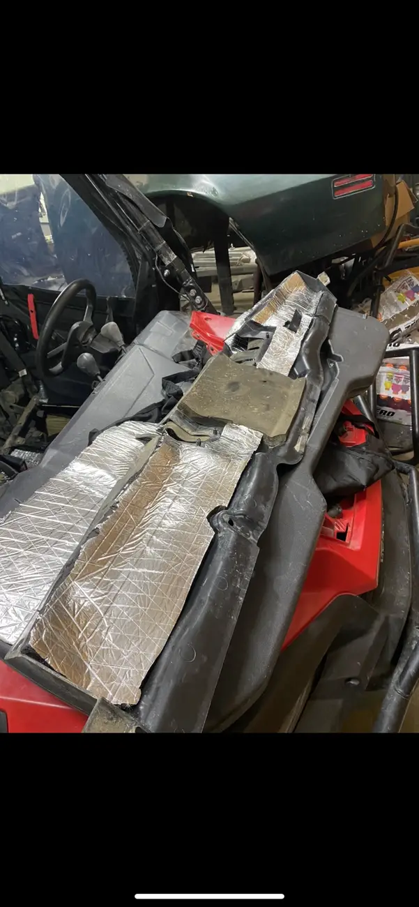

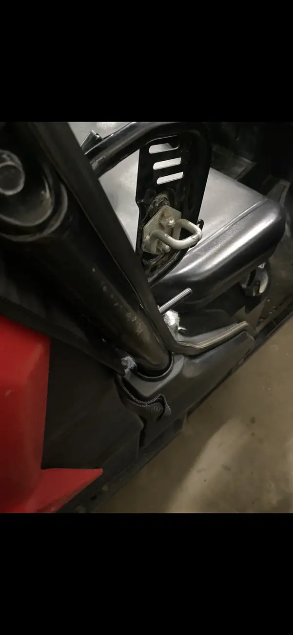

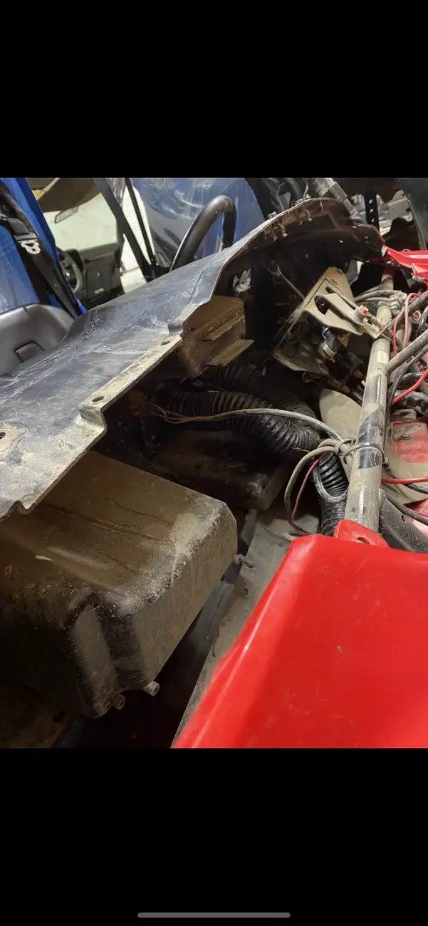

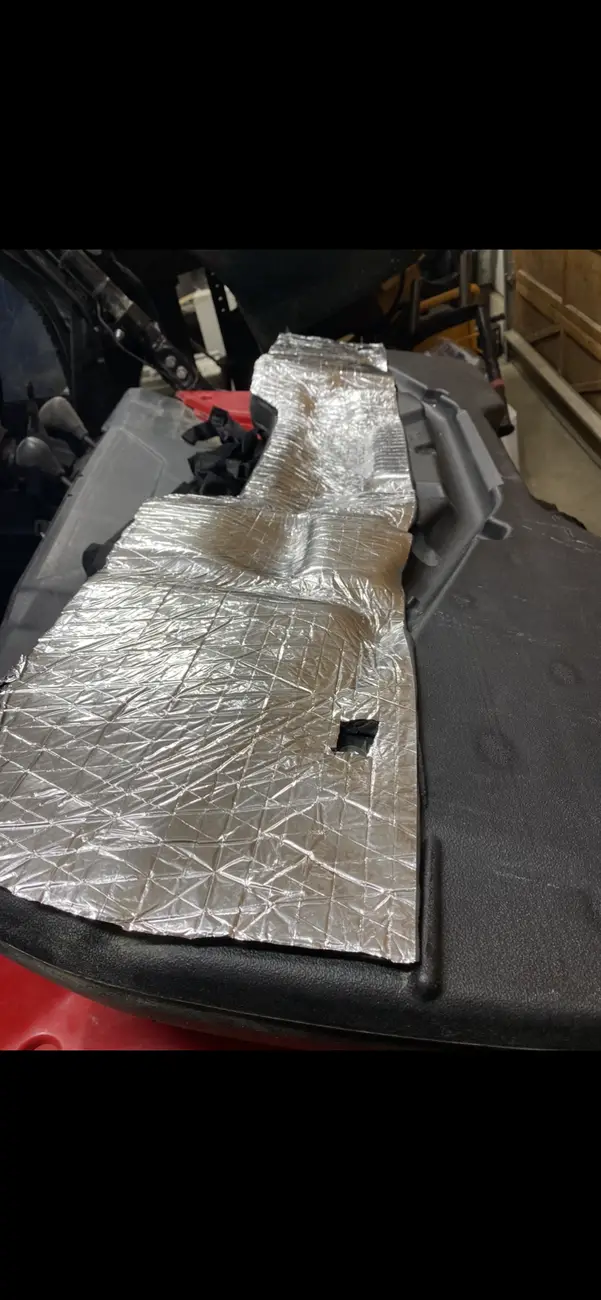

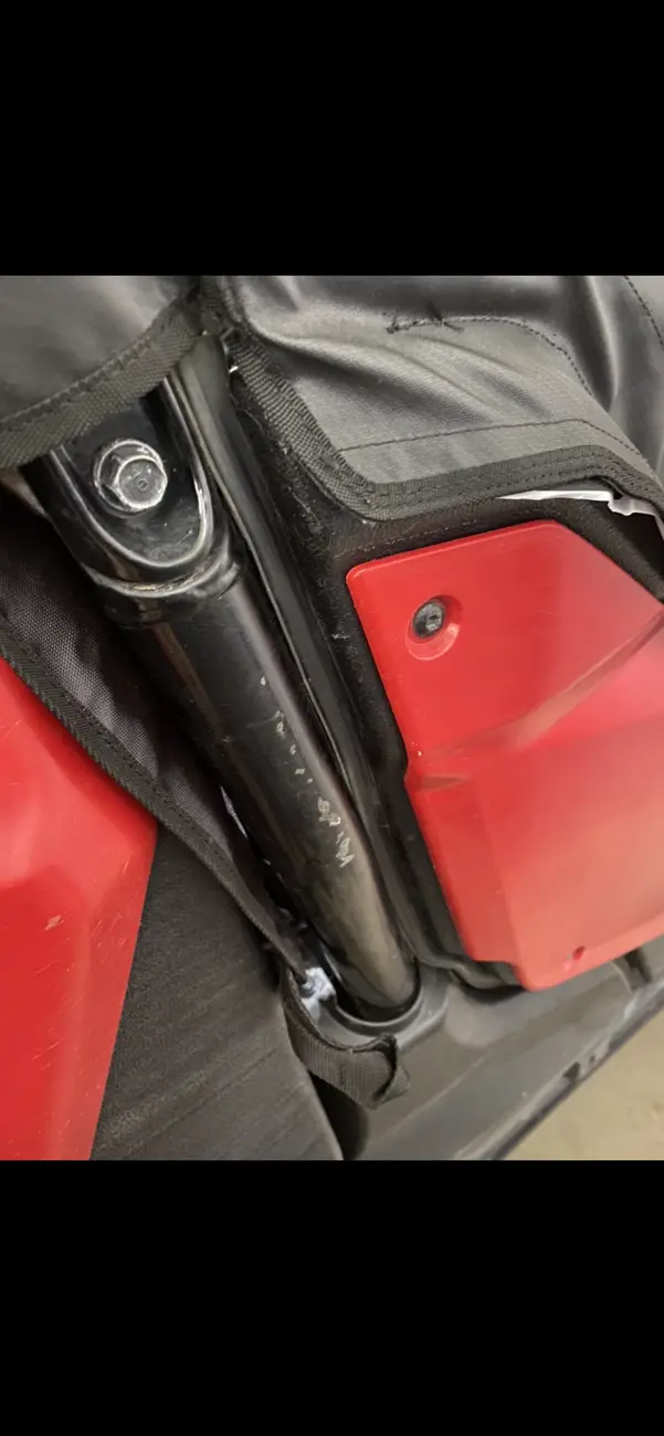

I live in Fort Mac Alberta. -30 is quite normal for winter without the windchill. I take my machine out in -20 all the time and I only wear a long sleeve shirt, hoodie and insulated pants. Your heater will not work while the machine is moving if you dont do the following. I added some pictures of some things I’ve done but I don’t have pictures of all the work. It’s toasty warm. The wife even comes.
1) Remove dash and insulated it
2) Seal door gaps with weatherstrip
3) Insulate the duct work that goes under the machine to the front and floor vents
4) Seal gaps on roof and hood where it meets the windshield
5) I also insulated the heater core compartment walls (not the heater core itself, don’t do that lol)

Nice on the dash, and the seals on the doors. I have the same on my doors and it’s proven to be very durable after 4 seasons now. Also helps with the rattling doors on the oem bushings for some time. They still need to be pulled eventually.
I bet that far north you likely have about 50% of the front radiator blocked as well.
What you’ve done on the dash gives me some inspiration to essentially make an internal cold front for my pioneer instead of stuffing towels under the hood around the steering column.

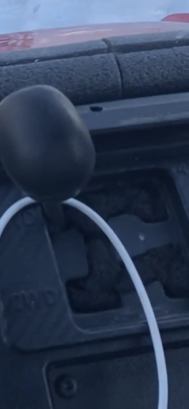

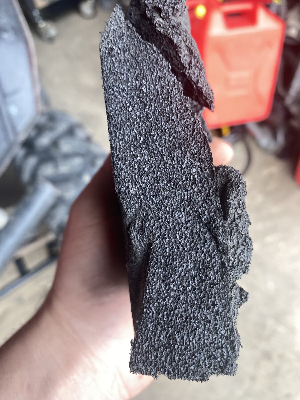

I hear you. The steering column and shifter area was the worst for air coming in. I have my column set to what what I like and I have jammed this type of closed cell soft insulation foam we use to insulate coach bus walls and front ends. Worked pretty good. I also leave the machine in 4H and cut the same insulation in the shape of the shifter and it plugs it up.
I never thought of blocking the radiator. I was mostly concerned with blocking air entry and exit. Might just have to do that this year to see how big of a difference it makes. Thanks.

Guarantee that blocking the front radiator will have huge benefits.
It’s quite simple when you think about it, when you add a heater, you’re essentially increasing the heat removal capacity of the entire system by a significant amount. You’ll need to do something to the front radiator to retain heat in the entire system and keep the system at peak efficiency. Definitely important for limiting sludge buildup in your oil due to condensation. In the summer you can use the heater as additional cooling capacity as needed.
