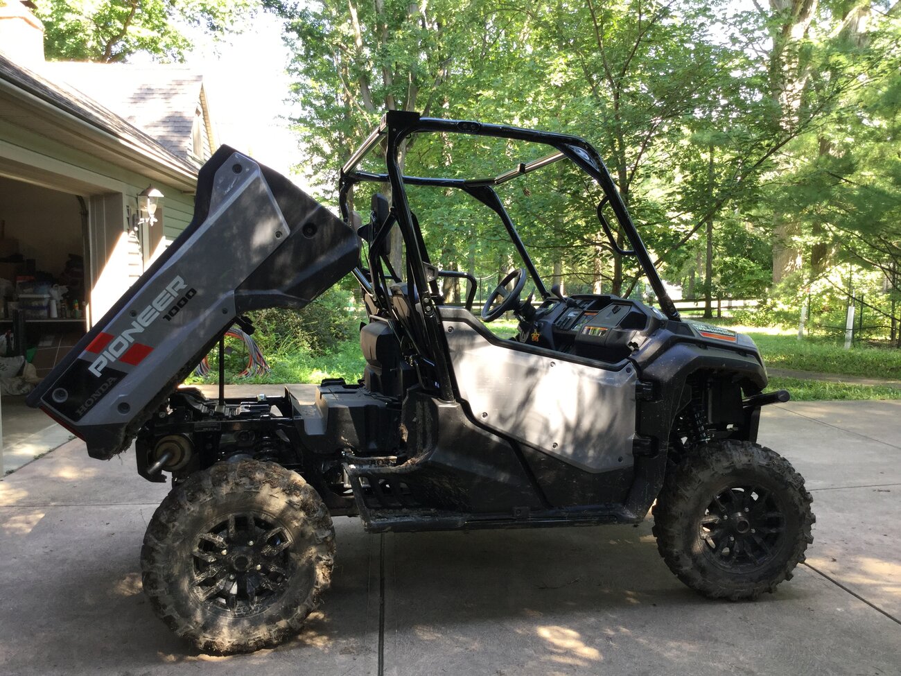

I’ve searched but I’m not finding anything. Has anyone modified the shock on the 1000 crew to get the bed to raise up higher so it’s easier to change oil and do regular maintenance etc.?
Remove the small rubber bump stops at the bed hinge and you will gain several degrees of tilt.
