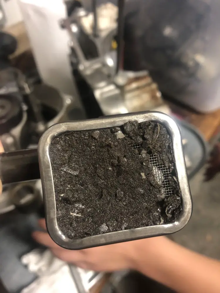

Ok thanks for the replies sorry I’m just now getting back as I’m just now getting back to working on it. I’ve got the cases split now and believe I figured some things out. In my original post I didn’t mention that I’d checked the oil pressure and it was around 60-70 pounds at idle. Well I then noticed after I already tore into it that your supposed to check it at 5000 rpm so that info I wasn’t sure about. When I pulled the cases apart the screen off the oil pump was plugged completely with clutch material. How this thing was getting any oil pressure I’d don’t know. Also I didn’t mention that it was smoking a lot and using oil so I’ve got the cylinder and head at the machine shop getting it bored and the head checked. Also one can lobe is shot possibly from lack of lube. It hasn’t been terribly long ago that we installed a new cam because of the same problem so wether the screen has been plugged for awhile who knows. Amazing enough the rod and crank look good. So I’m going to rebuild all the clutches, few bearings, a cam, top end, bunch of orings and gaskets and throw it back together. I love my Honda’s but not sure on the design on this engine. It has lasted through some hard miles though and hopefully after some refresh several more. I’m going to put the torque converter back in and see how long it will last. Also the oil pump specs ok it just has a little scoring on the cases so I’m going to roll with it.

My old DSM always told us when replacing the camshaft for a worn lobe on the 700 series enignes to split the cases and inspect/clean everything because the metal has to go somehere.
Your situation with the clogged screen is just like the Big Red i did a few months back. It would sporadically loose foward motion and feel like the clutch was slipping. I also found the screen clogged all the way up with gunk.
I didn't know any of the history of the unit, so im not sure what if anything had been done to it before I got into it.
While your in there inpsect the torque converter fiber seal and oil pump. If the converter seal is bad you'll have to replace the converter assembly, since Honda doesn't sell the seal separate. Also check the pressure relief valve to see if it's stuck.

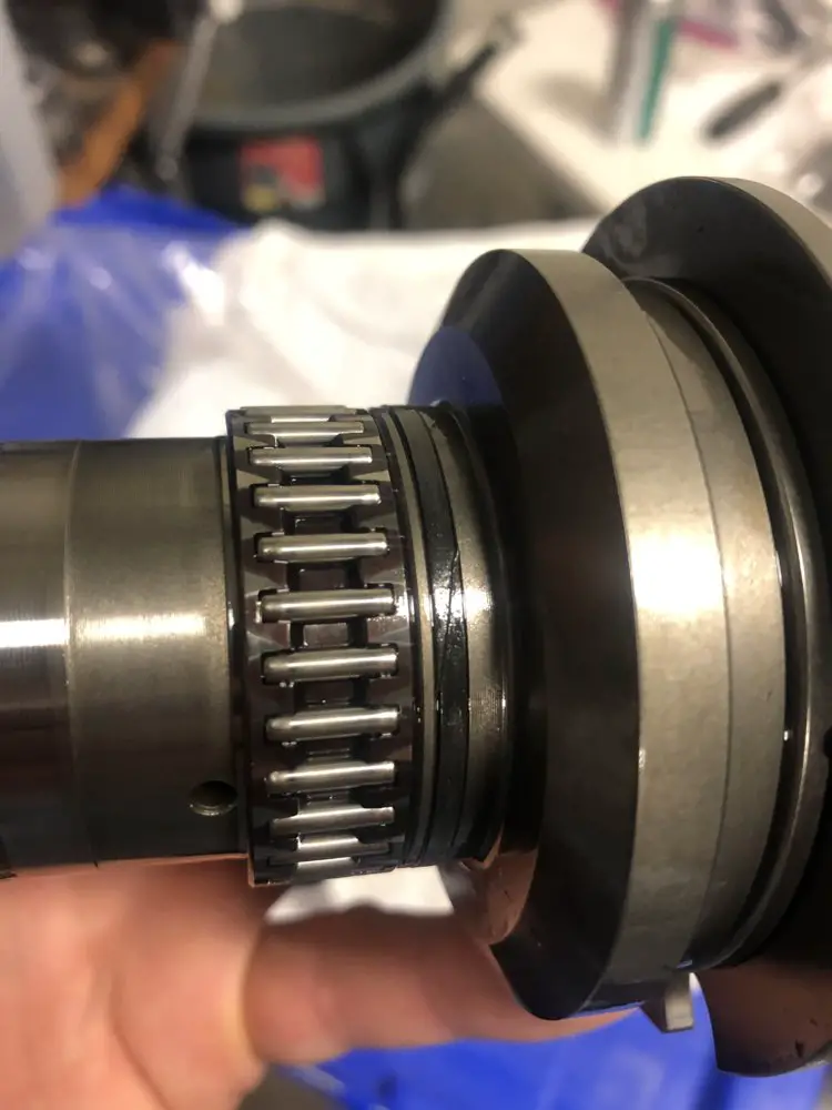

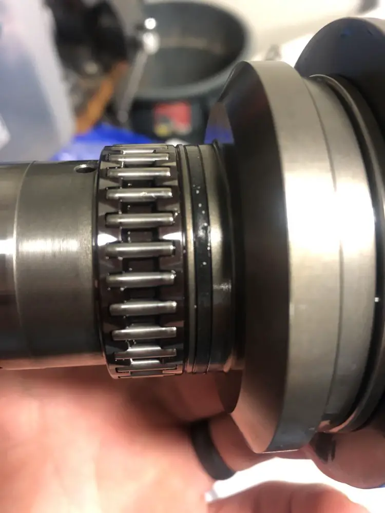

Ok here’s the seal it has metal pieces imbedded in it and is it suppose to have a slit where it can come apart?

The slit is normal, it's the same material as the P1K mainshaft seals.
I'd hate to say it, but with the metal embedded in it there I wouldn't reuse it. That could've been what led to your issues.

Unfortunately I’m not impressed with the condition of the seal or that bearing. Just a bummer you can’t service these parts individually.
