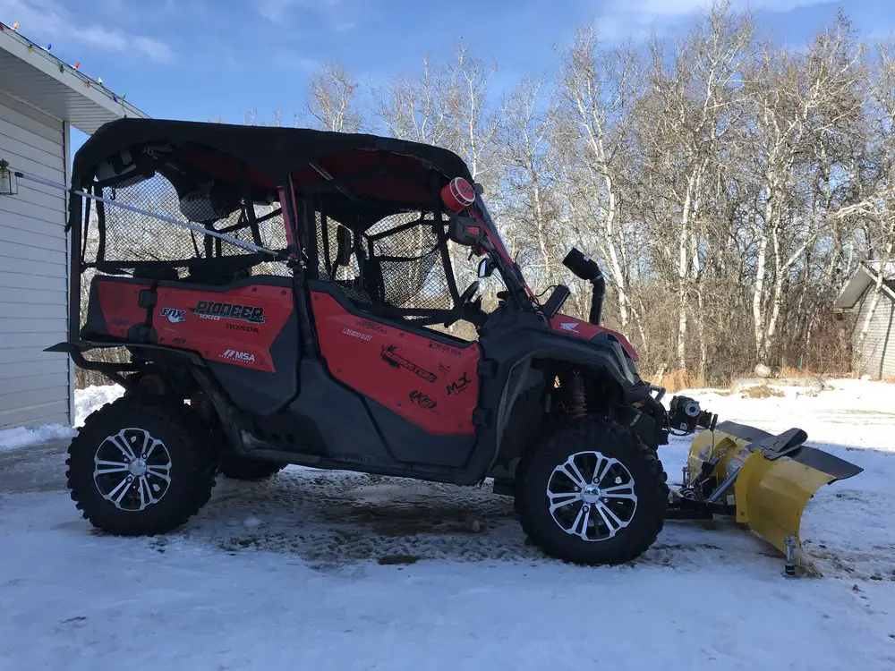

I have a question for all of you that are snorkeled, I am not so I don't really know the answer but with the snorkel tube facing to the front don't you ingest a lot more dust than facing it aft? I see the reason for front facing but we ride in a lot of very dusty places and it seems like you would have to clean the air filter after every use or 2.
Facing it to the rear is proper, IMO.
Actually...watch some dusty riding vids
Dust..is everywhere..
anyplace other than...HONDA'S
placement..is an improvement
mines for the kool factor...which
half of accessories. ..are
manual reads..very dusty conditions
every 10 hrs

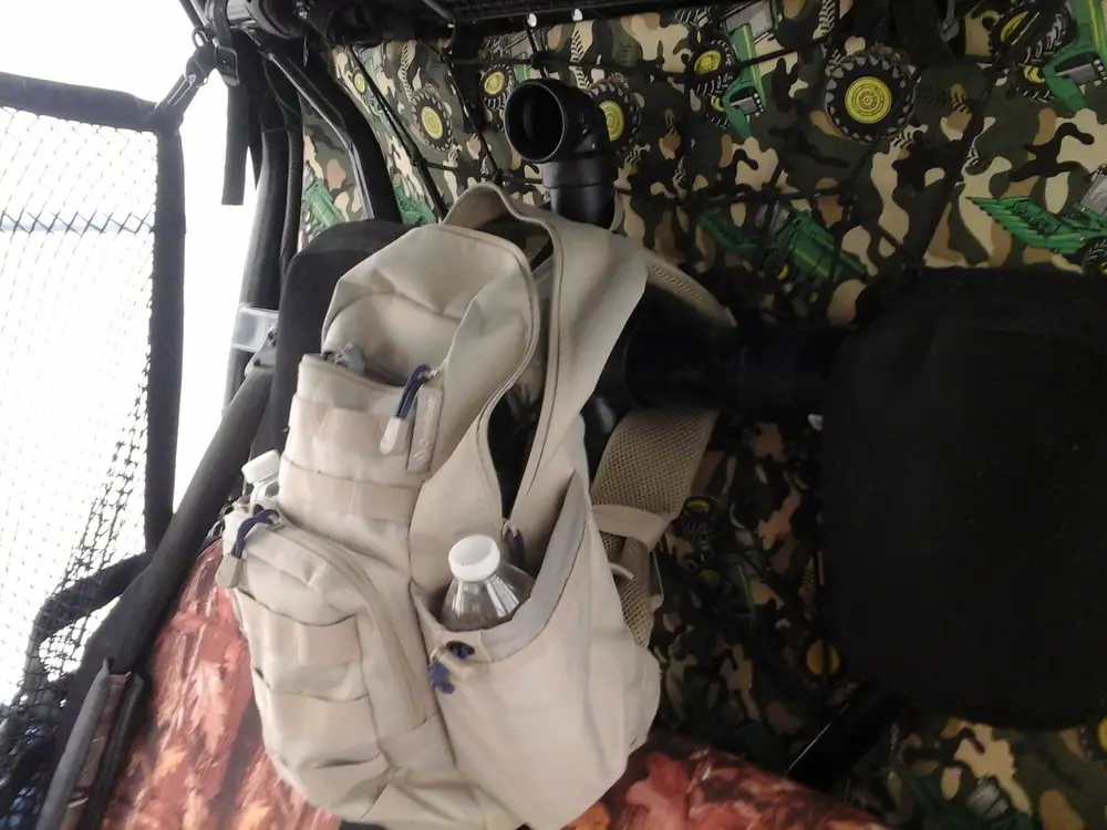

My real air..comes from inside
cab... 20180311 120041

Yours is in the cab so you may not have the dust problem, might be loud though.
I got tunes....
intake...4"
From soundbar...
Soundbar wins...
cab...View attachment 68470

I'm not ripping on your mod! Alan asked the question 'if building a snorkel should you face it forward or rear'. I said rear in my opinion, that was all. o_O
I would like to think rear facing is more ideal as well. Its not forcing air in from the dust cloud in front if you are not the leader. And theoretically if its placed right i would think airflow over the machine would help keep the actual intake air out of the dirty airstream.. but what do i know, im no scientist.o_O
It's all good..

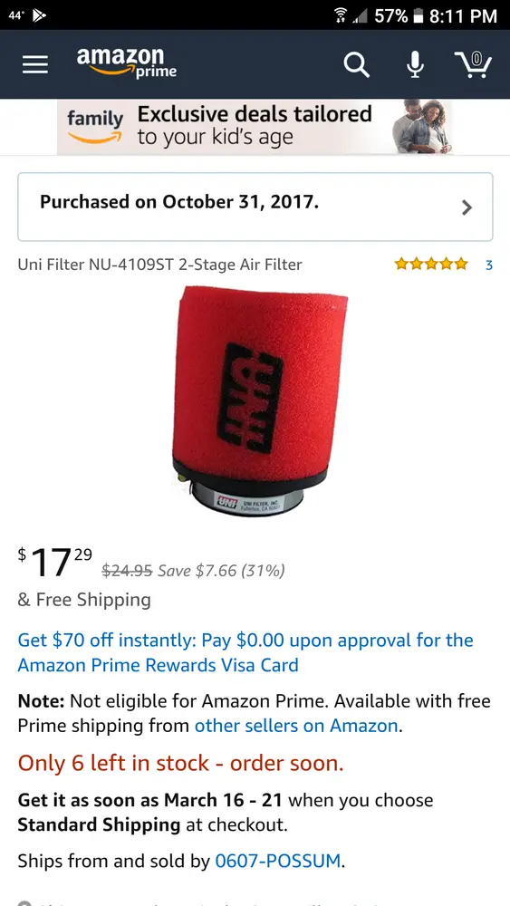

I used one of these on my snokel as a prefilter. It helps alot and fits perfect on 2" pvc.
Agree with @GlockMeister ! I run the K&N as a prefilter and clean it after every dusty ride and it has payed for itself in extending factory filter replacement requirement and is easy to access!;)
Now for the comment on the Red glow from the pipe...Bad Ass! Looks cool as hell with the upper green lights! One of a kind look! Are your LEDs waterproof for riding in the rain @rocmar o_O
Thanks. ..
...yes they are waterproof
great idea...for the pre filter
from Glock....
