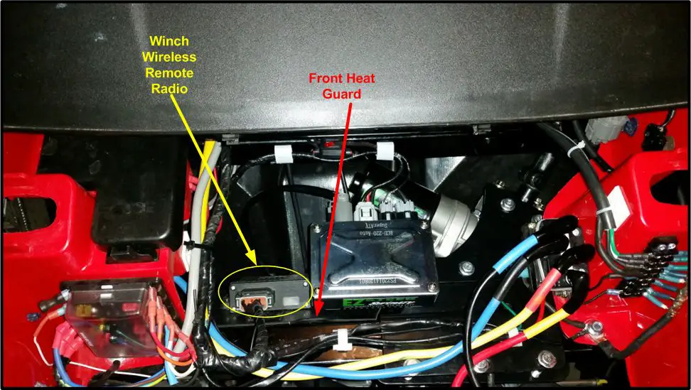

I finished my install this weekend. I didn't have any problem without removing the Dash or C-clip. My P700 has a front heat guard that needed to be modified, which was not in the installation instructions. It worked out well, because I had to relocate some of the winch components and was able to use the modified heat guard to hold the winch wireless remote radio.
I am so happy how well the power steering works. It is very noticeable in 4WD Diff Lock. Can't wait to get off-road!

32,051
I am so happy how well the power steering works. It is very noticeable in 4WD Diff Lock. Can't wait to get off-road!View attachment 4872
You'll enjoy the EPS immensely, I forget it's in 4Lock after going through deep holes. Never forgot without the EPS.
