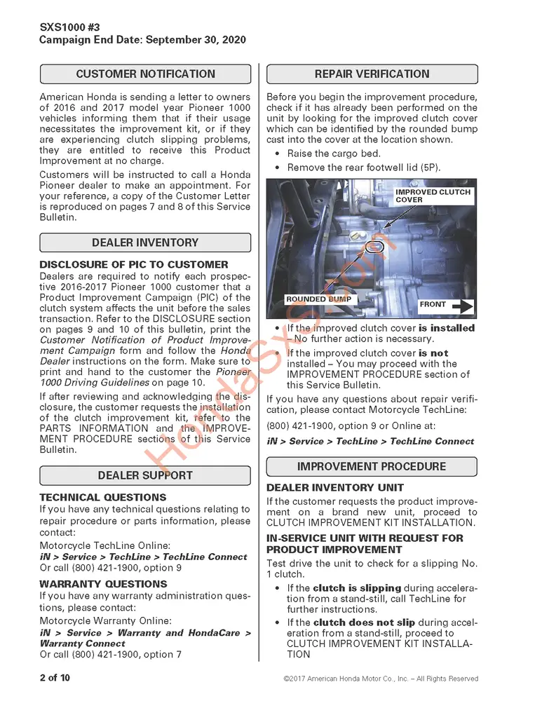

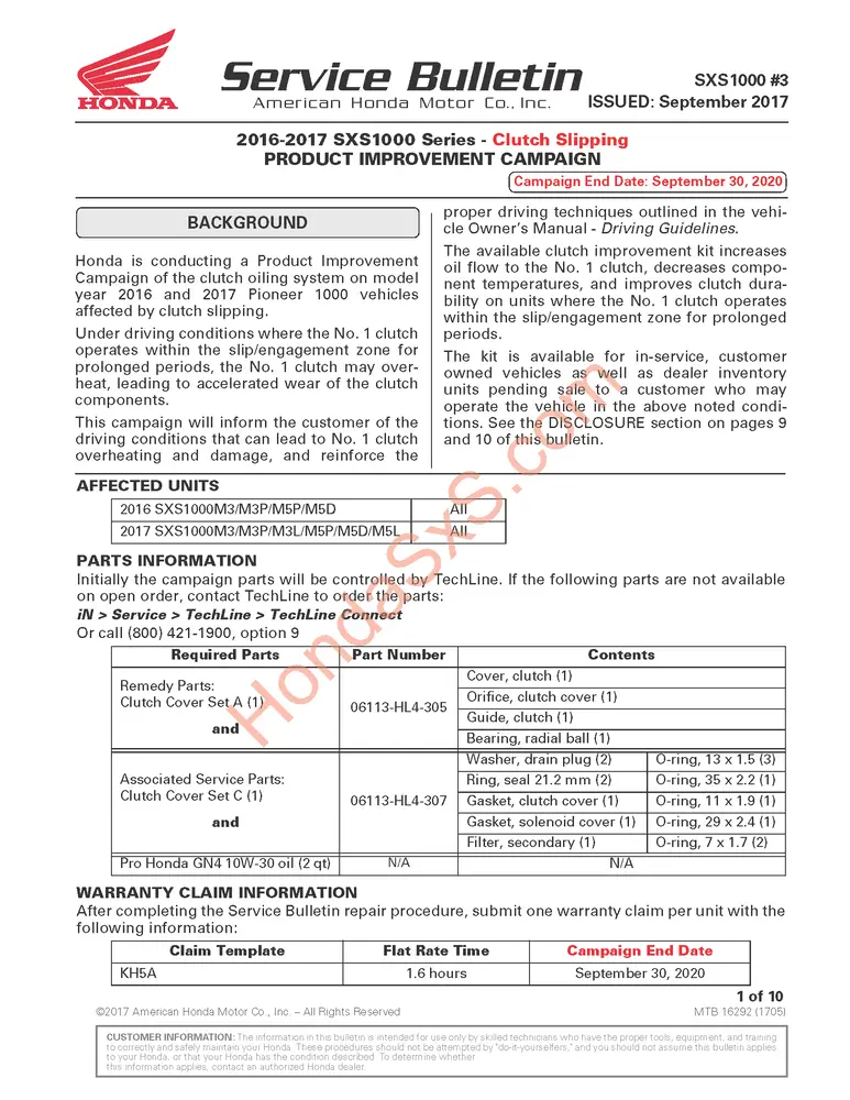

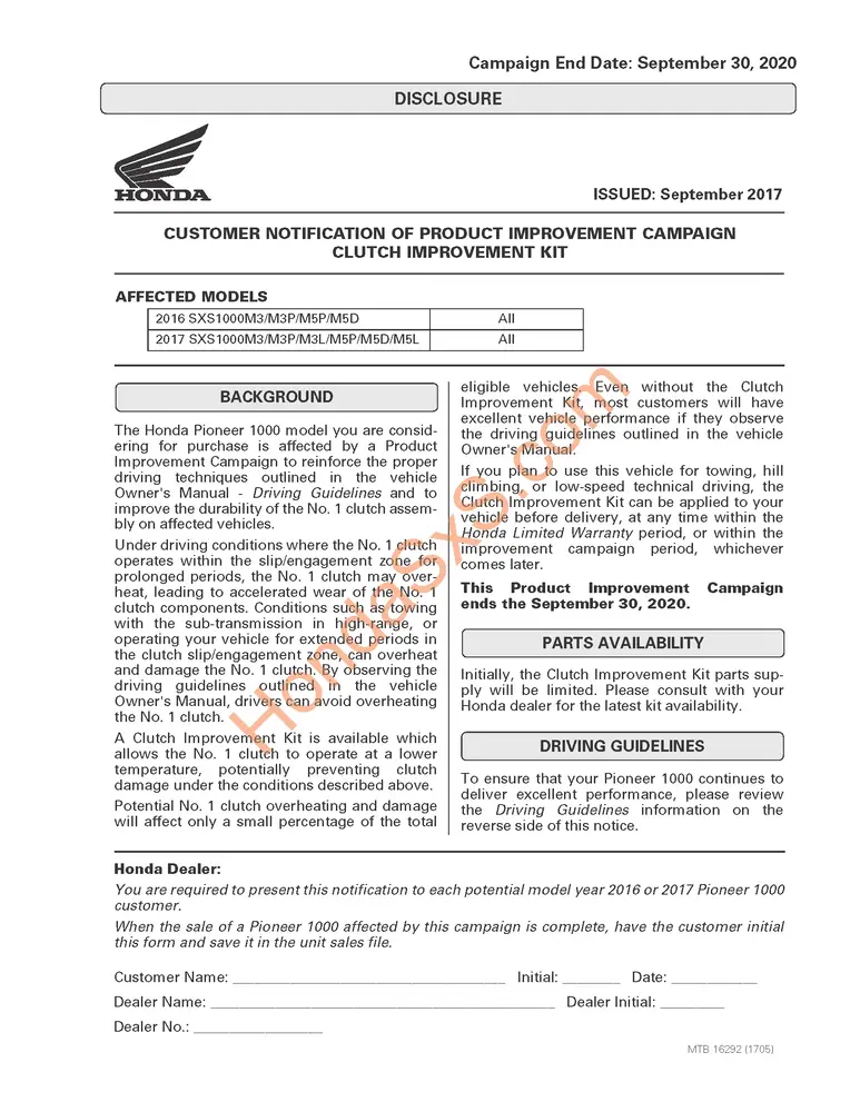

ITS OFFICIAL.
Honda has finally released the UPDATE CAMPAIGN set to fix all the issues many of us have been having with the clutches.
Who is eligible for this update?
  • ALL 2016 Pioneer 1000's are eligible.
  • ALL 2017 Pioneer 1000's are eligible.
  • 2018's are expected to come with this pre-installed.
This "UPDATE", alters the oil flow to clutch 1 delivering cooler oil in an effort to keep it from overheating. This will help prolong the life of the clutch and help eliminate the chatter you receive.
It is also important to note that this "update" will not fix user abuse or error. Please continue to follow directions found in your user manual for operating the Pioneer 1000 DCT system.
View attachment 53928 View attachment 53929 View attachment 53920 View attachment 53921 View attachment 53922 View attachment 53923 View attachment 53924 View attachment 53925 View attachment 53926
Also, Here is a PDF version just in case you need the "letter".

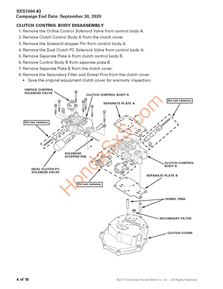

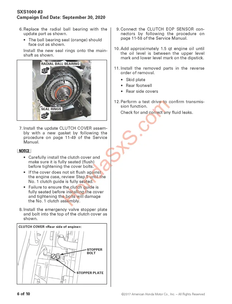

Update on my low oil pressure light that resulted from my Clutch Recall update.
On page 4 of the service bulletin, the picture details the "Orifice Control Solenoid Valve" which should include an O-RIng where it plugs into the "Clutch Control Body". The kit my dealer received did NOT include the O-Ring so it was not installed. The dealer ordered a new kit which DID include the required O-Ring. They put the new kit into our P1k last Friday and so far no low oil pressure lights.
Please pass this information on as needed!
