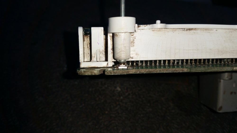

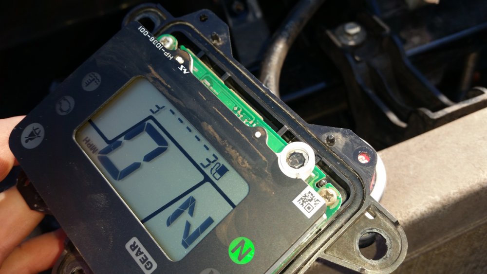

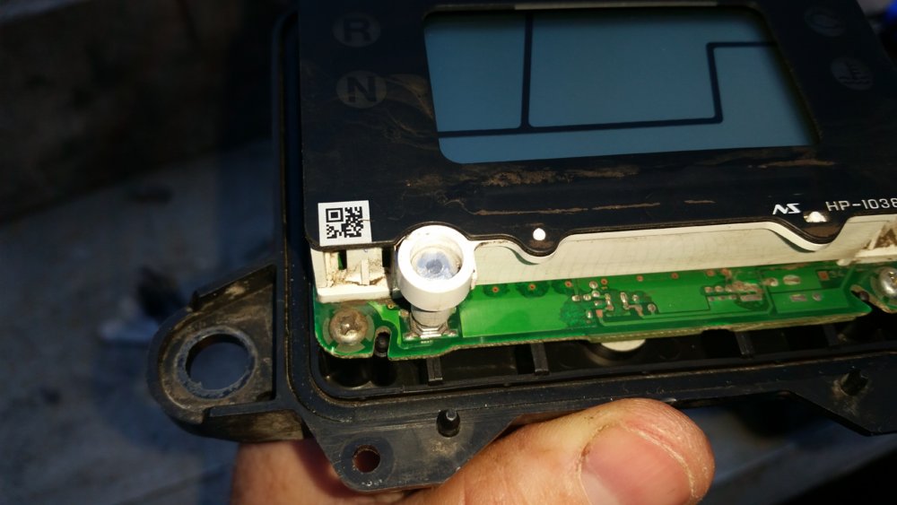

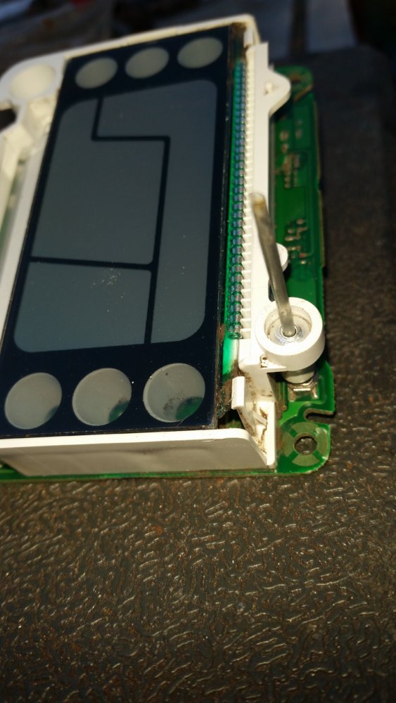

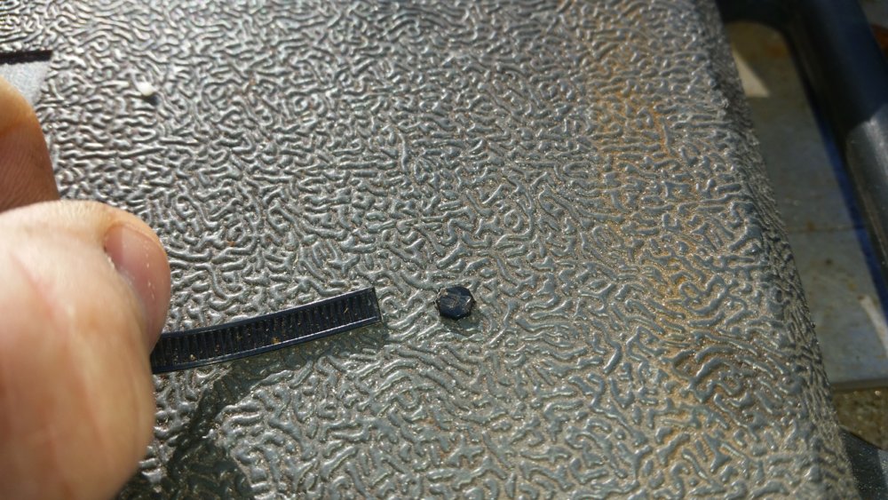

Ok digital dash update. Its fixed!! I ended up using a 1/8" rivet lol. I would have rather used something plastic but i couldnt find anything. The rivet actually has a rounded head on it for when you rivet something the rounded head pulls through the rivet barrel making it flare out. I plugged the circuit board to the wiring harness and started my p5 and pressed the rivet, it pushed the button just fine dead center. The rivet body and head actually center it perfectly in the little hole that the plunger is suppossed to go in. I cut the rivet shank down a little at a time trying the face plate cover on each time. In the end i actually ended up cutting the rivet shank flush with the head. I put the faceplate on and pressed the button and i could hear the button on the circuit board clicking so i figured i had it fixed. I plugged it in, fired it up, pressed the rubber button, no dice! It wouldnt go through the screens like it should. I took the faceplate back off and pressed just the rivet head, it went through all the screens again. So i figured i need a shim. I tried a few different things like electrical butt connectors that i cut a few slivers off of. They seemed to work before i put it together, but when i put it together it wouldnt work. Believe it or not what i ended up using was a piece cut out from a zip tie lol. I cut a little square out of a zip tie and nipped the 4 corners off a bit to kinda make it 8 sided, or a little more rounded i guess. I put it on top of the rivet head and put the face plate on and it worked! I screwed the digital dash back together and it still worked, then installed it in the dash and it still worked lol. So im calling it fixed. The little piece of zip tie cant fall out of the hole because when you screw the face plate back on the little rubber button on the front glass sticks down in the hole a bit and sandwiches the piece of zip tie between it and the rivet head. So all i neee to do is when i get some silicon to finish my snorkel i will take the guage back apart and dielectric grease the harness and seal the seams and the harness with silicon along with my snorkel. So if theres anybody else out there that takes their dash apart and loses the little plunger thingy like i did, now you know you can use a 1/8" rivet and a zip tie to fix it lol. Heres a few pics. Hope yall like.
