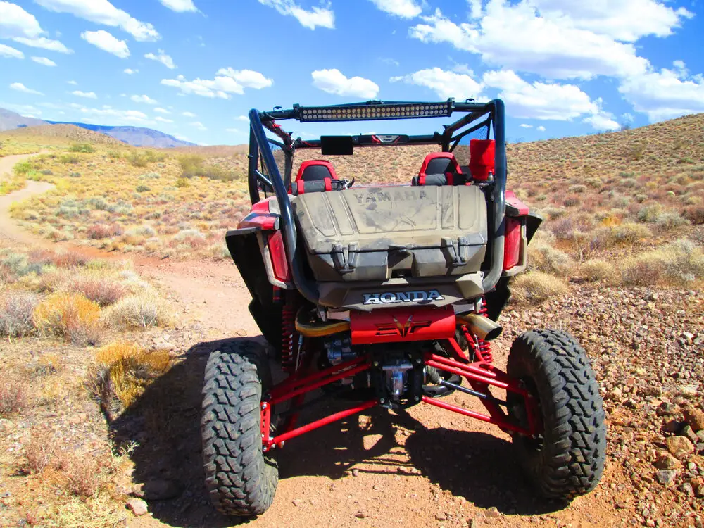

Just wanted to share this with the community. Idea I had to mount some reverse/backup lights. Had a hard time trying to figure out where and how to mount some cube lights from Super ATV. Basically I took a piece of stainless steel and cut it about 10 inches. Took a smaller square and and placed it on top of metal bracket holding the roof and bolted them together. Drilled 1 hole on each side for the stud to mount to and ran my wires.

I used the seat belt mounting holes in the roll bar. They angle outwards slightly and I find they put the light right where I need it most when backing.
