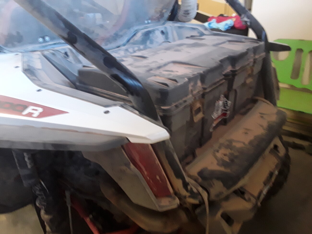

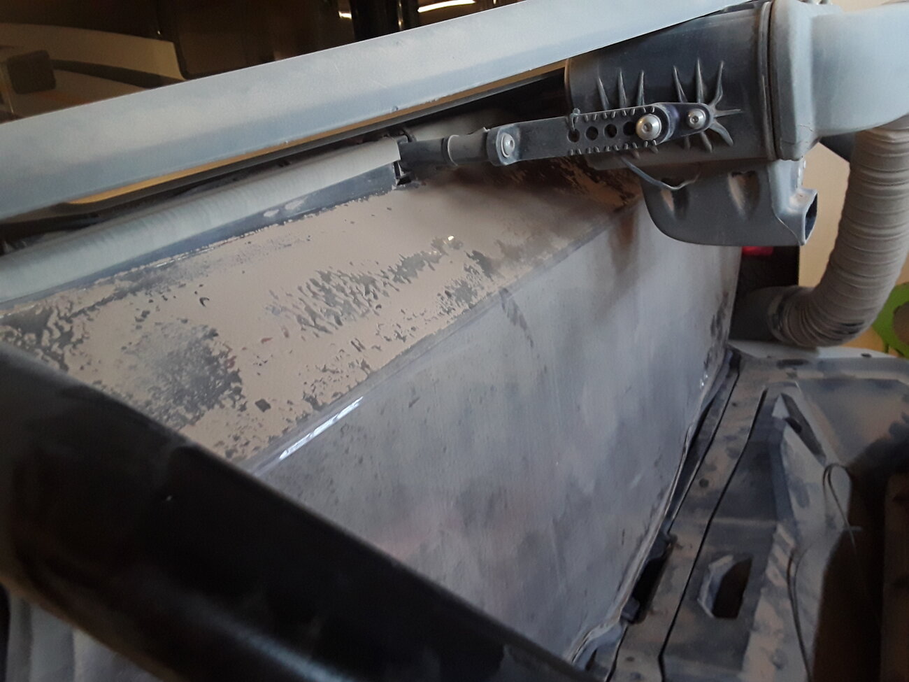

Rear window causes me a problem, everything is a compromise. Looks like your setup works real well
Same setup i've got, i don't share the opinion of the many who say if you do the relocate or s&b your air filter will last forever. I think the rear window sucks a lot of dirt right into the intake and overwhelms the s&b. I get about 3500 miles before the filter minder gets to the halfway point. Wife wanted to go for a relatively short 100 mile ride, i washed the machine before that ride. As always your mileage may vary but i wouldn't recommend ignoring air filter checks.

No, I don't. My first filter check was at 1066, the stock filter was spotless. My next check was at 25xx and it was still spotless. On that check, I was in a hurry and the airbox cover was dirty, I didn't want to remove the storage box and I had to lean over between the seats to remove the cover. Doing so, I bumped the cover against the body which dropped dust around the intake air horns, that made me think that I had an airbox leak. After checking everything over and realizing what had happened, I swore to never remove the cover without hosing off the entire area. Like many others, causing myself unnecessary problems by being in a rush.
