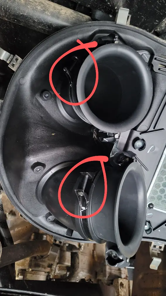

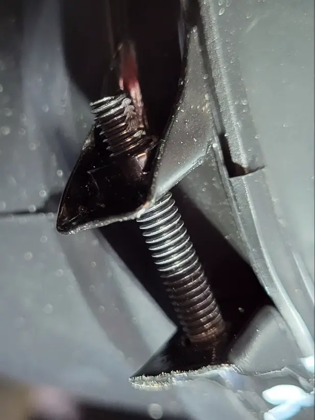

I heard about this happening a few weeks ago. I just pulled my air box off last weekend and snugged them down with a dab of blue loctite just to be safe. Only takes a few minutes to get in there and do that.
18,697
68,420
From what I understand.
Here are the 2 bolts to check. In this pic you can see it is fairly far out. Second pic is tight and the threads deformed to prevent it from falling out if it comes loose again.

Thanks for the pics. I understand the problem now. I think this was the cause of one Talon owner getting dirt into the engine and having to replace the entire engine (honda warranty and dealership paid the costs). Soooo, should we Loctite Blue these bolts after tightening just to make sure?? What do you think?
18,697
68,420
Lock tight won't hurt.
Make sure you use something to pinch the threads flat as close as you can to the nut.
This issue would not have caused any dirt to enter. It's a internal part inside the air box.
Really, I'm not even sure it's purpose.

Checked my vin and my machine was in the recall. I’m snowbirding in Arizona for a couple months and go on rides at least once a week so this morning I thought I should check those clamps and I’m glad I did! Both were finger tight and about 5/8” between clamp openings. Tighten them down to about 3/8 and took a needle nose and buggered up the threads some.
