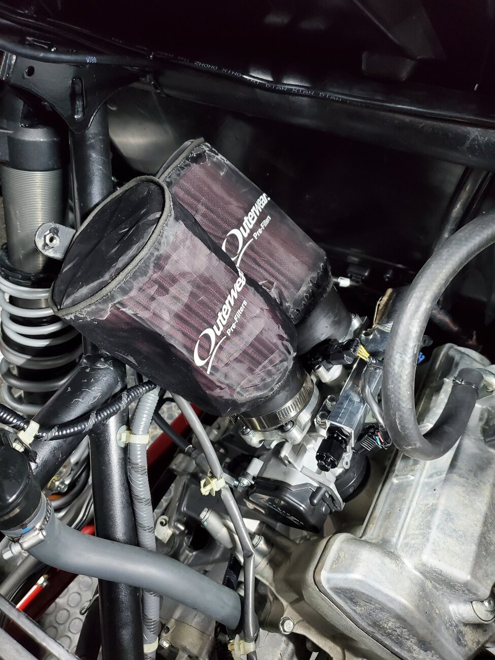

I did this to mine for the last few races of the season...
Surprisingly the filters stayed very clean even without protective shields around them. I don't ride in mud or water so your results may vary...
I like it and is what I am thinking other than I will be in some mud and water. Why I would need to make a new air box.

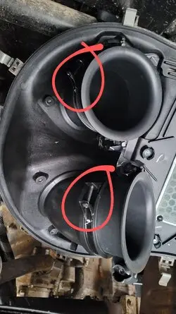

Finally got around to checking mine. Low and behold the clamp screws on the rear cylinder had backed out to around 14mm and was loose. I decided to loctite them with blue loctite and burr up the threads just to make sure they are staying put.
It's too bad I had to pull the air filter with only around 650 Miles on it but want all new gaskets after the repair. I also grease up my gaskets before installing them and my air box was clean as a whistle.

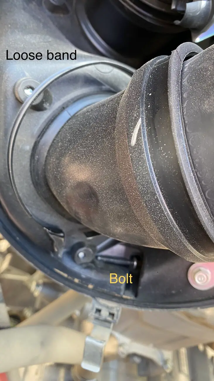

Checked my Talon (is in the VIN recall), the bottom bolt was sitting at the bottom of the airbox, just waiting to be injested. The top bolt is only tightened to about 16mm, neither bolt has the thread deformation. Had it serviced on Feb 2nd. The dealer where I bought it can't give me an estimated ETA for the parts. Called Honda at the phone number on the mailed recall notice, they referred me back to the dealer. We had planned to go to a UTV fest in Yarnell AZ April 8-10, had to cancel.
IMG 5059
IMG 5059
A few things disturb me about this.
1. You really don't need your dealer for this. Put the screw back in ( maybe add some loctite), tighten both screws, smash threads on end of screw with vice grips.
2. That looks like quite a lot of dust on the clean side of your filter. Is your filter seated correctly? Seal on lid properly installed? With a pre-filter installed, I have less dust than that on the DIRTY side after 3475 miles.
3. They are having a UTV Fest in Yarnell? OMG! That is WAY too close to my home turf!!!
Good luck.

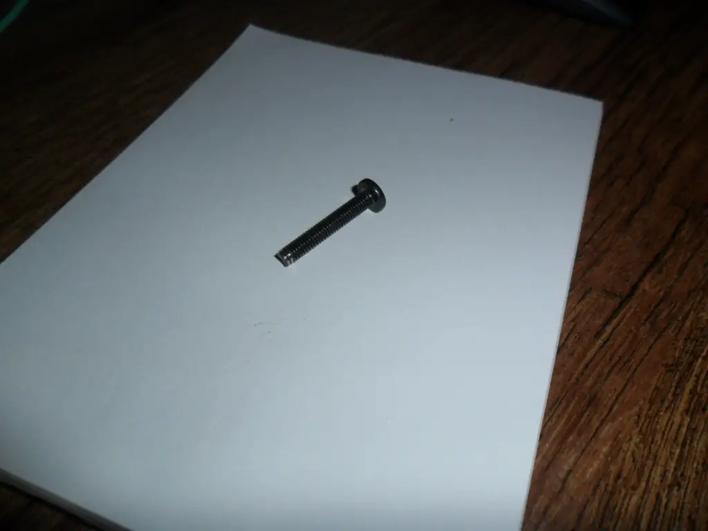

Finally got around to working on my airbox snorkel recall. One clamp was loose (open about 16mm) so I just tightened it up and mashed the threads with the vice grips. However, the other one was just about ready to fall out, so I tried to tighten it up. No go, it wouldn't budge. I tried to loosen it and it fell right out of the clamp. Upon factory assembly, it looks like the screw started to go in the clamp and then cross threaded and only about 2mm of the entire 25mm screw was in the nut holding it. If you look closely at the tip of the screw, the shiny area is the only part that was in the nut of the clamp. I ran a die down the screw and a tap through the nut (4mm screw with .7 pitch), but I couldn't get the original screw to start, so I went to the hardware and got a screw 30mm in length. This made it a whole lot easier to get it started threading in. All is well now and I will be sure to keep an eye on those clamps. Maybe some loctite is in the future.
SAM 3027
H
HondaTech
Finally got around to working on my airbox snorkel recall. One clamp was loose (open about 16mm) so I just tightened it up and mashed the threads with the vice grips. However, the other one was just about ready to fall out, so I tried to tighten it up. No go, it wouldn't budge. I tried to loosen it and it fell right out of the clamp. Upon factory assembly, it looks like the screw started to go in the clamp and then cross threaded and only about 2mm of the entire 25mm screw was in the nut holding it. If you look closely at the tip of the screw, the shiny area is the only part that was in the nut of the clamp. I ran a die down the screw and a tap through the nut (4mm screw with .7 pitch), but I couldn't get the original screw to start, so I went to the hardware and got a screw 30mm in length. This made it a whole lot easier to get it started threading in. All is well now and I will be sure to keep an eye on those clamps. Maybe some loctite is in the future.View attachment 328913
The clamps are a controlled part, but shouldn't take any longer than other parts.
