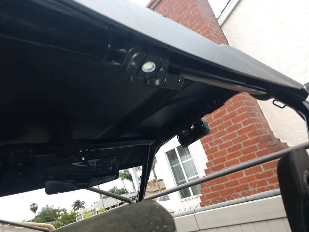

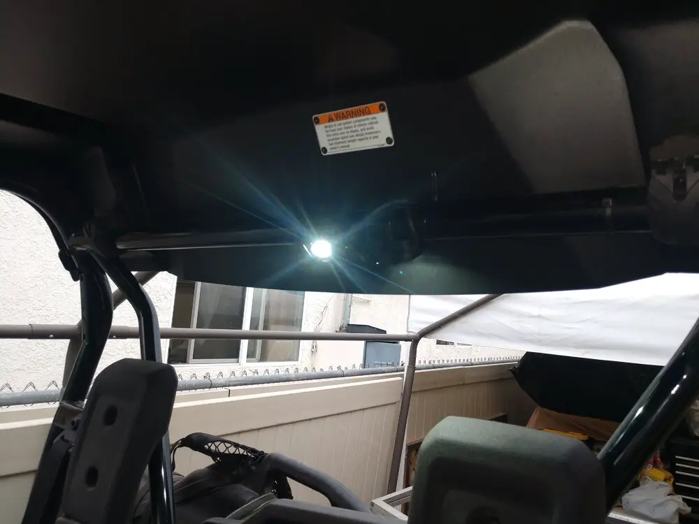

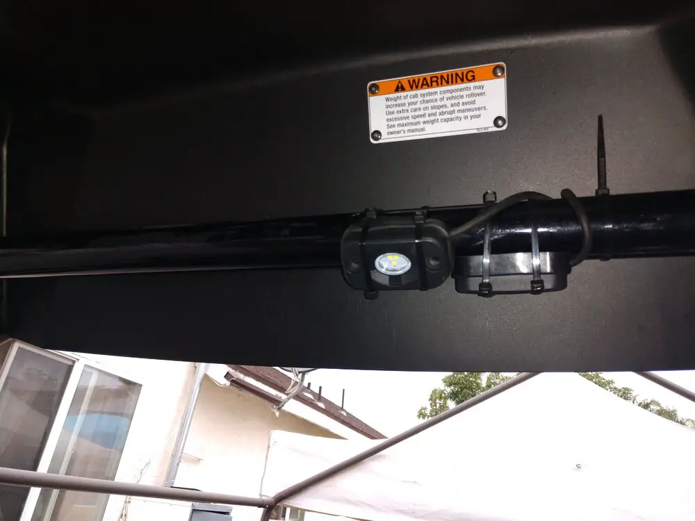

I went through a couple hours of frustration yesterday on just this problem. I am running a pair of 4.4 watt 320 lumen lights as a dome light/bed light. Only two lights on that switch. Couldn't figure out for the life of me why they would run for less than a minute and not work again. THEN, I remembered I did not put in a relay (new to these LED lights). Doh! Relay, new switch to replace burnt out one, and all is great 👍
Not great pictures, but it gives you an idea of how little they are and still burnt out the rocker switch.
