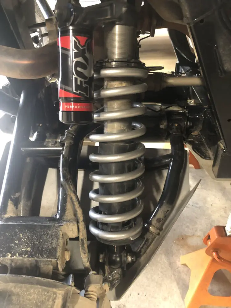

Installed my front springs tonight. Not too bad of an instillation. Had to re learn my brain for my ratchet spring compression lol. It looks good. Kinda liking the silver.

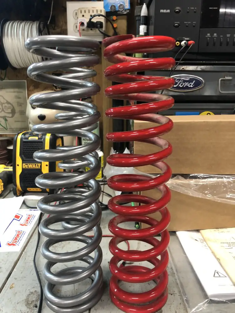

You can see the stock fox spring on the right and the upgrade on the left. The fox aping has a bit more compression at the top meaning a bit stiffer.

What kind of distance you showing from the black believe I have mine set at 2”
Sorry I was Finishing up the rear springs.
Did you mean spring load? I’m at 2” in the rear and the same in the front if that’s what your asking.
I’m going riding this weekend so will see if I need to adjust the fronts more. Also is I need to adjust my toe in or out.

Yep, that is what I was wondering. I am 2” in the back and I think 2.25” in the front (need to verify)

@GlockMeister told me 2” in the back and 2-3/4 in n the front. For some reason I was thinkin 2” in the front and while changing the rears today I thought...chit!!! That was 2-3/4” in the front. Oh well. I’ll try it like that this weekend and see how it feels.

2.25 front and 2 rear us what im set at. Looks good bud.

First of we had a great day with @tr005 and the wife’s on a long 79 mile ride on some good old Michigan trails. Lots of sand, washboards, mud and hills. We averaged about 25-28 mph. I’m must say I seen a Marked difference in the ride with the new springs. The washboards were much more managed and didn’t beat up my ribs as bad as usual. I ride on medium setting. Overall I’m quite happy with the new springs.

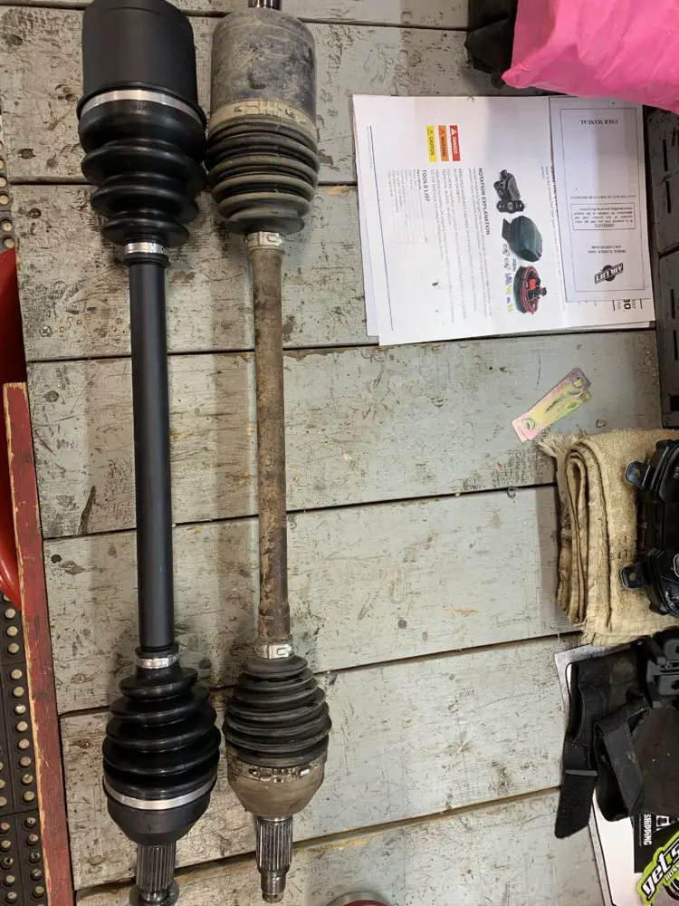

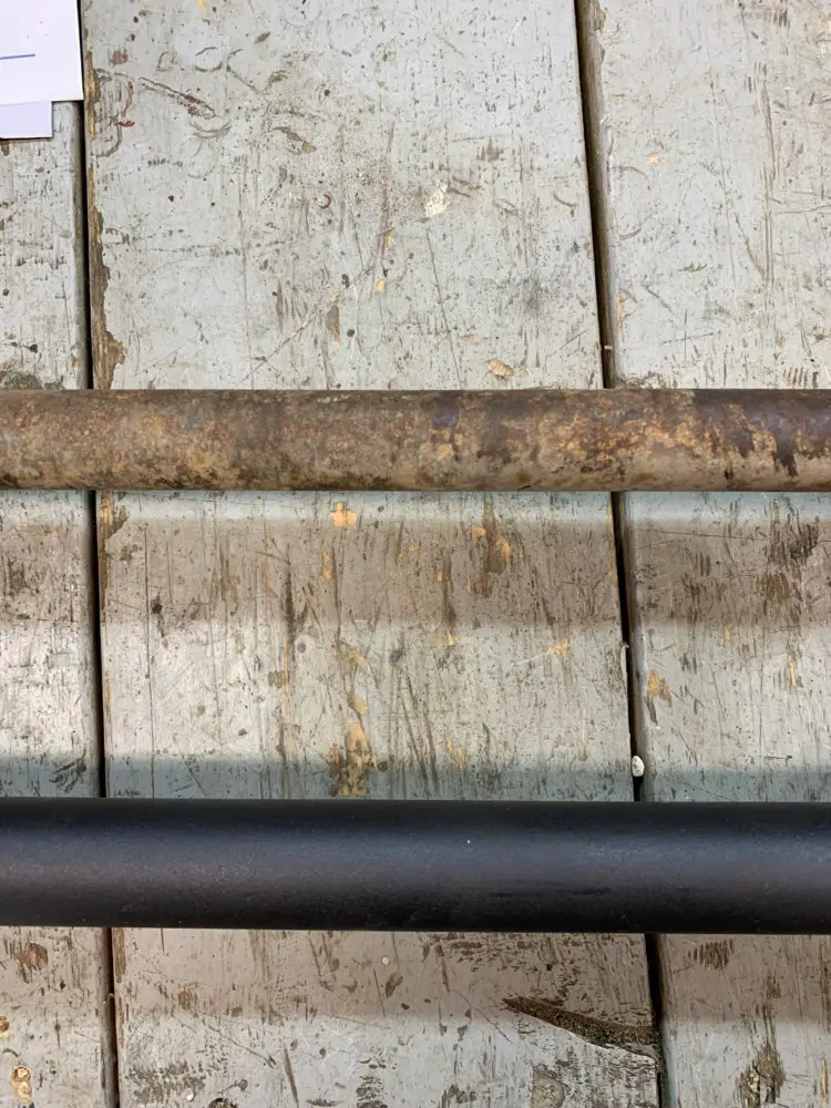

Well..had a popping in my left front axle started a while back. So I ordered som 8balls front axels. I have one front axle that’s good so I’m keeping that for a spare. While I was in there tonight I found that the boot on my left front tie rod was bad so got one of them coming as well.
