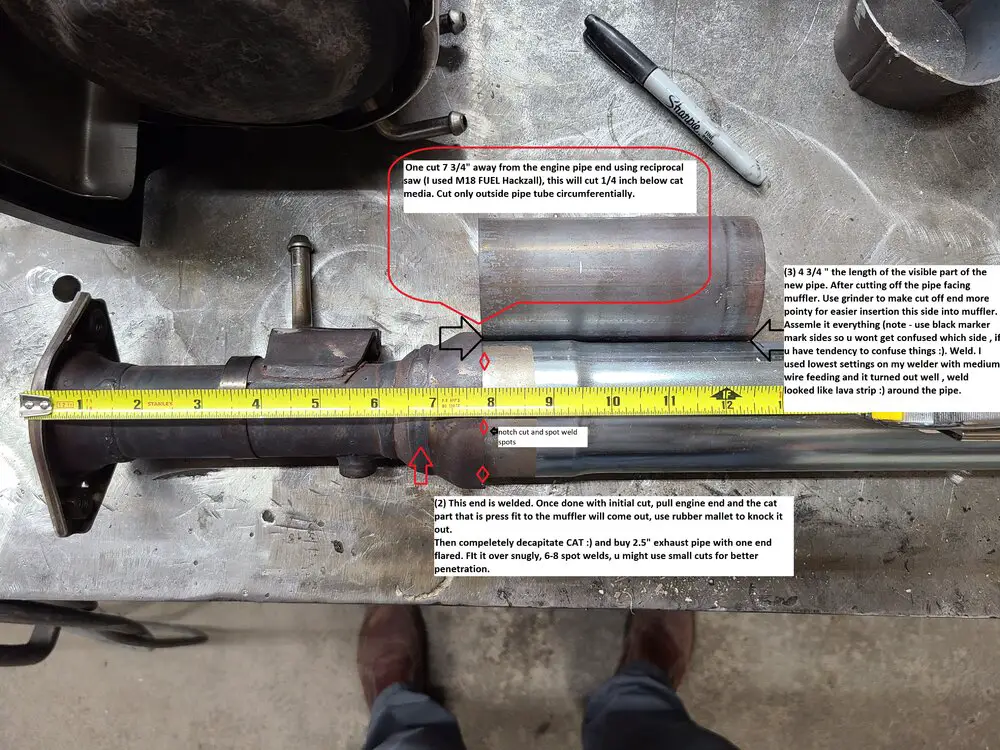

Just finished my CAT removal, and found I think simpler way to do it by exactly one less cut of the exhaust pipe and one less weld too.
I love it , way more heat reduction then I thought , I had also engine plastic cover off, and did not feel so much heat flow like with CAT .
DONT bother with cold rod knocking out way or/and drilling out CAT, way too labor intensive with poor results. And now with less welds and cuts on your outside pipe muffler it makes it more easier and less frustrating to achieve.

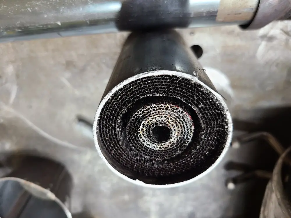

As you can see I tried to drill out but CAT is at least 4 in long.
View attachment 273519 View attachment 273520

Yeah after I did mine I realized you only needed to make one single cut and you could pull the whole cat out of the "muffler" portion. Great add to the post 😎
Would be great if you would update your post with that observation , the 8ball929 would save some time of frustration with that second pass weld :), I almost followed your post but once placed it under cutting blade, and then it HIT me :)
If you have PLEASE edit your fist post and correct it, so no one would make that mistake.

Yes all works normal. No pics, Dezrik described what to do with extra unnecessary step (cutting twice , no need to cut above CAT just only at the side that faces engine and its 7 3/4 " precisely. If you decide to do it , pm me with your cell and I can guide you. Just find someone to weld or practice on the leftover pipe and cat to weld them together, I adjusted V and wire speed on dummy before welding muffler.
The original post can't be edited as there is a editing time window enabled within the forum
