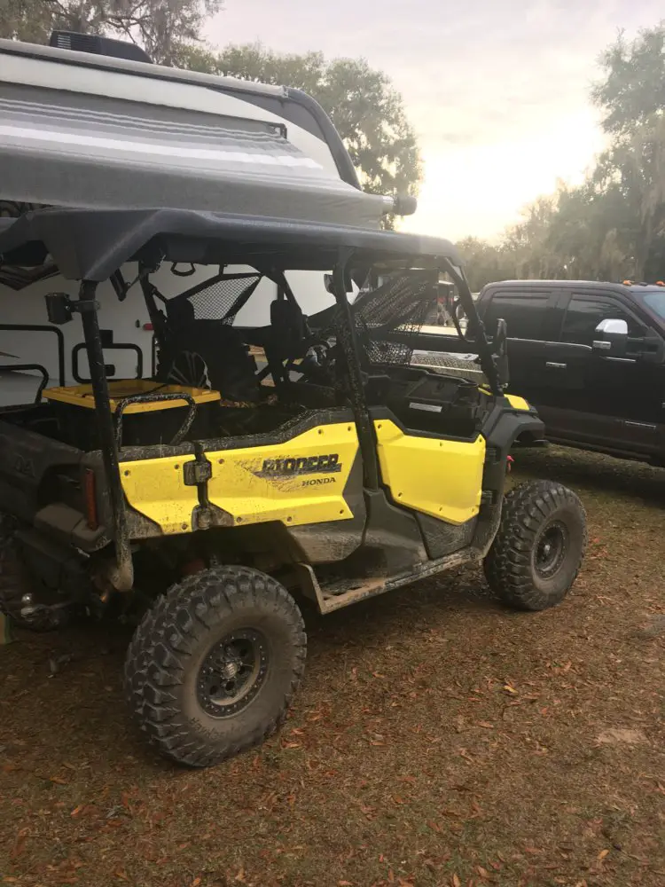

I need to purchase new wheels and tires and I am torn! I rode in a buddies 1000 that had 14" wheels and 28" terrabites. The ride seem rougher than mine with 12" wheels and 27" stockers. I guess my question is: Should I get 12" wheels and 28" evos or 14 wheels and 28" terrabites. I am really looking to improve my offroad grip while maintaining my ride quality. Trying to keep a lightish tire to maintain power as well. Very little rock crawling or mudding, mainly just covering ground on dirt roads and trails to get to hunting spots. I have also gone thru many members pictures and it seems about half have beadlocks. Again, I am just torn between getting them or not. Some opinions will help me pull the trigger.
My ride is 1000-5 stock with Fox shocks.

12 28's here and couldn't be happier, although I have nothing to compare it to as this is my first sxs. I did a bunch of reading on this site and a lot of the group likes the 12's so I went with them and like it.

Same setup as I have. I went from 14s to 12s.
Those berserkers look nice, but too expensive now that they do not offer discounts. I am so torn between the 2 tires that I may just flip a quarter. My biggest concern is really trying to avoid making the ride quality any stiffer than what it is.
When I got mine, they were NOT on sale, but I kept talking to them and finally got them discounted and shipped free.

LOL!! I meant 28x10-12's. Went on nice and easy with a rear 1" spacer. Gonna run them at 14 PSI for a while and see how I like it and maybe lower it down to 10-12PSI in the future.

You probably will not like 14psi. I inadvertently had my Berserkers set at 18psi at Mulberry. It nearly beat me to death. Got them lowered to 8psi and made a world of difference.
14 is entirely too much in the berserker. 8-10psi is about perfect. I like 8 myself.

As usual, you guys were right. Took it for a pretty good run today. Ran 14 psi on the way in and 10 on the way out. Amazing the difference. I might go down as low as 8, but 10 felt pretty good.
8 is the sweet spot for them.. you just have to keep a closer eye on them. Temperature and elevation changes will make a big difference.
