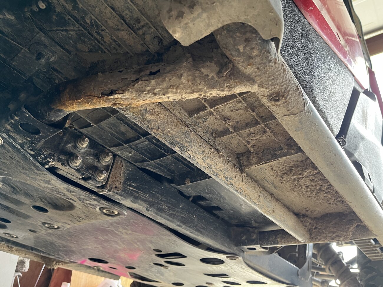

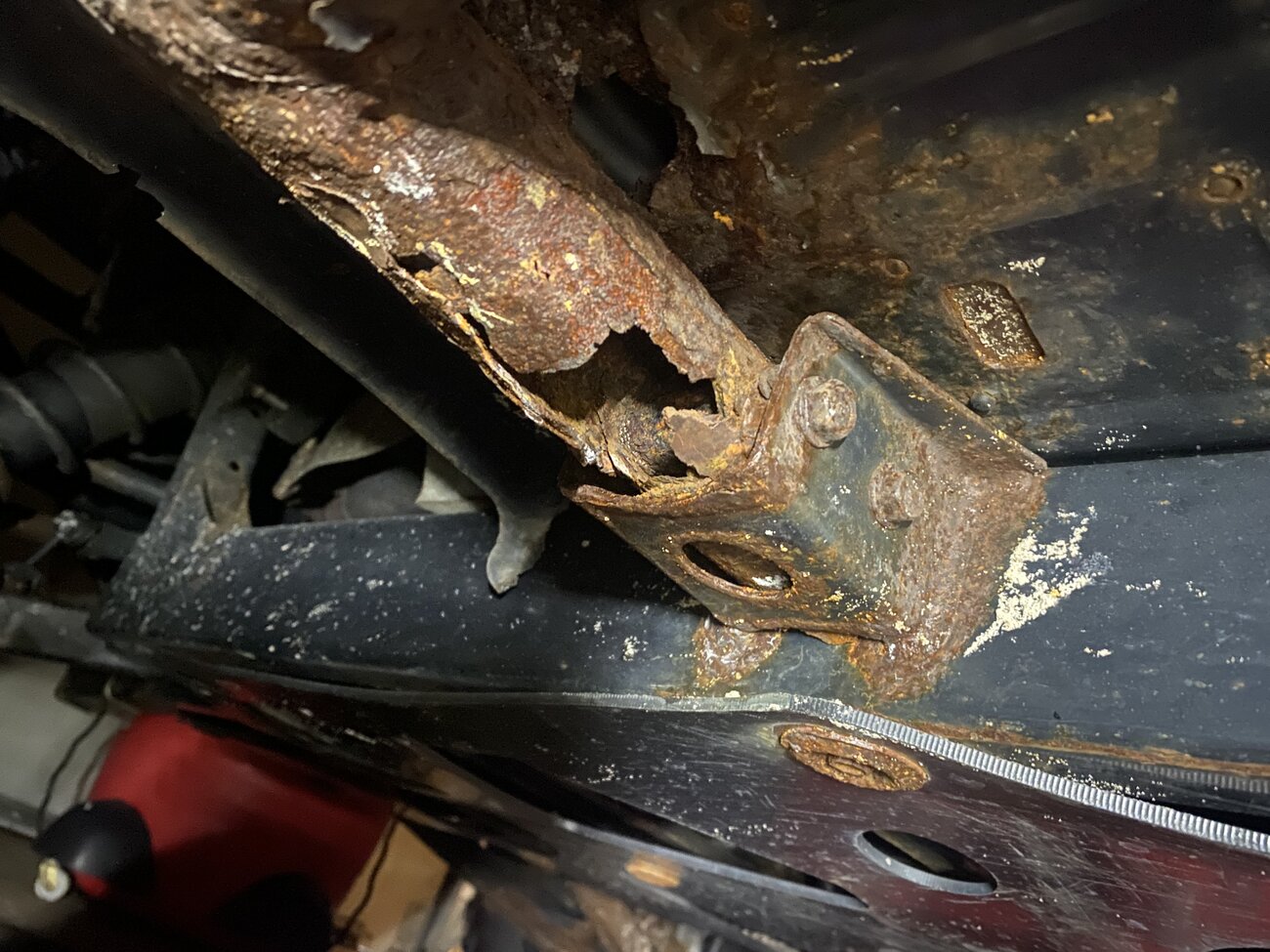

Side Rails 1 Side Rails2 Side Rails 3

These are underside pictures of my side rails for a 2016 Pioneer 1000-5 - they are nearly completely rotted / rusted through both sides are nearly identical - i garage keep this thing and drive on town roads and beach here in Dune Acres along Lake Michigan - this is quite surprising - welding looks out of the question - new rails for each side are not cheap - hoping this is not an indication of further problems with the frame - which looks ok for now - but this is quite concerning - I suggest others inspect their rails and try to ensure you work against any rust areas you start to see - I didn't really notice this until part of the rail literally fell away - any ideas? Honda - upgrade you frame materials would be nice....!!!
20,157
115,291
Welcome fellow michigander!
Looked up Dune Acres its not listed in Google maps🤔 must be a community?
At any rate, Id fix my Avitar location to just Michigan so your not asked this question every time you post.😉
So u say its garage kept. Thats good. But what are you driving in? You just said
“Dune Acres along Lake Mi”
Do u plow snow/ride in Dune acres in the winter on our beautiful salted roads? Cuz it looks like your not getting that undercarriage clean enough and when it sets the salt or whatever is eating at it cuz thats pretty bad for just a light cruiser and we have some narly machines in this group that have been to hell and back/ beat to hell and the AL and GA red clay that his known for corrosion and we haven't seen it this bad. Something out of the box has happened here. Did u also scrape the bottom with rocks so the paint was removed? That would accelerate the corrosion. On that subject, riding the beaches with sand like sandblasting the undercarriage will cause you to loose paint as well.
We just need some more through explanation of the full environment its in and how its cleaned when its stored. This is not to criticize or demean you we’re just trying to get to the bottom of this. Some things aren’t adding up.
Also noticed you still have the factory
G string skids, that aint helping your campaign either no matter what your driving in. Also the rott looks right where the tires are always splashing muck! Not good either.
Are you the first owner as well?
