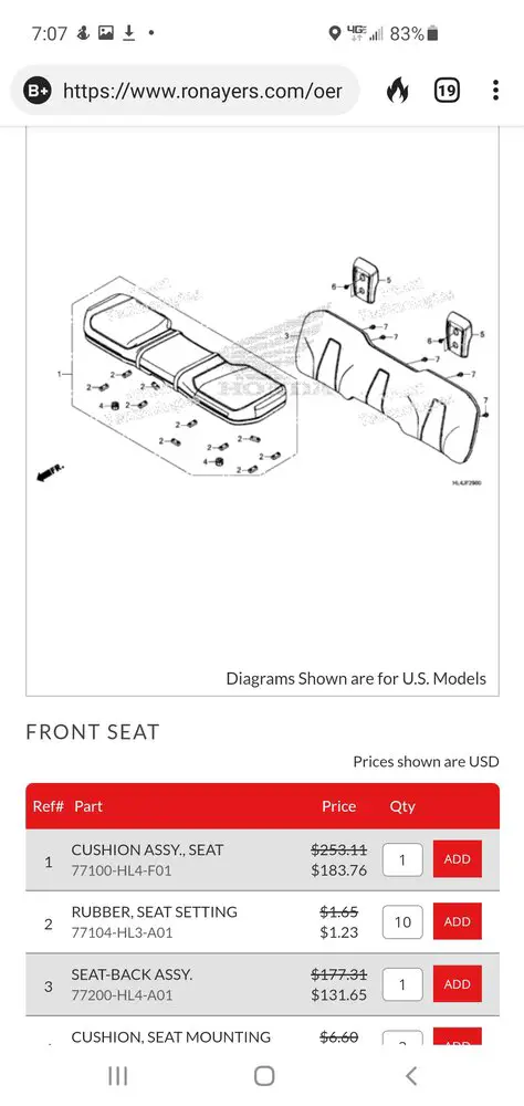

Screenshot 20210410 070724 DuckDuckGo
you can get a new seat bottom for less than $200. They changed the seat in 2018. Maybe changed it on the 17s but idk. Its thicker and I don't think they hold water as bad but I could be wrong.
