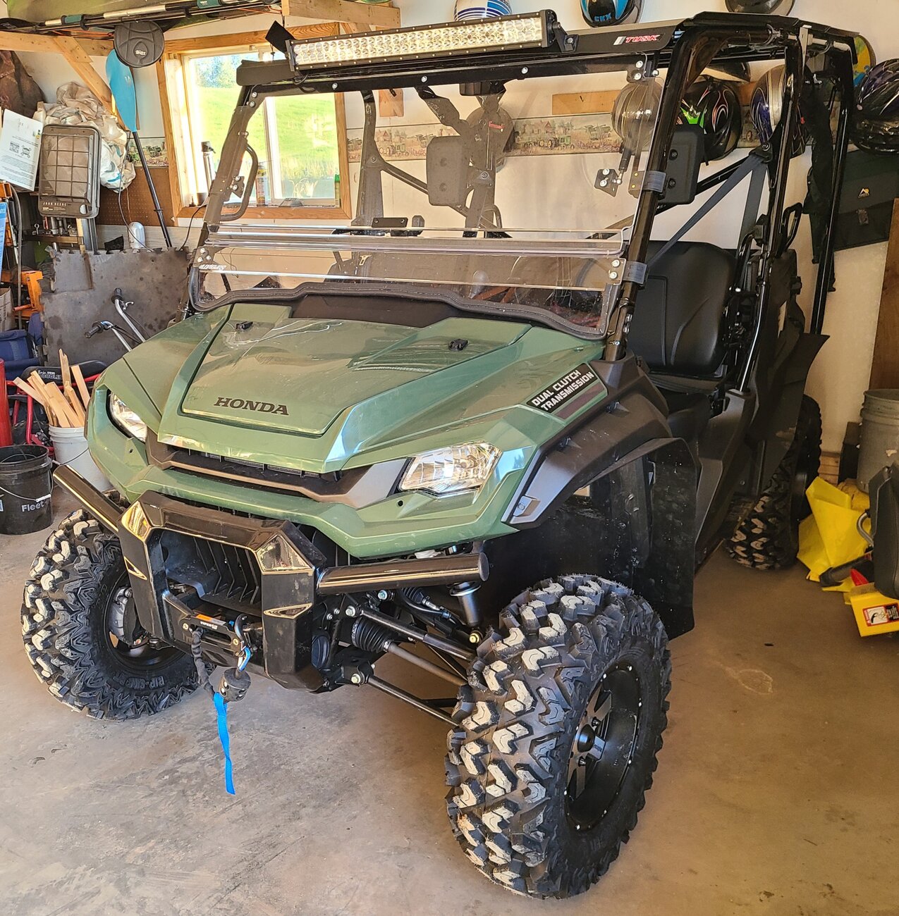

Got everything together. Still rubs, did even down to 7psi, so I went back to 12. The cutout section that is available is the wrong place. It looks to be for directory behind the tire. Mine is rubbing on the center of the tire at full turn, both sides but left is worse. A-arms are different, so I guess we'll have to live with it until they come out with ones to fit mine. Actual tire height on these 28x10-14 rip saws measures more than 2" taller than the 27" that came on factory.

Ok. I was wrong. I took a wheel off to measure. At rated pressure (8psi for the rip saws, 20 psi for the factory dirt masters) held flat against the wall, not attached or loaded, level from top of tire to the wall I got; 26 3/8 inch tall for the 27x9.0-14 dirt masters, 28 1/4" tall for the 28x10-14 rip saws.
On the vehicle the rip saws don't flex as much at 13psi as the factory tires did at 20psi.

I had the same problem when I mounted 27x14x14 whiteouts on my 22 trail. Like mentioned above soften the plastic with a heat gun and use a spacer between your tired the inner fender to make room. There is a little over an inch between the inner and outer fenders. You can pull the pins and remove the inner fender to see how much clearance there really is. Would adding a 1" spacer move the tire out far enough to give you the room you need?

There is not an inch of room between my inner and outer. I did heat up the right side and try to bend it. It didn't move hardly at all. Took it off to find it was against the inner. Took the left side off too and found there wasn't much clearance on that portion either. I don't think it would help to space the front wheels out, it might make it worse. I do have 1.25" spacers on the rear and could try one on the front to see what happens.
Took it for a little ride today. You can feel it rub turning left, but only turning at full lock. Turning right you can hear it, but not feel it. Again, at full lock only. So if I'm careful, it might be fine for a while.

You are right there is more space between the inner and outer fenders closer to the outside edge. I did have to do some careful heat massage to the inner fender to give the outer someplace to go. It is a Pain! I wonder why Honda doesn't have forward arms as stock? There is certainly enough space from the top of the tire to the fender but never enough space between the tire and the firewall
