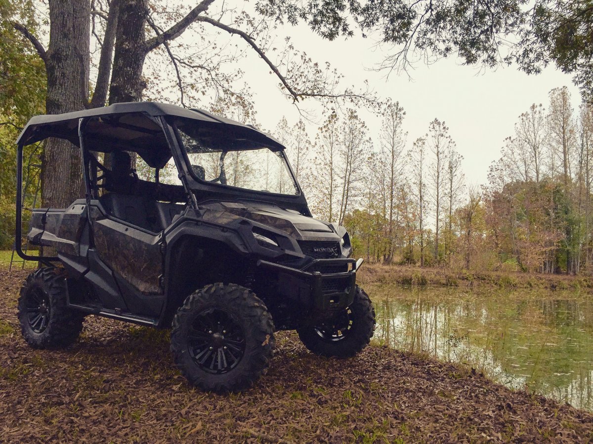

Here are a couple more shots from the weekend
Screenshot 20180731 171139
Screenshot 20180731 171206
39,129
mine is 6'9" with 30' tires and 3" a-arm lift
Oh wow, blast from the past! This is from 2015
Yeah I figured that out a while back. But thanks for replying way.
What a-arms you got?

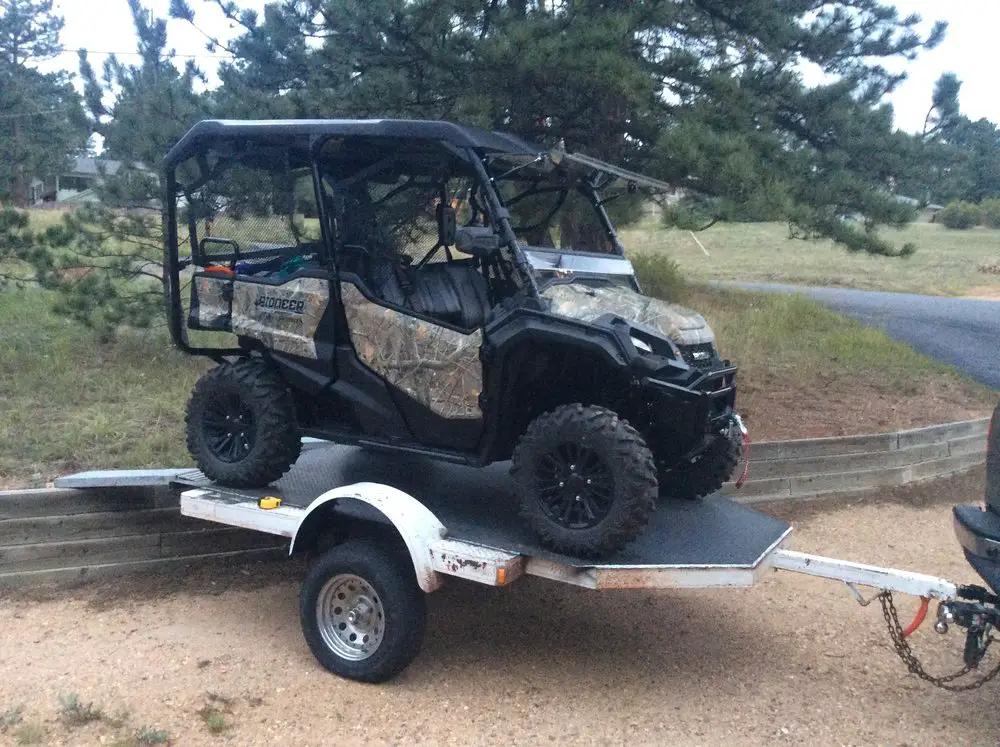

I’m working on modifying an old 3-rail motorcycle trailer, which I formerly used for my Honda Foreman 500 (that I traded for the Pioneer 1000-5 - growing family, ya’ know). I welded a 6’x10’ deck on the surface. Here’s the first “test fit” of the machine on the new deck to plan D-ring tie-down placement. I also flipped the axle on the trailer because it was so darn low to the ground... and I had to back up against an embankment to load it! I ordered 6’ ramps on account of this. Well, hopefully i’ll Get around to a trailer and UTV build-thread of my own, although I have a profile on Sportsmobileforum 4x4 Van group where I’ll probably do more trailer-build posts, since this tow-behind is going to be a rugged adventure beast by the time I’m done with it!
What's the axle capacity on that trailer?
I wish I knew; any ratings plates are long since worn off. I hope it’s a 3500, but might not be. The tires are sure overloaded as configured, but I was already planning on swapping those. The steel deck is 500 lbs! The axle is candidate for replacement; flipping it for ground clearance was cost-free, so I went for it just to see the results. But I’m thinking about upgrading to axle-less spindle suspension.
