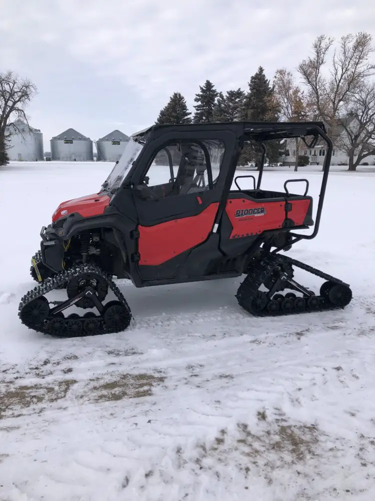

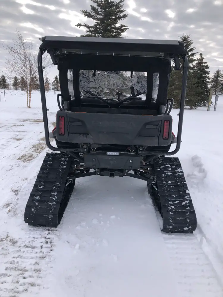

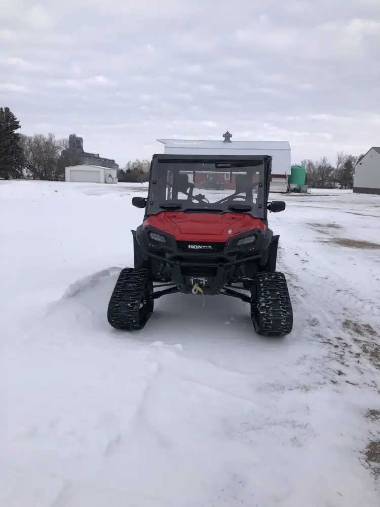

Awesome rigs you guys have! Just did the tire/track swap two weeks ago. Plus a bearing check/ and a small cap of oil in each (40 IIRC). Got to say, it isn't my favorite chore. That's all forgotten when powering through deep snow. Enjoy those tracks!

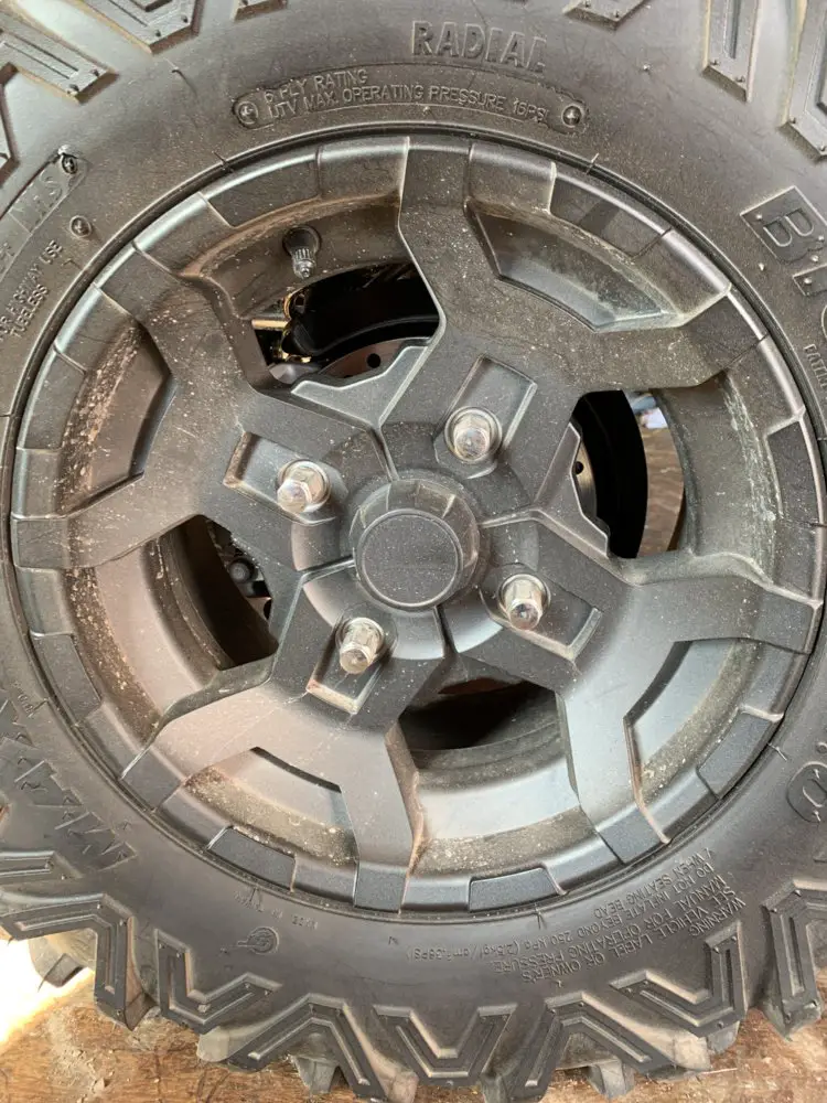

My 2019 1000-3. Already installed the SuperATV power steering, 2 piece windshield and have done the vent line mods. On order is seat cover, tailgate latch extensions and kfi winch mount for badlands winch. And yes those wheels are from a Kawasaki teryx. Long story about that lol. I got them cheap.

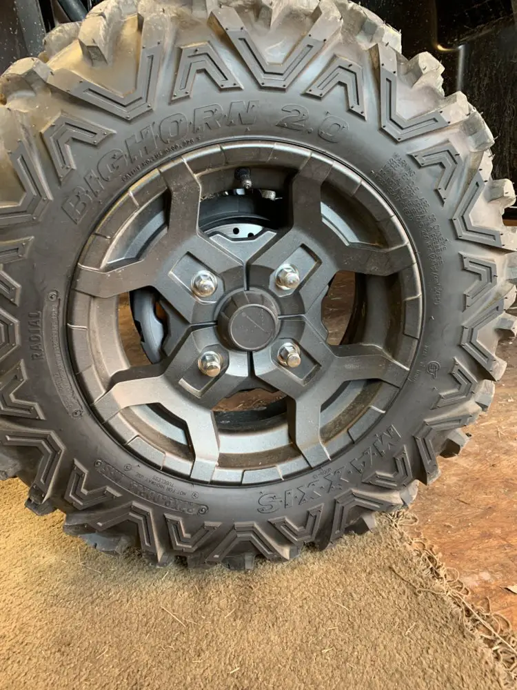

When I went to pick it up they were out of any factory takeoffs but my salesman worked for both dealerships including Kawasaki and Yamaha. He told me there was some black takeoffs from a Teryx over there. We went and looked at them. I tried one in my machine and it slid right on. Now the issue: Thread pitch was the same, but instead of running a bevel wheel like Honda does, the Teryx wheel had a flat face. So I couldn’t use my factory lug nuts. I had to order ones with a flat flanged side that would sit flat against the wheel and provided washer the Teryx wheel came with. I like them and think they look cool.

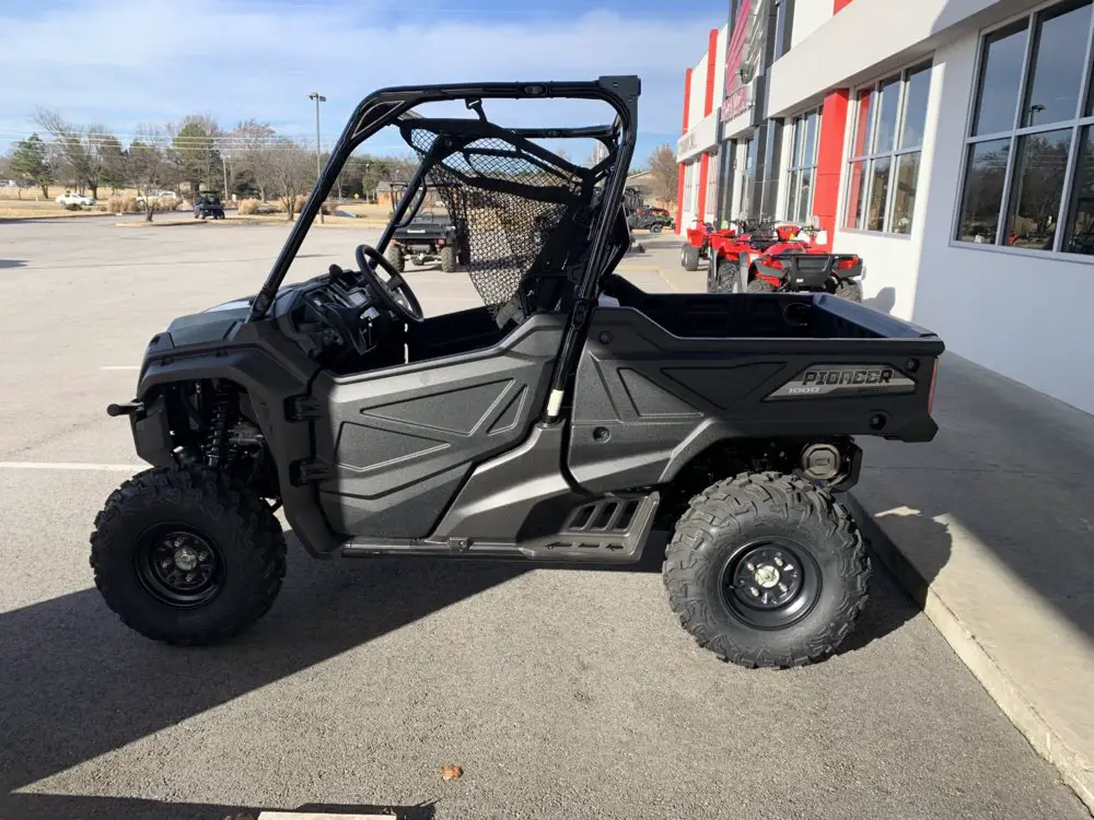

This is what it looked like when I brought it home,,

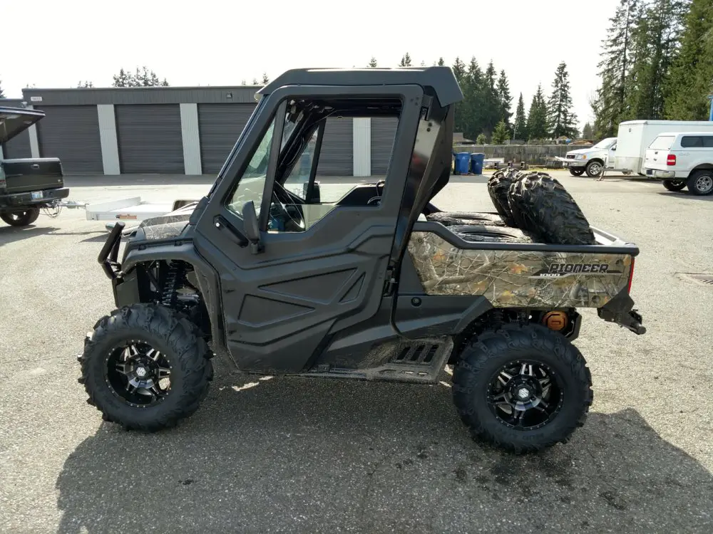

Now Look at it, I did what I would never do to a good pickup and that is put a bunch of aftermarket crap on it, I guess That is just what We do with Our Pioneers, You Guys are a Bad and Good influence, its a love hate relationship,,,
