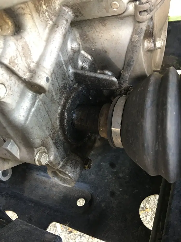

Just got looking at my machine and making sure things were ok for a ride this weekend and came across this. Not dripping on the skid plate or anything but it looks like there's quite a bit of oil around it and on the engine. Front kinda looks the same but not as bad. Thoughts or suggestions?

Somethings a miss, ride easy and take a look inside, my just be seals

Weird thing with mine...the rear had a small line of oil from the shaft down for a few rides...then stopped!! Not sure why and told one of my friends (who works at an ATV shop as a mechanic) who saw the original leak, and said it couldn't stop...don't know what to tell ya but mine did-LOL Mine wasn't that bad though

If your still under warranty I'd have the dealer check it out. If not I'd just keep an eye on it until it gets worse or goes away.

Maybe the oil level got low, diffs don't hold a lot of oil

Oil level is fine. This is coming from the back of the engine to the drive shaft. Talked with my cousin who is a Honda fan just like the rest of us and said to take it in & said more then likely a seal. The front shaft looks the exact same way. Its still under warranty so I'm gonna let them deal with it. Just kinda bummed because I was looking forward to riding it this weekend. Good thing I've got my 07 Rancher to back me up lol. Not pissed and its just a s*** happens thing right?! This spot on the rear end keeps Re-appearing. I know for sure that should not be happening. Will see what they say tomorrow. Appreciate everyones feedback. Will keep you updated!

Make sure there's no vent lines stopped up.

Very well could be the seal, ive had a couple atvs do that. But it could also be the grease Honda uses ro assemble these at the factory. Once it gets warm it runs everywhere, and once grease or oil gets on aluminum engines, you could wash it a hundred times and stuff still sticks where ever the oil was.

Maybe that's all it is but it's at the shop getting looked at now. I know my old one never did this. Hopefully nothing but getting it checked out just in case. Should hear something from them today hopefully.

Called to check up on my machine today and they said that they took pictures and sent them to Honda to see if warranty will cover it. They said that it has to be leaking so much in order for them to do anything. The tech was gone gone today of course. They sent them out yesterday and they are suppose to get back to me tomorrow. So hopefully good news

Got it back last Friday and they said that this is normal and to keep an eye on it. They said that it is noted with Honda just in case it keeps happening but they don't wanna see it back until there is a puddle on the skid plate. Just kinda weird because it never happened with my old one. Better to have it checked out I guess. Went for a 40 mile ride last night and still looks pretty clean. Will see how it goes. Thanks for all the advice!!

I know it looks bad but if it never drips I wouldn't worry about it. Be sure to check the fluid inside from time to time to be sure water is not getting inside. As far as the dealer saying if no puddles its not leaking reminds me of when I worked on john deere equipment years ago. JD had a specification for what constitutes a leak. It had to drip a certain number of times in 1 minute or it wasn't leaking.
