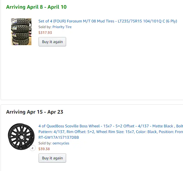

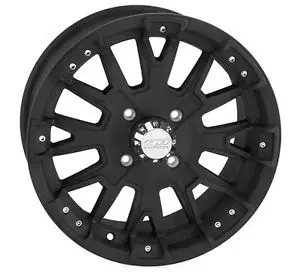

I just bought 4 of these for my PK1 couldnt pass up the deal 33.00 each
105757 Quadboss Scoville Boss 15x7 Matte Black Wheels

Question, those QB wheels are rated 573lbs to 727lbs. Is that enough for a 1000-5 load down? My ITP are rated at 1,200lbs each. Just wondering

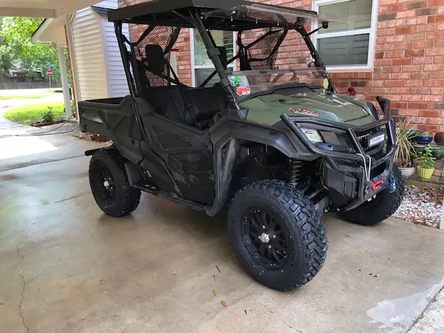

Just bought these 4 mud tires and 4 rims for my P1K5
Honda rims and tires
20,253
115,818
I am thinking about ordering these wheels for my pk1. Are those 3+5 and are you going to use 1 inch spacers on the back?
Yes, no I have 1-1/2 “ spacers on the back and 1” on the front. I have 30” LT MT tire with SATV forward arched arms

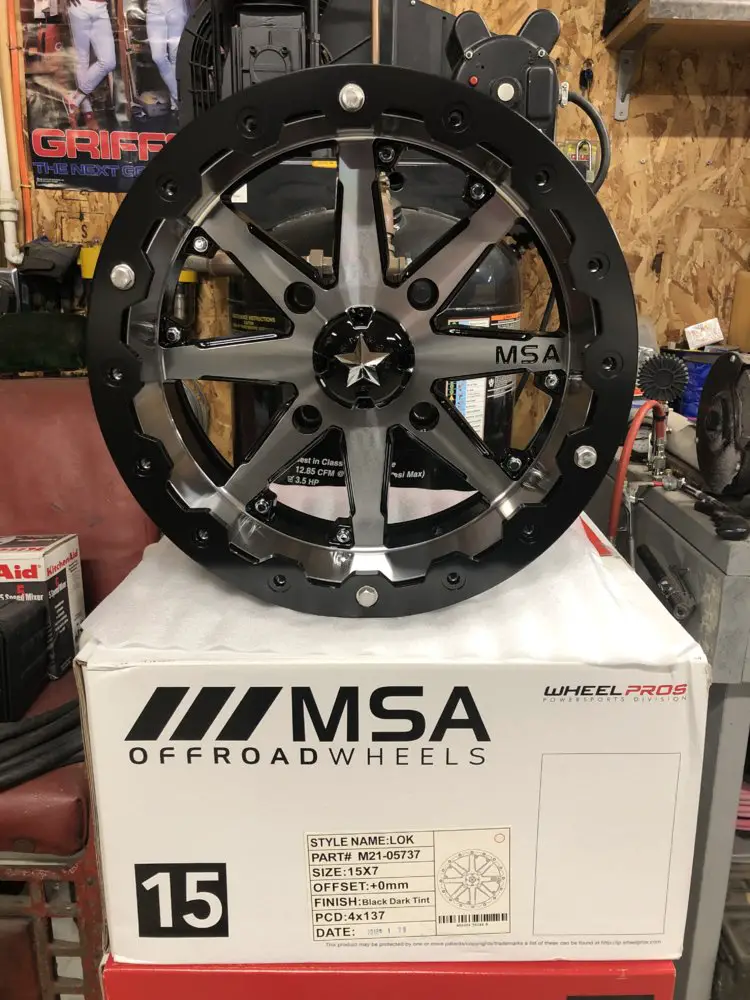

Well I just realized the msa m20 wheels I ordered are a 0 offset. Does anyone know what size wheel spacer I will need to make them even?

If I a thinking right, long day, you have a 3.5 + 3.5 and most of us are running 5+2 with 1” wheel spacers in the back to make it similar to a 4+3 since rear hubs are closer together. So with the 3.5 you will be wider in the front by 3 inches then 5+2 and I would still put 1” wheel spacers in the back to make it the same width.

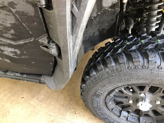

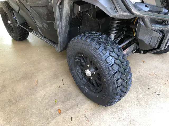

Got first rim on wanted to verify it would fit. RB3 1 inch spacer Awsome product!
Got tires for 81.00 each Forecrum tires 235x75x15 on Quad Boss Scoville 15x7 rims
