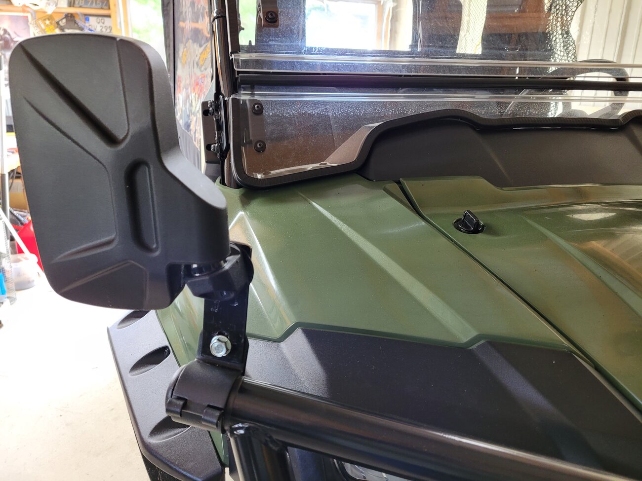

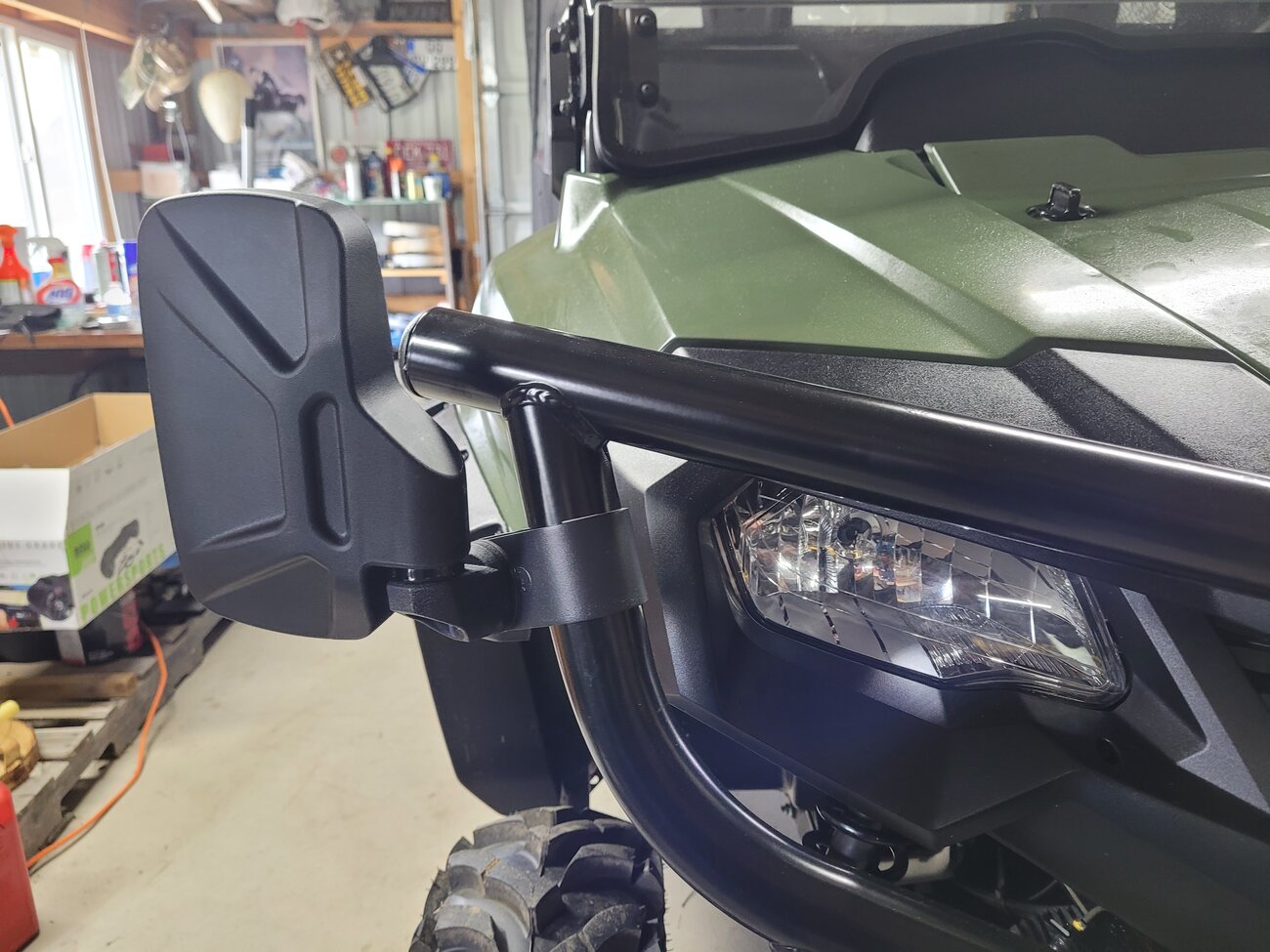

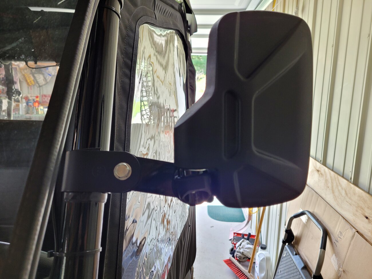

Another Method to Cure the problem of <>" Poor Vision through Mirrors & Soft Side Windows."
Mount the Mirror Forward to be seen Through the Winshield. ( Keps the from sticking out further )
Think of the old 50's Cars With Front Fender Mirrors.
Pictures included are of Pioneer 500's
1st. 2 pictures using Honda Winshield Mounting Clamps. ( Kolpin Mirrors online purchase )
Next 3. Pictures using Roll Cage Bolts. ( online purchase For Talon & commander )
Last 2 pictures taken from setting In the Seat.
Only the imagination & fab abilities can hold you back ( think OUTSIDE of Every day Box )
P520 is Next to get Talon Mirrors.
20210907 101550 20210907 101623 20210830 133824 20210721 135222 20210721 135843 20210721 135721 20210721 135714

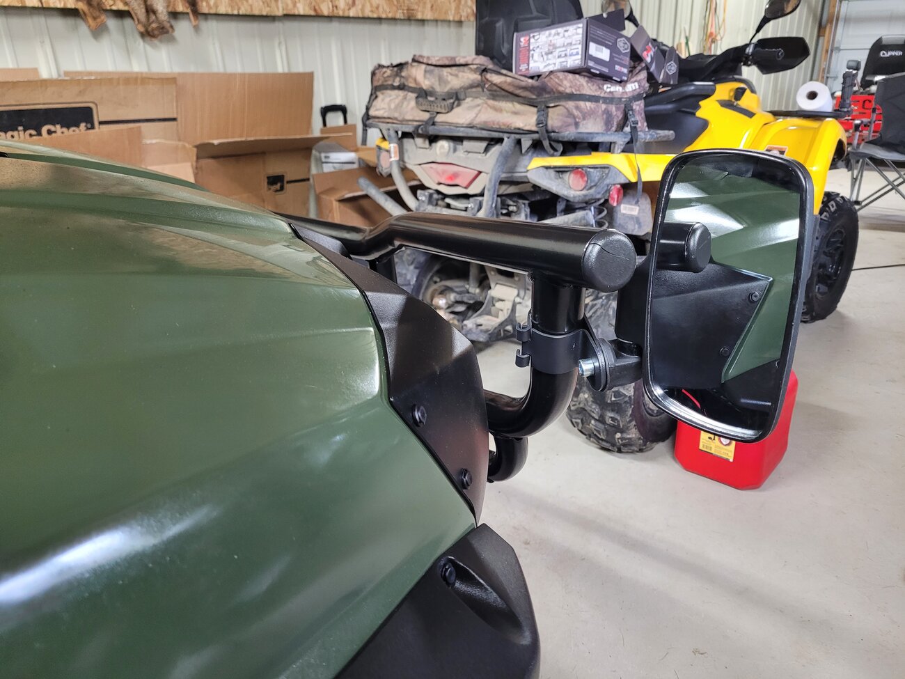

OK, I mounted mine to the front bumper. From driver seat good view, but I've still gotta test em out on the road.
20220427 135052 20220427 135112

They bend, not sure if it'll hit bumper or not I'll have to check. I don't ride much cross country so not a problem I'd expect to have, and if I do I go slow. I have other machines for sport, this one is my utility worker.
