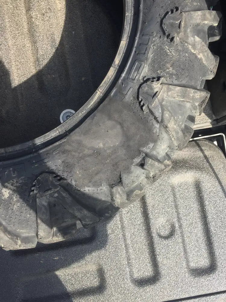

I got a puncture in the sidewall on my last camping trip.
I patched it and it was good for the rest of the trip. 3 weeks later I have a slow leak.
Is this a hopeless cause - or is there some plug / patch / liquid that will let me use this tire - safley ? Maybe just as a spare.

might see if you can find a place locally that will vulcanize your tire. Basically the add more rubber to patch the hole. See pic below - they have to cut a area out or rather grind it down but it makes it stronger that original
Have seen this done to tractor tires. Worked great.
Been there done that, did you have it done at J & S? Mine is holding up well.

What are you guys paying for the vulcanizing?
Yep, thank you for recommending the place - I went the day after you posted on here.... good group of guys ... they even tried to give me a bunch of okra when I went to pick the tires up... said $30 for the tires but you have to take some Okra.

For sidewall punctures, you can also put a tube in it.
