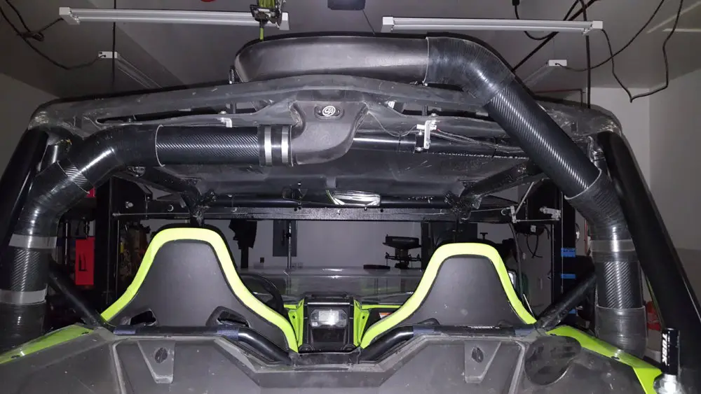

I Love mine, 750 miles and the filter is spotless. Filter should last 10 times longer and the S&B should pay for itself in 2500 miles. Just not having to dig into the air filter every 250 miles made it worth the cost.
I do not have the Honda one, it is too expensive by the time you buy all the other required wiring (an extra $300 if I remember correctly) and the mounting locations have it right next to your ear and it is noisy as hell on a 4 seater let alone a 2. I did a custom install on the roof, hard piped it, exhausted it out the left fender and wired it so it doesn't come on until the engine is started. I can barely hear it at idle. It is so quiet, the wifey didn't even notice it and she notices every little noise...
20191109 232932
35,445
208,728
Is the ducting on the roof? Wouldn't last an hour in NW AR! ????????

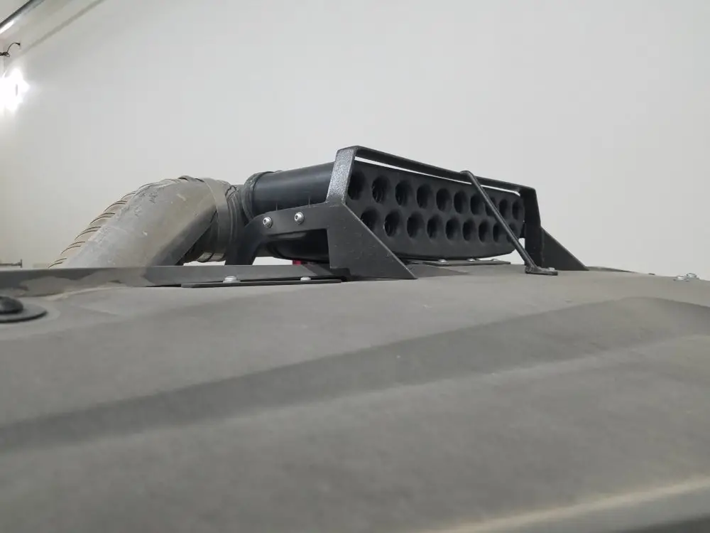

Nice job PaulF, looks real good.
I added a guard around mine to protect it and it has worked great.
I like your guard so if (and that is a big IF) I ever find myself riding in conditions that require some protection, I may copy that, VERY NICE!

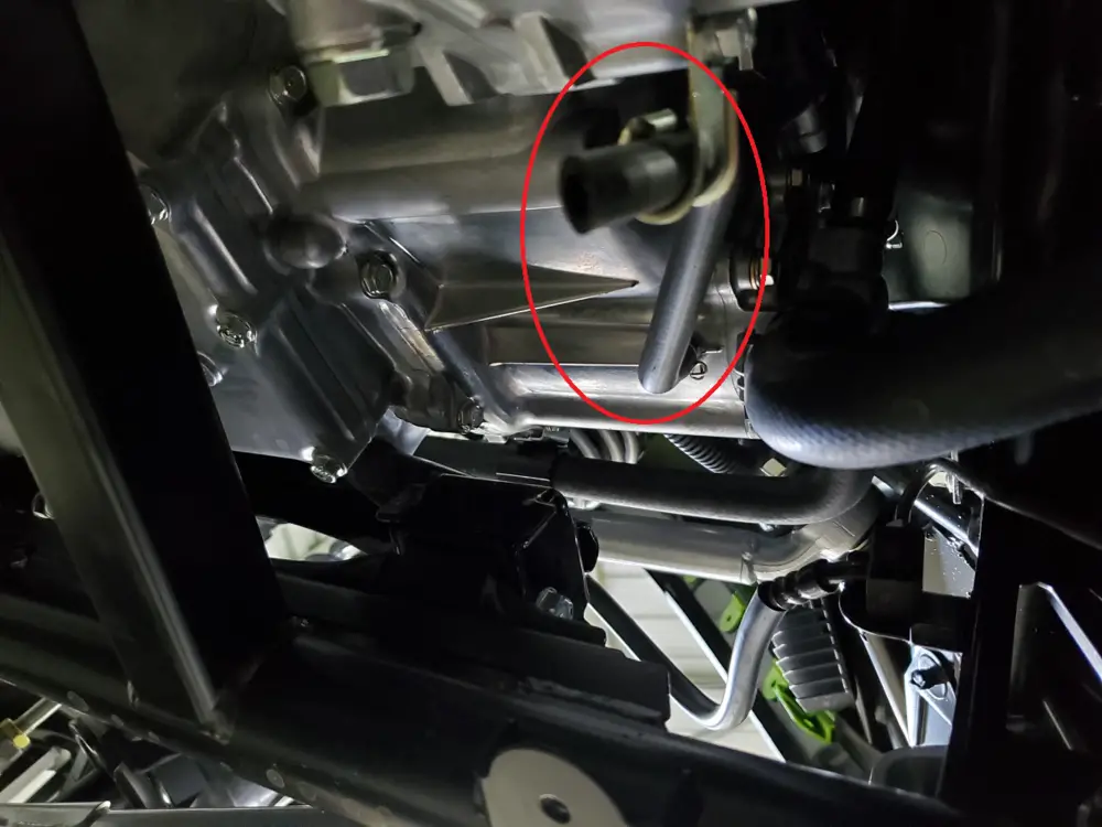

Hey guys, does anyone have the SYATV instructions? I have all vents figured out, but wondering if they mention the Sub Trans drain. Is there a check valve that makes raising this unnecessary? If it was, I'm sure I'd be able to find something via searching, but wanted to verify with more Honda experienced people anyways.
That's the water pump weep hose to let you know when the inner seal is leaking.
