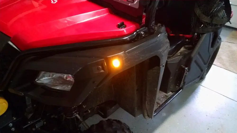

Did you drill into the plastic to mount those? I was hoping to stay away from that and rig something up. You have a picture of the front lights?

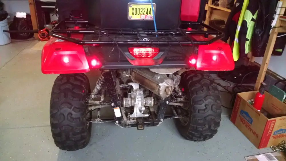

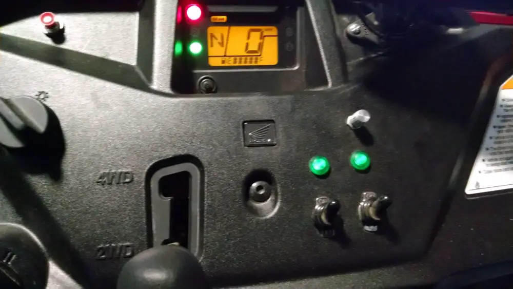

Yes...you need to drill a small hole.. On the rear I have a running/brake light to the outside and a turn signal to the inside. Also, here in Washington a license plate light is required. You can see that mounted on my storage box. The front is just a turn signal. I took these pics while it was flashing. Took a couple of trys to get it right. I have two switches on the dash for the turn signals. I didn't want to mess with a colum mounted switch because of the paddle shifters. That little button in the upper left is for the horn. View attachment 17194 View attachment 17195 View attachment 17196
INDICATORS STRAIGHT AHEAD , SWITCHES ON THE LEFT

34,174
What's that between the indicators HUCK??
Ram Mount for cell phone holder or cup holder or whatever you want to put on a ram mount . I use it for my cell phone so I will see it when my girlfriend calls or txt
Ram Mount??? Does that have a different use typically and you repurposed it as a cell phone holder?
