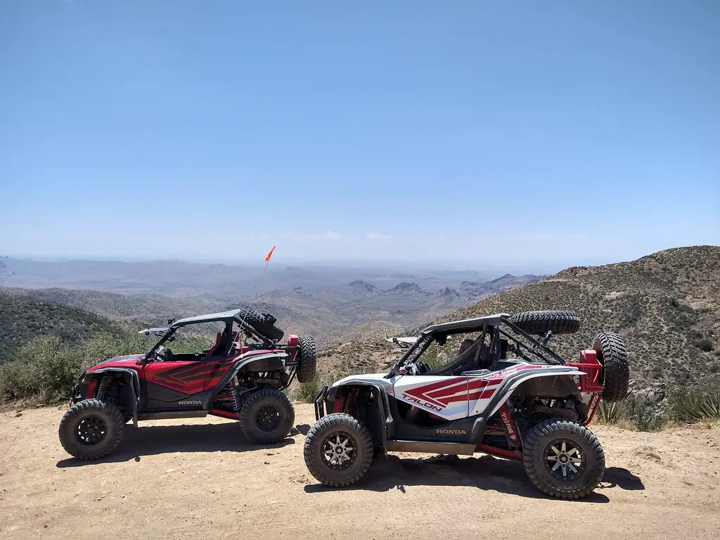

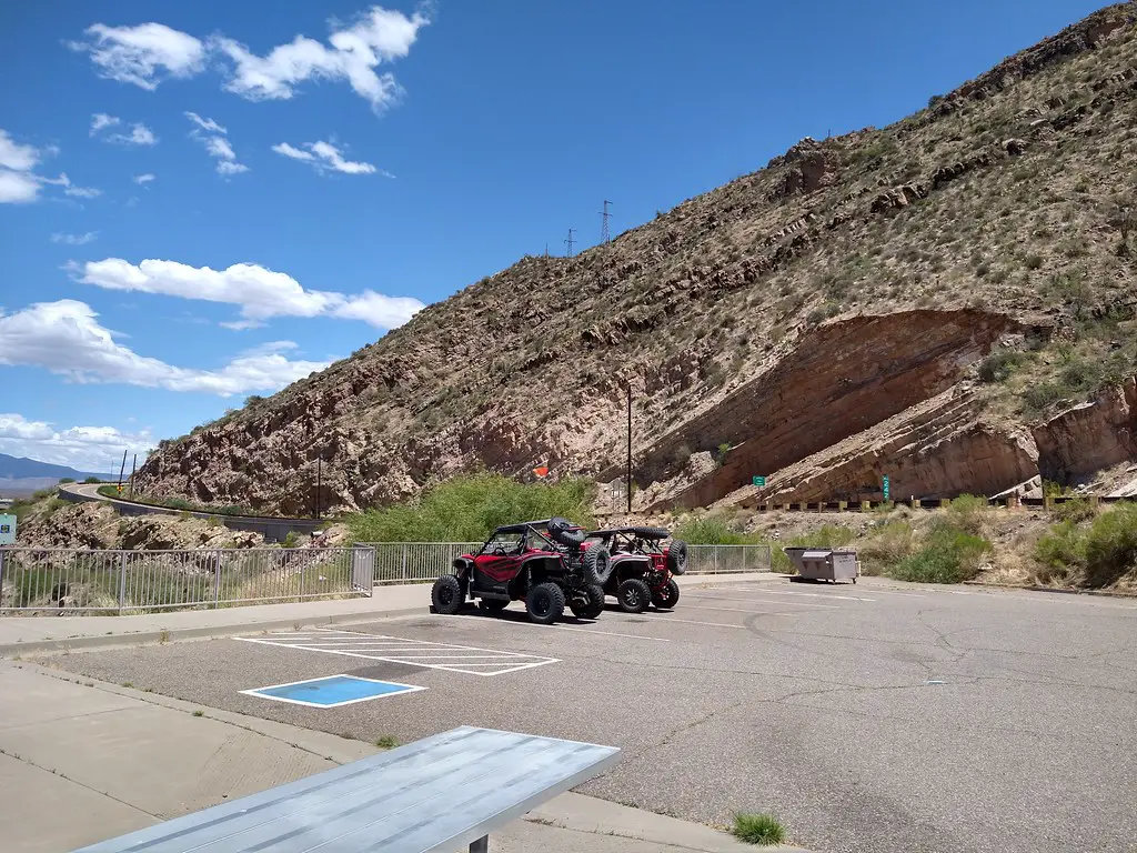

High vs low DRF spare mount, @CID and my machine visual comparison..... (apologies for the pic bombardment)

If @CID did have a rear view mirror, he wouldn't be able to see much out of it with the high mount spare.

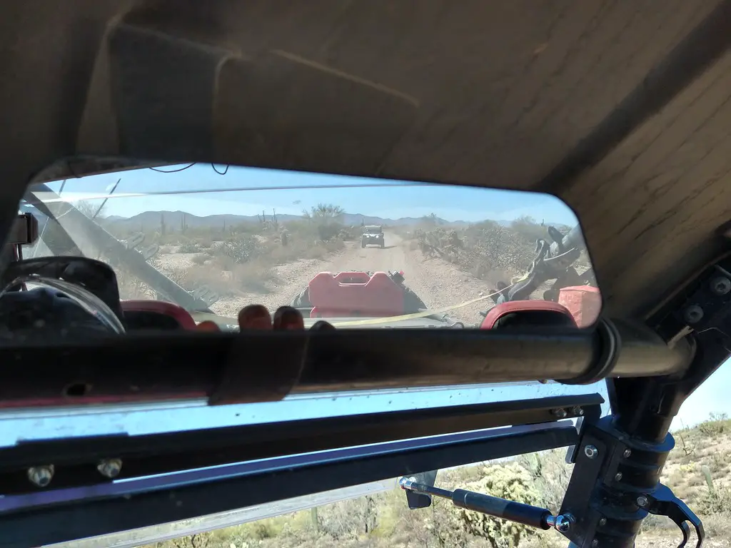

Here's what I can see in my rear view with my second spare carrier removed but with the DRF low mount equipped.

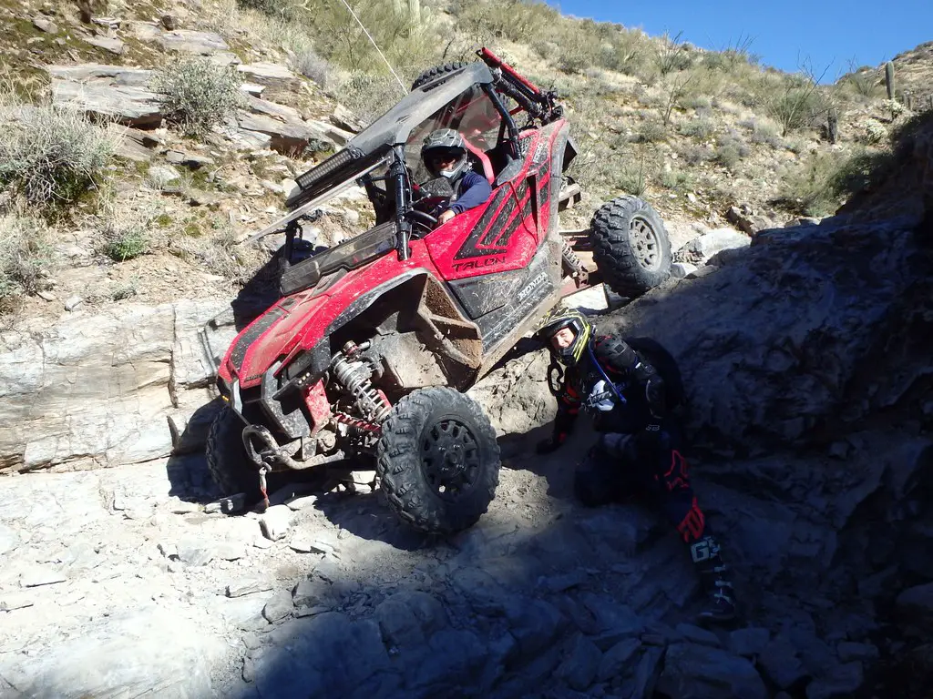

Not much in the way of a departure angle here, but it's not even remotely a concern.
I SJ2BpWM XL
The height of the "high" mount makes it very unlikely to ever be a problem, especially with casual use.

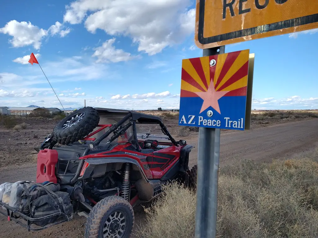

Another reference, I followed a few of my buddies on their bikes for 3 days/over 350 miles of mostly dirt/varying terrain on the AZPT while using an ATV cargo carrier. Anytime I thought the carrier might be at risk of contact I'd ask them to have a look, I wasn't even close.

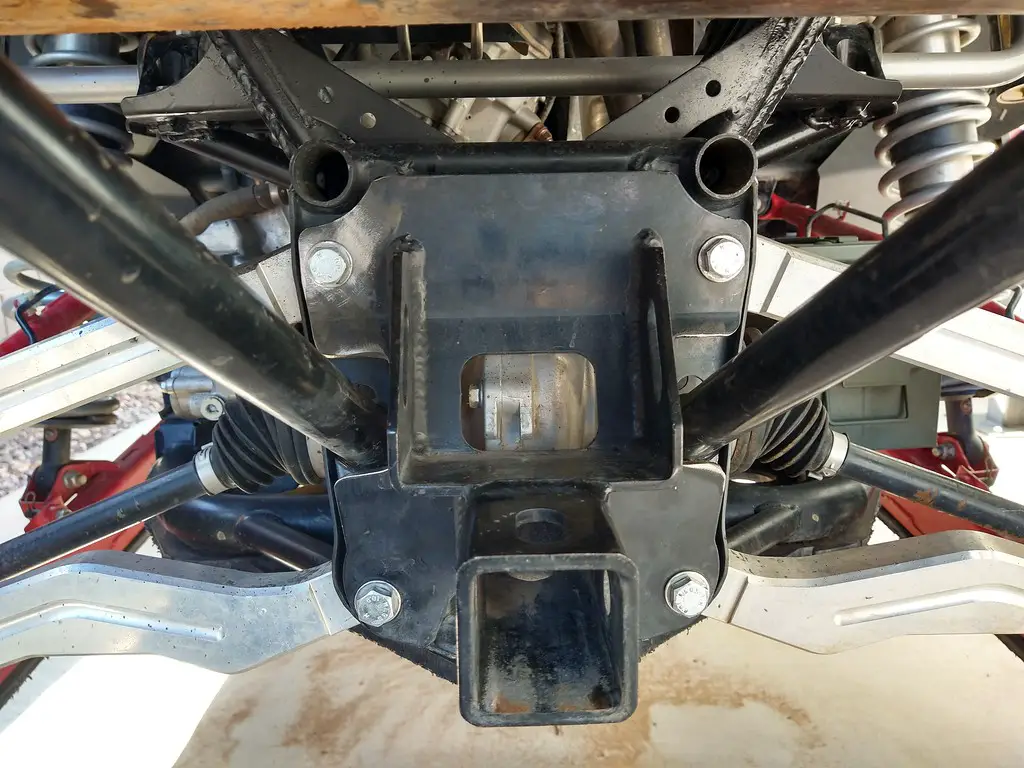

Hitch receiver, yes, the DragonFire is compatible with the DRF bed extender but it's pretty thin walled steel. I previously had the KFI receiver and it's much more stout. When my buddy repaired my broken frame he also made a couple of cutouts so I could reuse the stronger KFI receiver with the DRF bed extender.

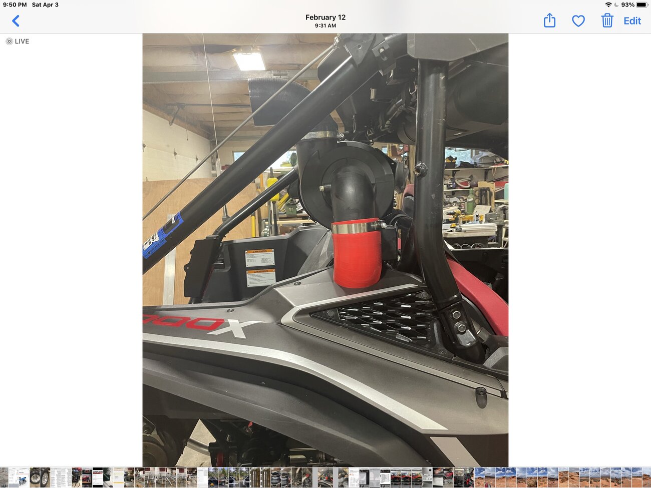

Here’ some pics of the different things I have done. Some pics don’t have the latest upgrades. I need to get it out and take some new pics with everything done. Radiator is for a small block chev, so it will never overheat no matter what the ambient temp. is. The shift handle is hand made. I couldn’t find one that I liked I could afford. The rear cooler rack swings out. The reinforcement plate at the rear doubles as a strap connection point. I use that to winch the Talon up onto the aluminum truck rack. The Donaldson filter can had the 90 deg. Elbow to start, but I added the top spin unit. The filter rarely gets any dirt in it. Since I’m kind of an old f***, I made the center caps and added the Crager knock offs. I will have to get o m ass and are some most recent pics.

Exactly the kind of pics I was looking for! You have made my decision for me, Lil' Steve (I'm BIG Steve BTW 😁 ). I'll be going with the spare carrier on the DRF in the low position like yours.

That is a sensational looking rig, KenThompson! I do recall seeing your tailgate after you first fab'd it and posted pictures. I was impressed then and certainly am now.

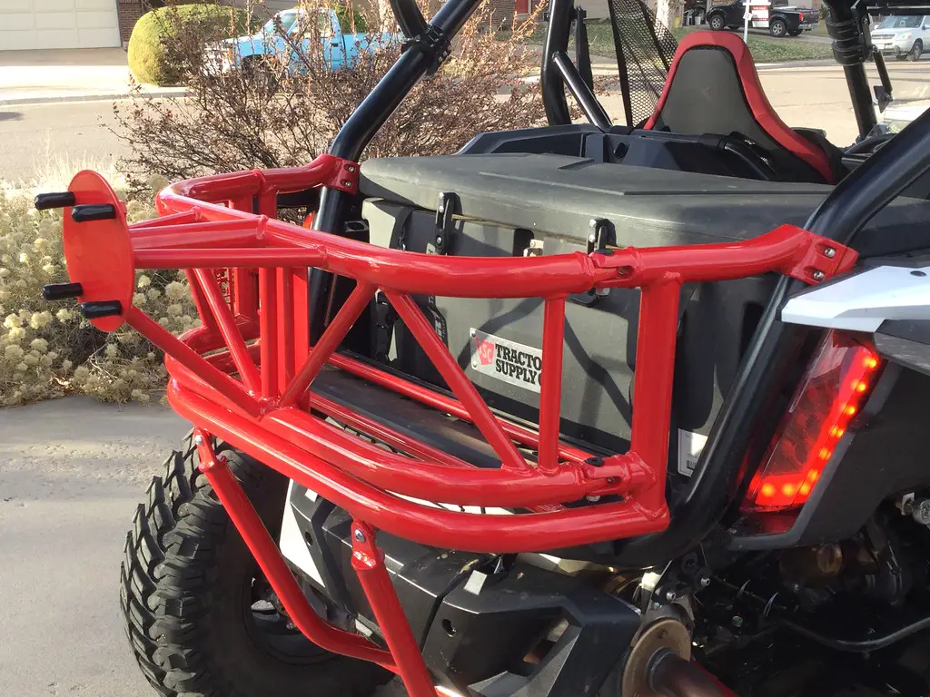

There's still time to have him add the spare tire carrier, IF you decide that that cantilevered weight is OK. I've ridden at some 'enthusiastic' speeds through the AZ desert rocks, chasing @Lil_Steve and haven't had any problems with that weight waaaaay back there. Please understand - I know that this is your Talon to build as you want; I'm just offering up information to use as you'd like, options are good. It's easier to remove that bracketry than to add it later.
Best pic I have of the mount -
Do you know the weight of the carrier?
