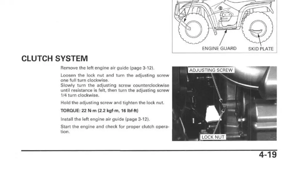

If you want to adjust the clutch, this is the procedure on how to do it. I would go a little more than a 1/4 turn , it shifts best on my machine this way !
IMG 0971
Should this happen to you again , there is a tool supplied with your p500 to manually shift the transmission. The tool is under the drivers side seat , next to that massive tool kit supplied by Honda !

Yes, had to use the tool once before I adjusted the clutch, glad the dealer pointed it out on delivery walk thru. Clutch adjustment really improved the shift smoothness and no problems since. 2017 P500.
