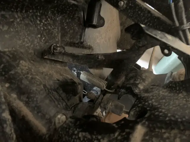

So I got the PS kit from Rocky Mountain ATV. It looks identical to this kit so guessing they all are made by the same company. On my 2017 P700-4 there is a metal plate around the stearing shaft that is different than your pics and what the directions show. Also I don't have the bump in the firewall around the brake cable, anyone else install a PS kit on 2017? Here is a pic of the plate after the stearing rod was removed.
Looking now at the Kit from SuperATV I see that there is a different kit for the 2017 p700 compared to the one for 2014-2016. The kit I got from RockyMtnATV appears to be identical to the older kit when I would need the newer one.
Hey LCK Boater. Yes the 2017 and later kits are completely different with respect to mounting and shafts. Looks like ECU and Steering motor are the same. If you can lift the front end to get the wheels off the ground a bit it helps when checking to see if things move as they should before you tighten everything down.
