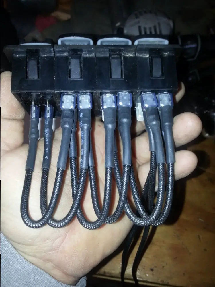

Almost like ive done this before hmmmmmmmView attachment 8536
Interesting wire. Is it braided material. It looks like you have four put together. You just jumper end them all and then bring a 12 volt positive and negative to one? In line fuse too? And then you picked a spot in the dash to cut a hole and install them?

That is high temp wire and those are the illuminated connections that are jumped like that i also jumped the grounds the feeds and switch legs are on their own and i mounted right on the dash to the right of the little honda sign

Thanks. Where can the wire be purchased. Just to be clear, the 12 volt power comes to one and then is jumpered to the others?
