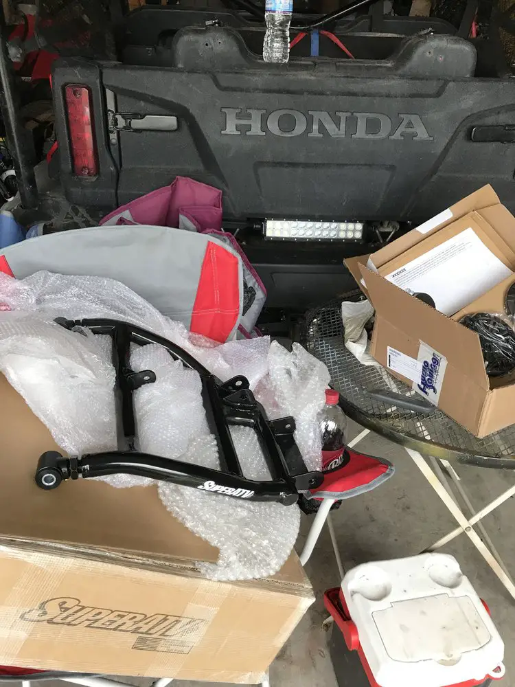

Received complete lower arm:)
Still haven't sent the damaged arm in! Great Customer Service! Thanks SUPERATV!

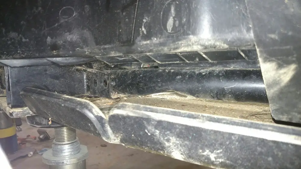

Started tearing into the rig to replace the fender and beef up the sliders under the skid and saw this one. Pretty sure this happened the first night out without my skid plate on. Our 2am 30 min ride around the block turned into a little more than that.
IMG 20170524 233900998
Then after getting the fender off I saw that's its going to be quiet a bit more work to fix since the idiot than designed the bars, extends up for the cage support.

yep thats what I was having to fix on my door mounts that got bent and I was like what the hell thats all one piece

They made the cage where individual tubes can be removed and made the underside one piece? Is this the same engineer that did the front air intake I wonder?? Lol

Yup.. that nerf bar is $265 from procaliber! The only reason I bought it was because of how it runs up into the roll bar. So freaking dumb!

I'm going to weld another frame mount on the back side of the pipe.. and then use angle to mount my rocksliders to.. like below but instead of the flat stock I'm going to try 1/4" angle all the way down.
Sounds good. Rocker tubes are to thin for what we do. Might think about cutting and sleeving the vertical tube to the A Piller also.
