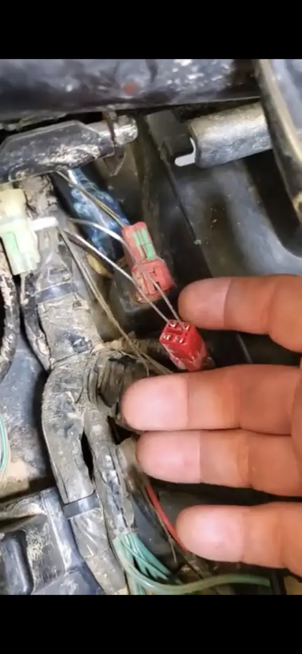

After listing to his video, looks like there is a plug under the seat ypu have to jump out (pic at bottom) then you cycle your key on and off 3 times while depressing the brake and letting off the brake . The i4wd will blink then shut off. After you do this sequence it should reset the i4wd. Might take you a few trys to get it. Hope this helps
IMG 6154

seems more easy then on the video ) Ill try tomorrow
