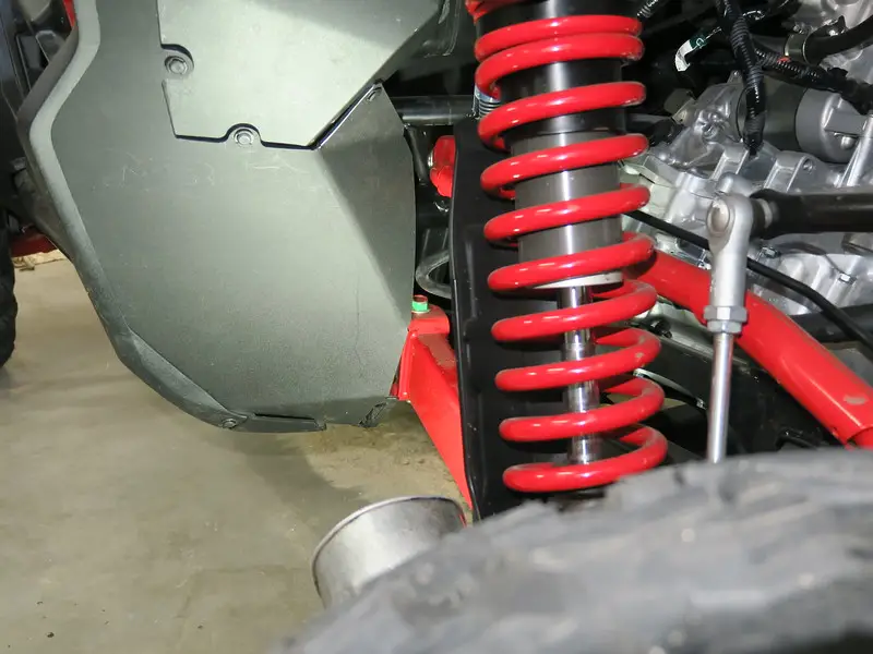

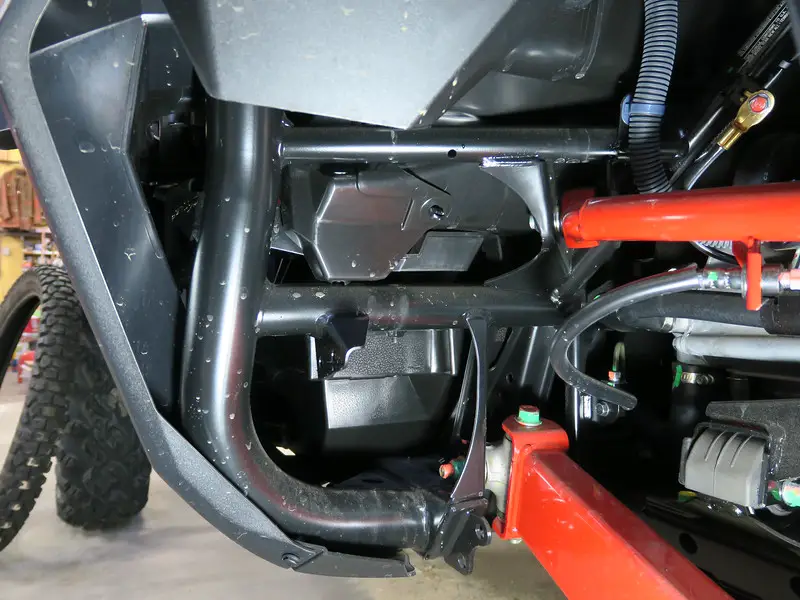

I need to check this out. I've covered the openings in front of the rear tires (link below) but when I hit water, either fast enough or deep enough, I get my butt cooked in a good steam bath so there are definitely openings under/behind the seat (never had a passenger so I can't speak to the other side). In order for it to steam, it has to come off the motor, not directly off the tires. 🤔
This needs better sealing without gluing it permanently into place.
1593221657304
There's a whole lot of openness under there -
1593223201663

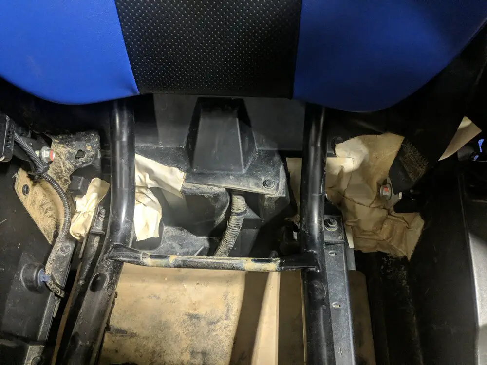

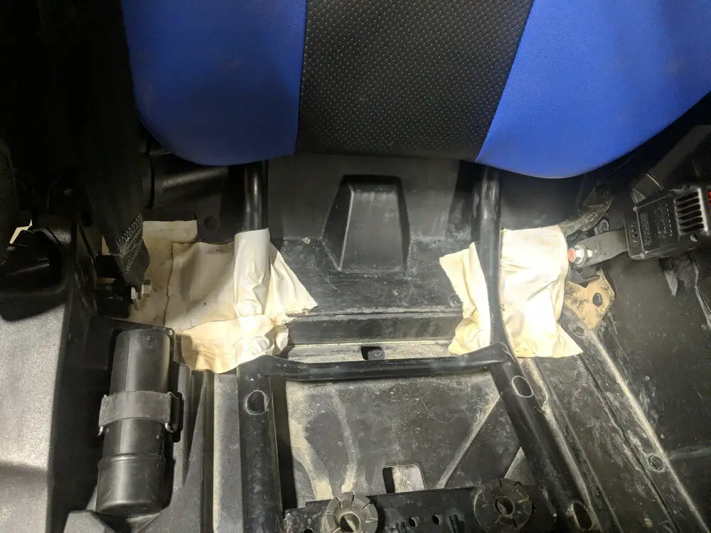

I sealed the holes from the inside. All I had at the time was white flex tape I figured at some point I would do it better with black tape.
1593226504938526190790972740389615932265668442009190841553821440

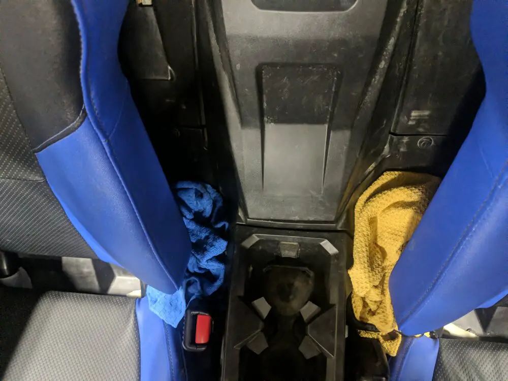

I also wet rags and stick them in those corners. It's what I wipe the boys's windshields and helmets off with. But it keeps dust from coming up through those corners also. Not perfect but it helps a ton.
15932267686518572978637127718944
I do that on both sides of the seats.
View attachment 209716View attachment 209719
Thanks for the pics, 👍 I hadn't looked at it from the inside.

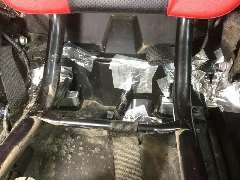

I finally got around to looking for the openings under my seat - holy crap!!! :eek:
So, a little aluminum tape (cause that's what I had) -
I nw4Cvm6 L
30 minutes later I had this. I was under the impression that the seat would cover/hide my work but it doesn't. :oops:
I DWkJRGN L
This project caused me to look at what's happening (my steamed butt on 'enthusiastic' water crossings). Although the mud guards stop debris off the rear tire from being thrown into the cab through here -
they're still wide open on the inside (yellow arrow), in effect stopping nothing from that direction (water/steam splashing sideways off the engine). Maybe someday I'll look into closing that off better, maybe - the tape will have to do for now and seemed to help, at least with some heat, on yesterday's ride (no water).
Wow, that’s crazy. I’d like to know how well that tape holds....👍
