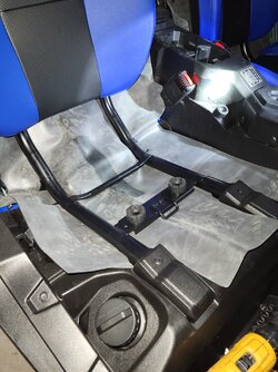

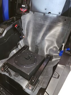

The DEI kit has been a positive addition to helping with the heat and dust. As @CID mentioned nothing is a fix all by itself. I would do this kit again but I think the DEI kit with @trigger under the seat kit would be a good setup. From there add the jeep boot and I think that would be really good without going crazy. I do have my openings under the seat sealed with Flex seal tape too....
