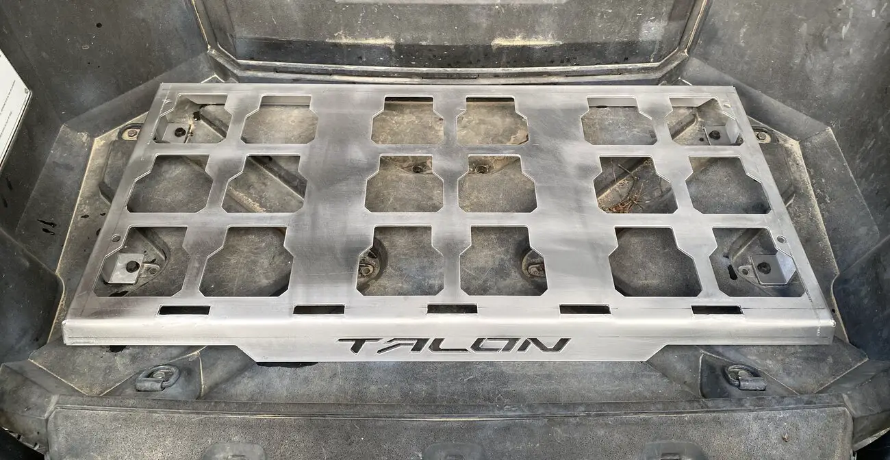

Update:
Received the first new design packout rack yesterday. It fits great, looks sharp and is super light! The shop and I have to figure out one bend correction then we should be good to go on these. Finished version will be powder coated silver as previously mentioned to stand out more in the crowd.

Update:
Going to powder coat this week. Mount weighs 3 lb 8 oz unpainted.
