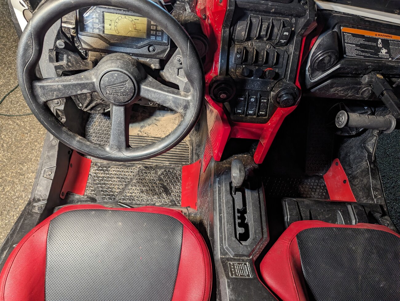

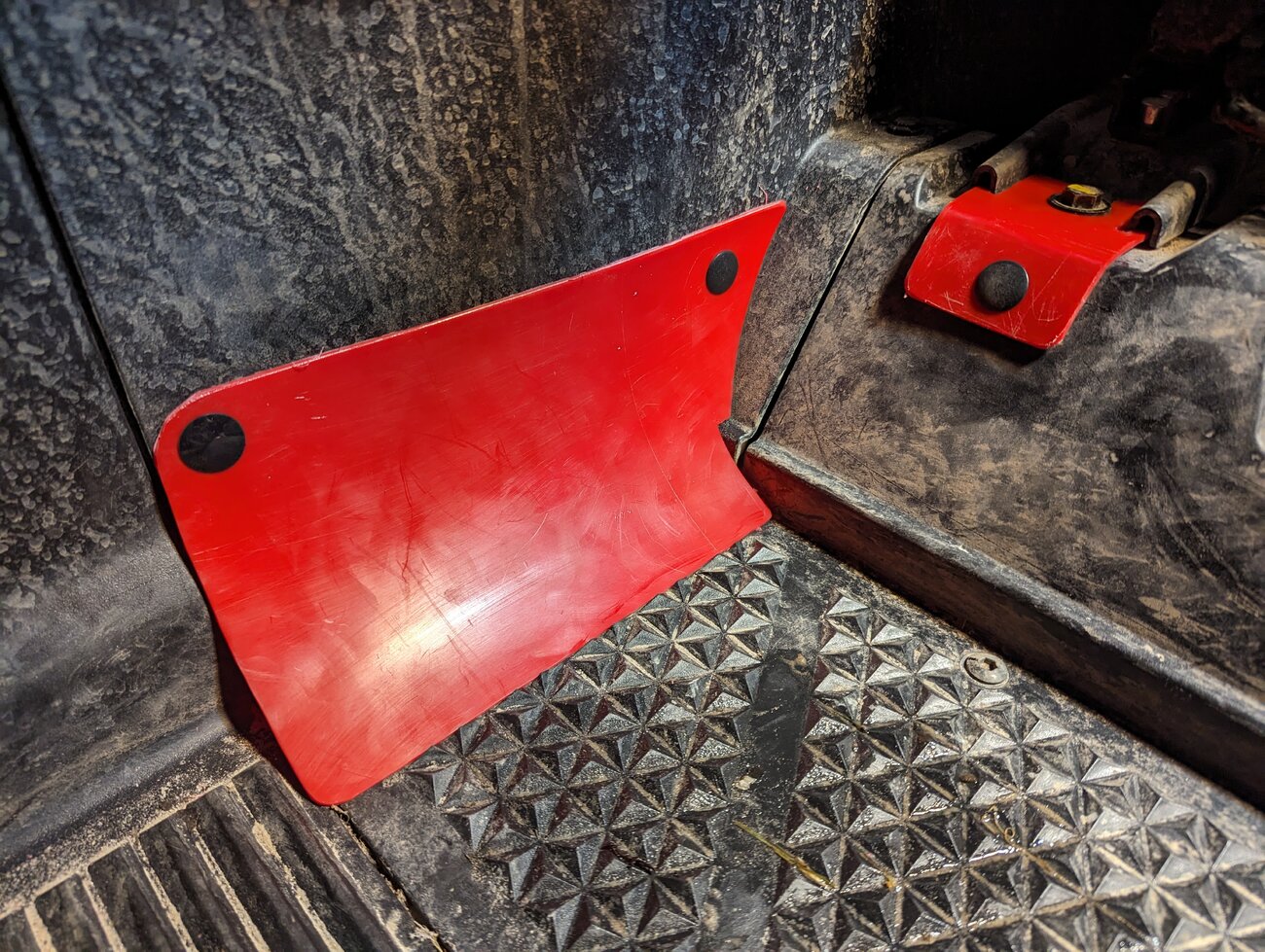

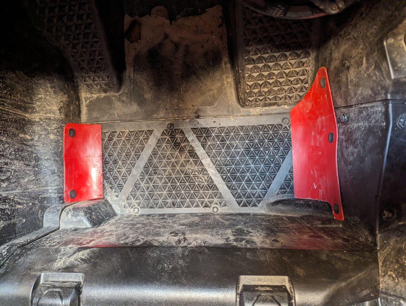

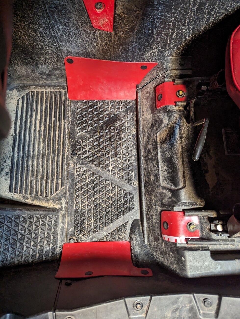

When I saw they were out of stock I made my own out of a 5 gallon bucket with some tin snips and a grinder. I actually think it performs better because the drain is still functional. It was more time consuming to make them than buy them online but much cheaper at $5 for a bucket at harbor freight.
