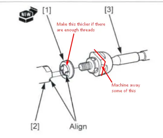

Maybe. I said "appears" and "approximately" but I think a swap would be a good place to start.
An easier method for the masses might be for someone to fabricate (or machine down) inner tie rod ends that will allow the rack to travel more. Or if there are enough threads, provide a new lock ring with a built in spacer. Kind of the opposite of the stoppers mentioned that come with the SuperATV forward arms. This would entail simply replacing the inner tie rod ends and/or lock rings, setting the toe and centering the wheel if necessary...
Examples...
Of course, all of this depends on how much abuse the outer joints will tolerate. I'm sure that Honda built in a little safety margin there but the question is how much? I was looking at the service manual (stating that the R should turn in 32 degrees) and never noticed on my machine (with 1500 miles) that my rack wasn't centered. The steering wheel was actually put on crooked and the steering centered to the crooked wheel. Checking per the manual, my machine turned 3 degrees more (35 degrees) to the left and 3 degrees less (29 degrees) to the right from the factory and my left outer joint is just fine. Last night I corrected this and centered my rack and wheel per factory specs.

Thanks for the measurement. Looking at that, I doubt there is enough threads to add any spacers by the time you factor in the thickness of the lock ring and the depth at where the full threads start in the rack. There doesn't appear to be any threads until until after the lock tab notches and even if there were, we shouldn't count them because they are not 360 degrees...
Upload 2020 1 25 10 5 40
So, only options appear to be to change out the entire steering gear box (UGH!), or come up with some modified inner tie rod ends.
Time to break out the lathe :)

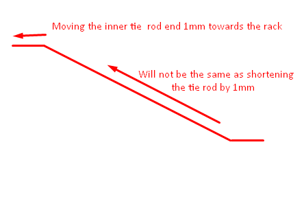

Well, kind of. That would work if everything was straight but we are dealing with some pretty acute (and multiple) angles here, especially when the suspension is full articulated and the CV angle is at its most critical. For instance, moving the tie rod 1 mm shorter will not be the same as moving the inner tie rod end into the rack by 1 mm...
Upload 2020 1 25 17 3 42
Now this could all be figured out by the angles but measuring the angles it tough on an R because the tie rod angles down AND forward at the same time and the angles change as the suspension changes so the measurements at level will not equal the measurements at full articulation.
Your method could get you close if calculated properly, maybe even close enough for this purpose.

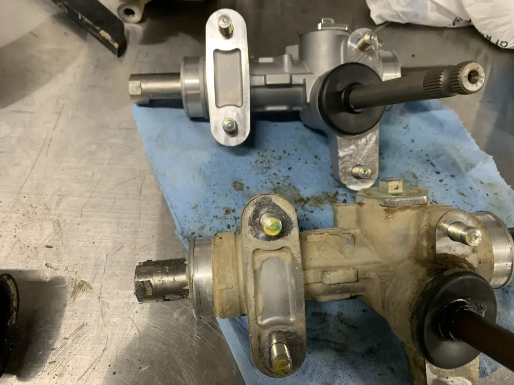

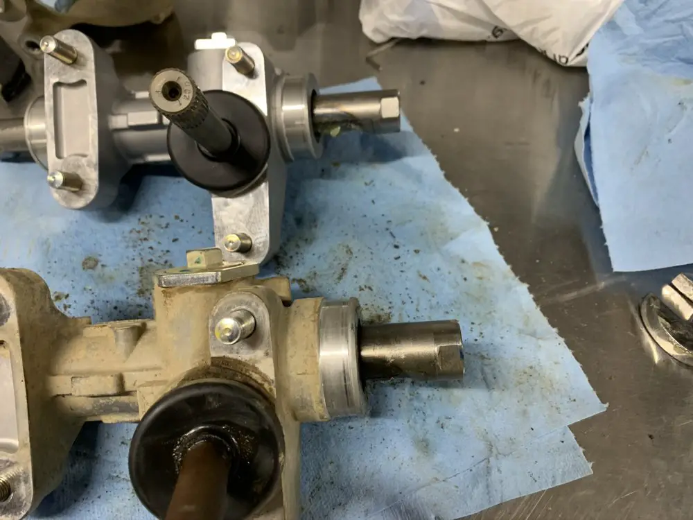

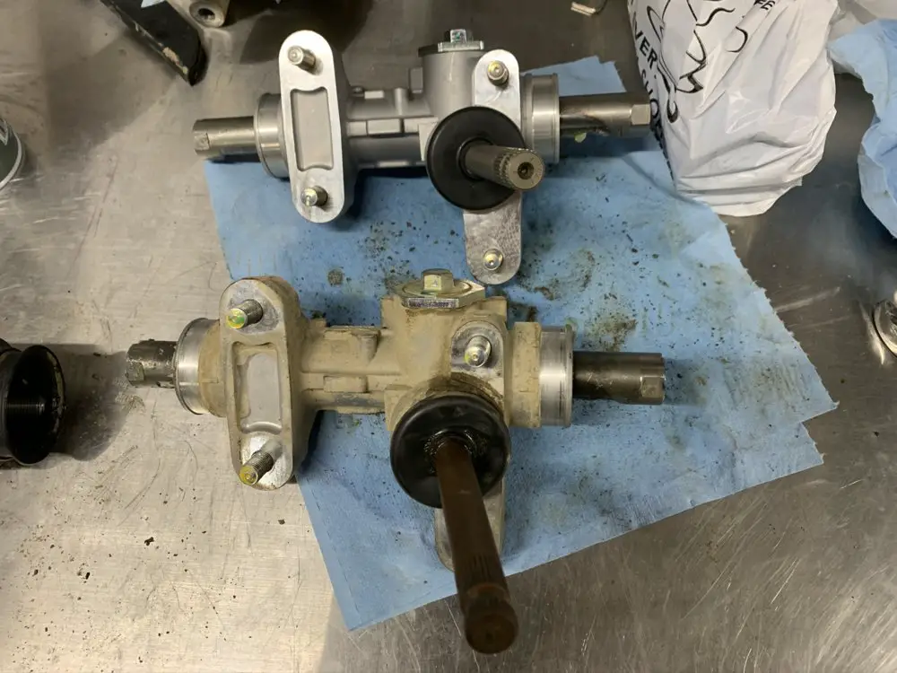

Time to revive this thread and report back with my findings:
I took my time before posting a response so that I could put some real trail miles on and test for issues. I've got 104.6 miles on the X rack with steering stops. Those 104.6 miles were down in Tennessee at the Royal Blue trail system across all trail difficulties with Dragon's Back and Widow Maker being the most difficult terrain. If you aren't familiar with this terrain......I tested the $h!t out of this setup.
I'm happy to report that my mods are working great and the turning radius has noticeably improved. I was not able to use the full rack travel that the X model has, but I was able to reclaim 3/16" of travel on each side of the rack.
3/16" + 3/16" = 3/8" more total usable steering rack travel. It may not sound like a huge improvement, but it was noticeable in switchback mountain trails and I"m satisfied with the return on my investment.
So, without further ado, here's what I did:
Important Note
  • I cannot confirm whether or not this modification will work with stock Talon 1000R lower a-arms. I have L&W Fab high-clearance lower a-arms and they appear to give more clearance for the wheel & tire when the wheel is at full turn/lock. OEM lower a-arms will likely rub the wheel/tire, but I cannot say for sure. Try at your own discretion.
Parts:
  • 53840-HL6-A01 - BOX, STEERING GEAR (Talon X steering gearbox)
  • SSK-002 - Steering Stop Kit from SuperATV. I had to call and order this kit. It was not available directly from their website to order. They have a Polaris kit listed that you can order that will not work for this application. The SSK-002 kit is included with the Talon 1000X forward a-arm kit [AA-H-TALX-1.5-HC-02].
Install & Overview Video:
Photo Comparison of 1000R vs 1000X Steering Gear Boxes:
X gearbox = shiny new part
R gearbox = dirty part
IMG 2708
IMG 2711
IMG 2712
