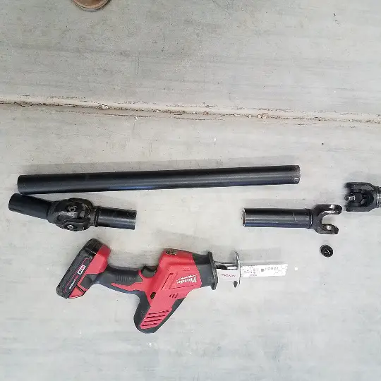

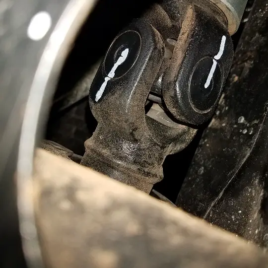

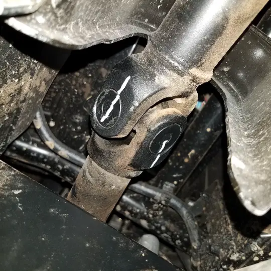

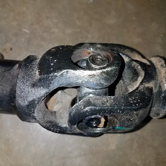

Its a known problem. The bearing caps are loose on some so they will turn and spit out the C-clip allowing the bearing cap to fall out. I marked the bearing caps on my 2020 Talon and still ok at 6,000 miles. My 2019 Talon had the drive shaft U-joint wear out at around 20,000 miles. Both warranty drive shafts failed in less then 3,000 miles. I got the 4th drive shaft bearing caps spot welded. I do carry a sawzall with a 9 inch blade so I can cut the drive shaft in half and pull the drive shaft off the sub trans. It would suck to half to drive it a long way with the banging. There is room to cut the drive shaft through the skid plate hole for the coolant drain bolts.

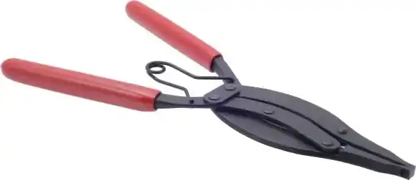

QUESTION: Based on your experience in removing and reinstalling the Talon drivel-lines, I am thinking you know what I am looking for. There is a clip that holds the drive-line in place that needs a "special" tool. It works like a snap-ring pliers so when you squeeze, it opens the jaws. THe tips need to be flat and almost like an inside-out pair of needle-nose pliers. What is the name of this tool and where can I find one (reasonably priced)??? Thanks!!!
Check these out.
Not sure if that "size" will work, but has some keywords you can look on Amazon for.
PaulF said - (info in the New Talon Owners thread linked in my sig)
"Not sure why anyone would go to that extreme and chance breaking the aluminum hub on the front drive clutch when the front drive clip is extremely easy to release with the right tool. Took me all of 5 seconds to release it. All you need is a pair of parallel retaining ring pliers like these..."

H
HondaTech
These are what we use
