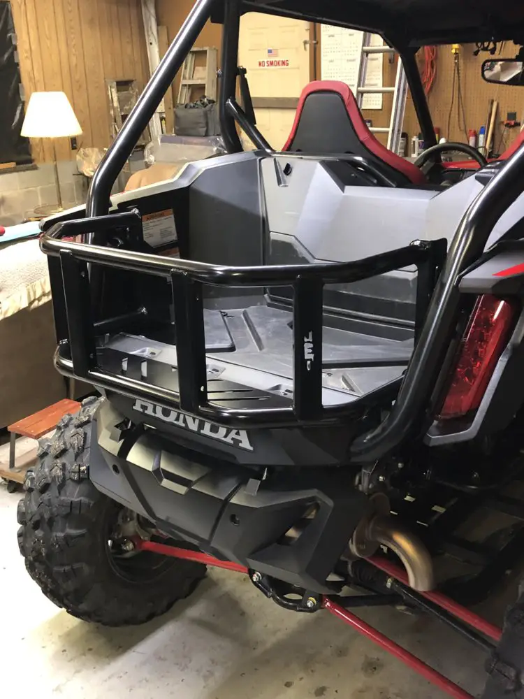

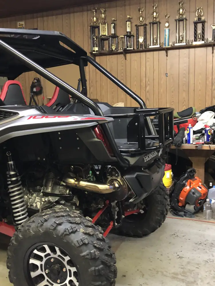

Dragonfire racing has a very nice one for $99. Follows the roll cage and rear bed lines. It is not made of tube steel.
Racepace cargo tailgate honda talon 1ashx

Dragonfire racing has a very nice one for $99. Follows the roll cage and rear bed lines. It is not made of tube steel. View attachment 157150

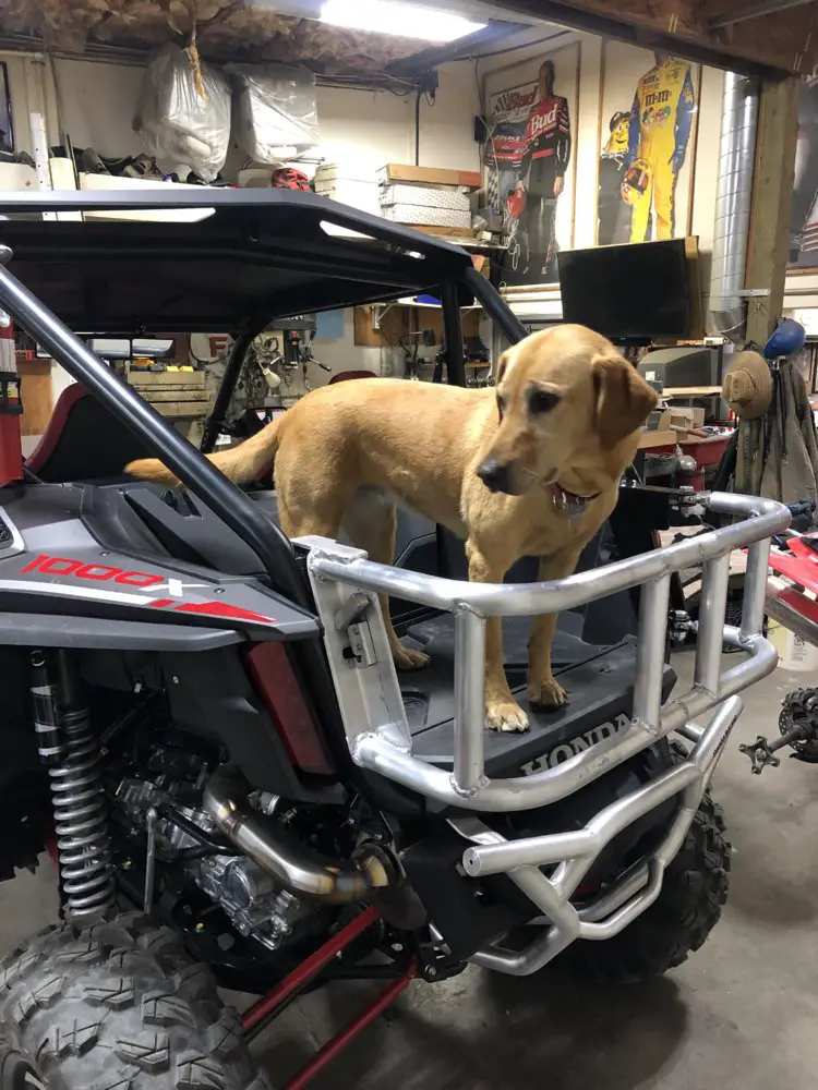

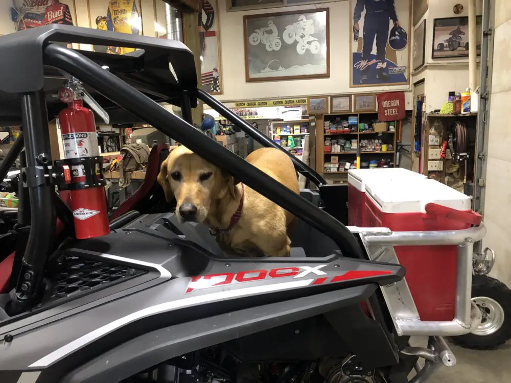

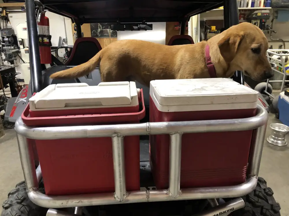

If you look at my previous post, you can see that mine is made out of aluminum tubing, swings out, uses a slam latch, and holds 2 coolers, 4.5 gallon gas, and 2 waterproof bags hang on the outside of it. It still leaves room for my bird dog too.

think yours would be strong enough to carry weight of Spare tire & wheel and stay latched??
I really like your design, Ken. Only thing I'd consider adding would be a piece of sheet aluminum (diamond tread perhaps) across the bottom that would keep things from being able to roll out. I'd probably prefer black too, as my bumpers are black. But, your design appears to afford much more usable room than others I've seen.
QUESTION: Could you post a picture of the tailgate swung all the way open? I'd like to see how it hinges and swings.
Thanks,
Steve
I originally was going to hang my spare off the back of it, but needed more bag storage, so I put the spare on a roof rack with a shovel and axe. I always build stuff to last, cuz I don’t like re-doing anything. The tubing is .188 wall 1 1/2”. The mounts on the roll cage is 1/4” steel, and the hyme joints are 1/2”. The latch is a automotive style 2 stage. When it’s closed, there’s a tab on the latch side that all of the weight sits on.
Thanks,
Steve
Sure! Don’t look at the welds too close. I’m still teaching myself how to tig weld aluminum. I get a couple of good ones, and then some s***ty ones.
411E50A2 33CB 4743 B9ED E630CA55C6A4 5660462B 3408 4374 BBB2 38B8ECD10E2C F6665DB8 92B9 4775 8C30 5504762B2ECC 189BE29B 4AC2 40AE 9C70 06B6FD63DCEB 56335C02 C8CD 46FE ABE4 4A7512B89EC3

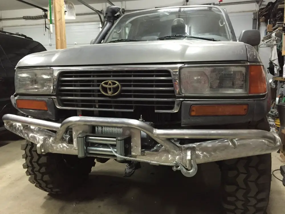

Sheetmetalfab
Sheetmetalfab
Jul 21, 2019
2,218
13,996
Alaska
Did you machine the threaded bungs yourself?
if you bought them, where from?
(I’ve looked for aluminum bungs before without luck)
i can handle posting some aluminum tig eye candy.
