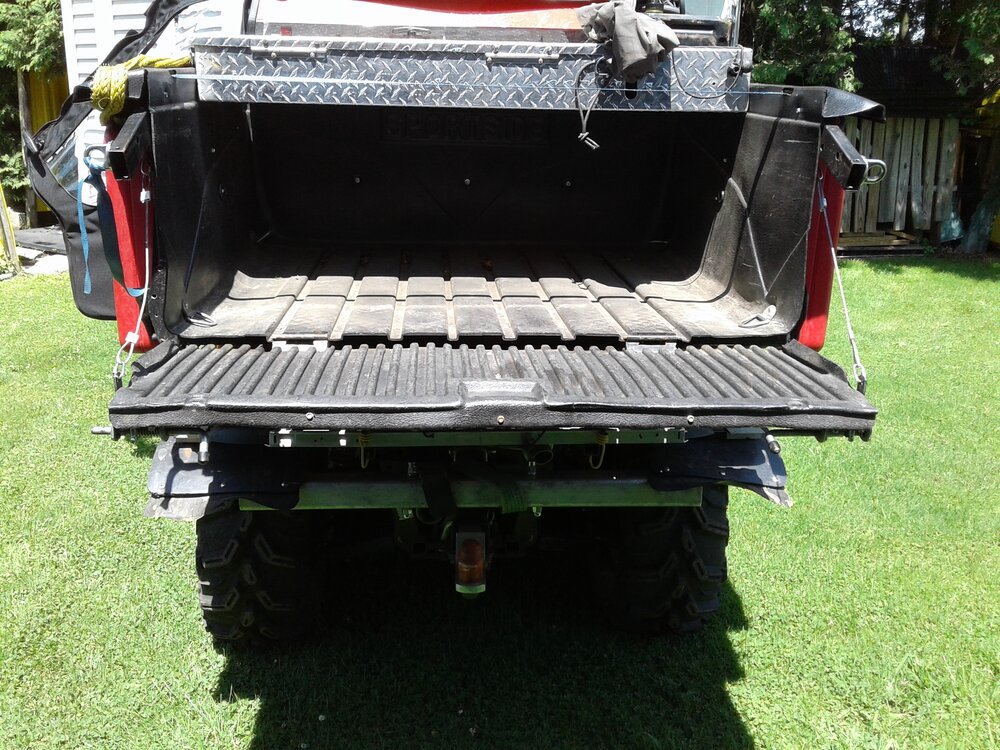

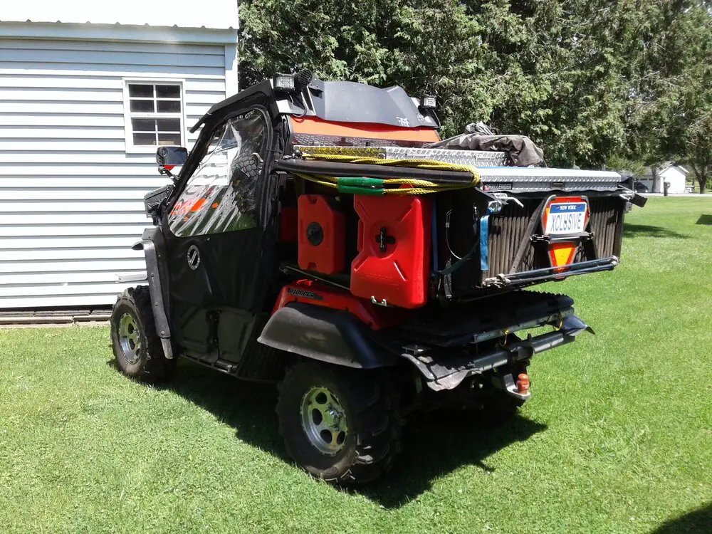

1st -- Welcome from Upstate N.Y. to the ragtag group of Honda pioneer 500 & 520 owner & riders
A LOT of Good Info. & B.S. to be had here.
At 61 still a young man compared to over 3/4 century.
Shifting :Time in the seat is the FIX.
Does smooth out - with mileage -- oil changes - as you learn how to shift for smother shifts ( some use drive it like you Stole It Method -- others early shift & keep RPM & Noise Down ) somewhere you'll find the spot that works for you.
500 & 520 Both Proven & Dependable
If both were available when I purchased - "520 would have been the Choice" ( BOX being main reason ) NOT enough Reason for me to trade or sell the 2018 P500 I have. -- Added my own version of a box made out of a boxliner.
Unlockable ft. Diff. "No"
After market -- Torq-locker does allow slippage on turns -- ( Made right here in Upstate N.Y.) you will want & NEED in gumbo mud.
Tires : Several Hundred to choose from.
Radial - 6ply min open tread simular to Ag-tread for your gumbo.
I've been using ITP- XTR 6ply -- 27X9 x12 ft.& 27x11x12 rear on 4x3 ITP Alum wheels on last 3 machines ( rzr - P700 - P500 )
Doesn't over tax drive line of the P500 -- Decent all around tire with smooth ride & self clean .
RED is the 1st.color all other colors followed & Honda hopes they sell.
FYI :
The pioneer 700 has a 3-speed auto trans with paddle shifters & shifts smooth ( bigger machine )
View attachment 283384 View attachment 283386
Will the tires you mentioned fit on the Factory stock rims ?
Which width goes best in the Gumbo ?
Are these the tallest gumbo tires that can be used on the Pioneer 500?
My driving style is very slow and steady and most of my ground is flat as a pancake.
The only exception would be when I need to cross a rice levee which is why I am wanting as much ground clearance as I can reasonably get for the Pioneer 500

Yes fit on OEM rims
Width : Wider floats better.
Has to be at least 100 different tread designs that ALL claim to be the best & several times that number
( guys & ladies on this forum claim they have the best ) Donot claim to be the best but -- ITP-XTR's work for riding in the ever changing Adirondack' Mts. of Upstate N.Y.
Think of the P500 as a little 1000 pound Tractor & set it up to your Needs.
Heigth: CAREFUL to much UP puts strain on axles.
Some run 28-29-30's sure can be done - BUT - Bigger you go the More the Drive Train is Strained ! ( in gumbo ?? )
Many will say if you go Up need to go Out ( wider ) your flat terrain may not apply.
Whole MOD thing finding what works Best for your situation becomes trial & error.
Shock spacers will push it up - BUT - you lose ride quality ( trial & error )
FYI: Didn't take long for you to find out ( "as Mothers say" ) SOME are More FULL of THEMSELVES than Others
