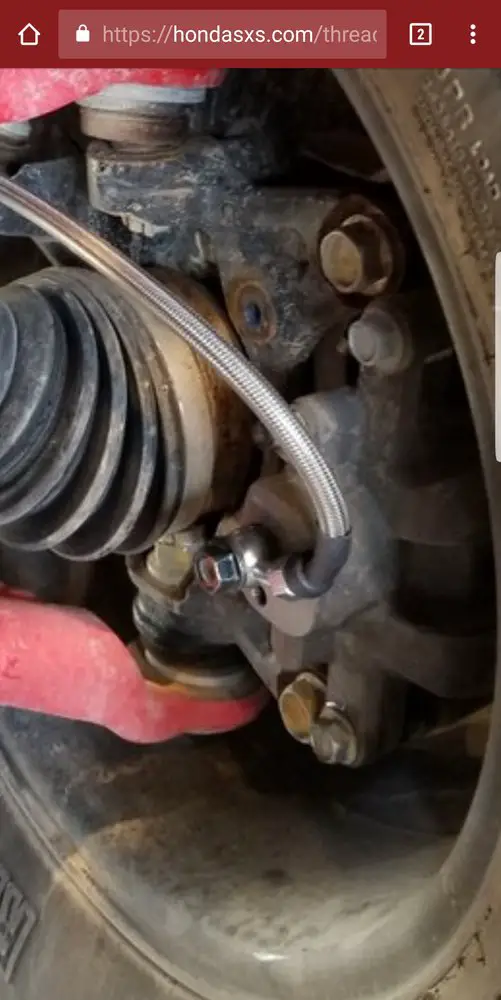

It was my bad, We got a little late start yesterday. I wanted to be like all the rest of you all and instll a set of @jak9922 SS brake lines.

@Tramguage1
That end of the brake line should be pointed straight up, @jak9922 can confirm, but it looks like that is going to be stressed just sitting relaxed. That bend looks severe to me.

@Tramguage1
We talked about it when we installed. It does interfere with the bleeder screw when straight up. But we did lengthen the line between the caliper and the lower clamp. I will keep an eye on them, prolly turn them up a little. Thanks

@Tramguage1
That does look like a bad angle cant imagine a full lock left turn. Please straighten it up, makes me cringe.
