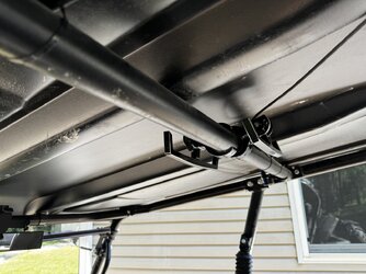

Whip It: 07-05-24
I installed the PBR whip mounts. Very easy and straightforward. Uses existing bolts on the rear near the ROPS. They feel like very good and stout mounts. I had a set of Amazon 2ft whips laying around that I installed as well. Eventually I will get some nicer whips. I tapped into the power at the passenger rear tail lamp and tucked the control box into the frame
IMG 1890
IMG 1891
IMG 2378
