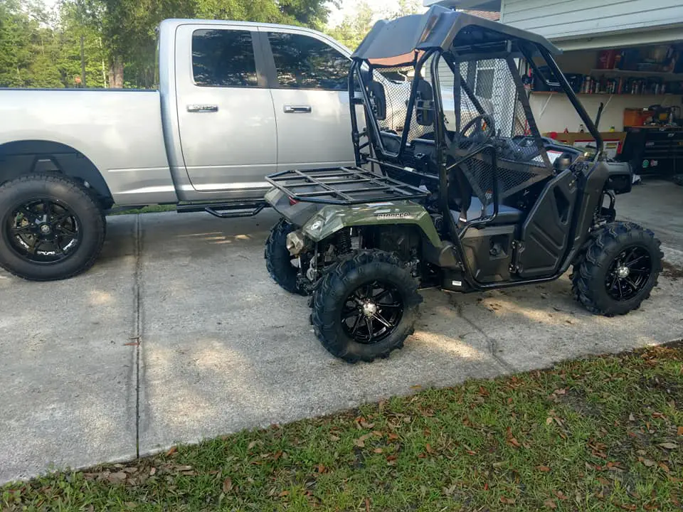

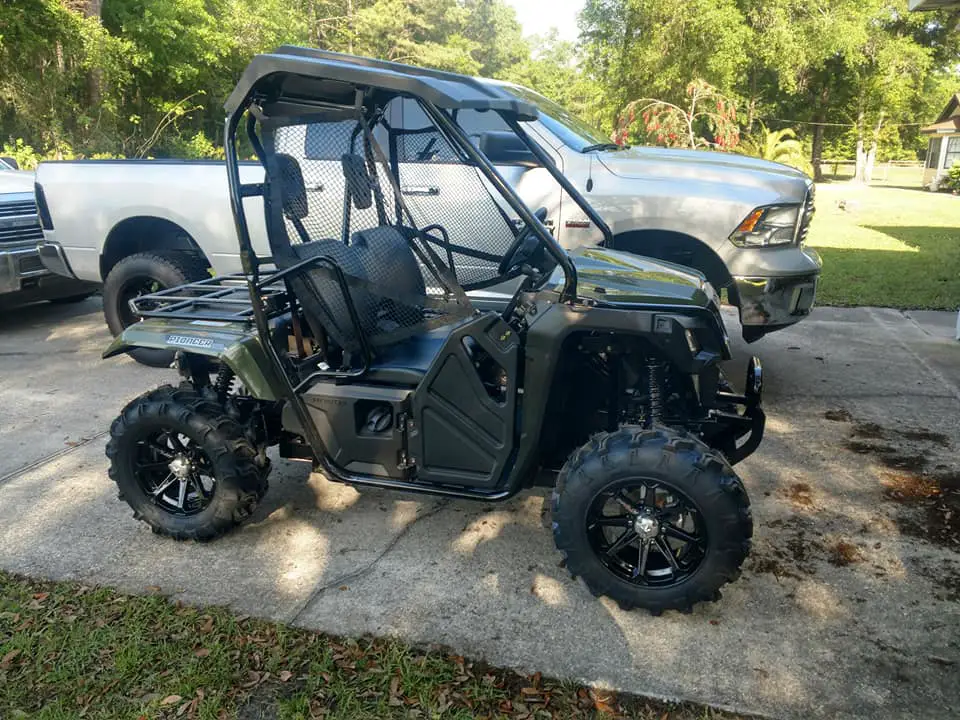

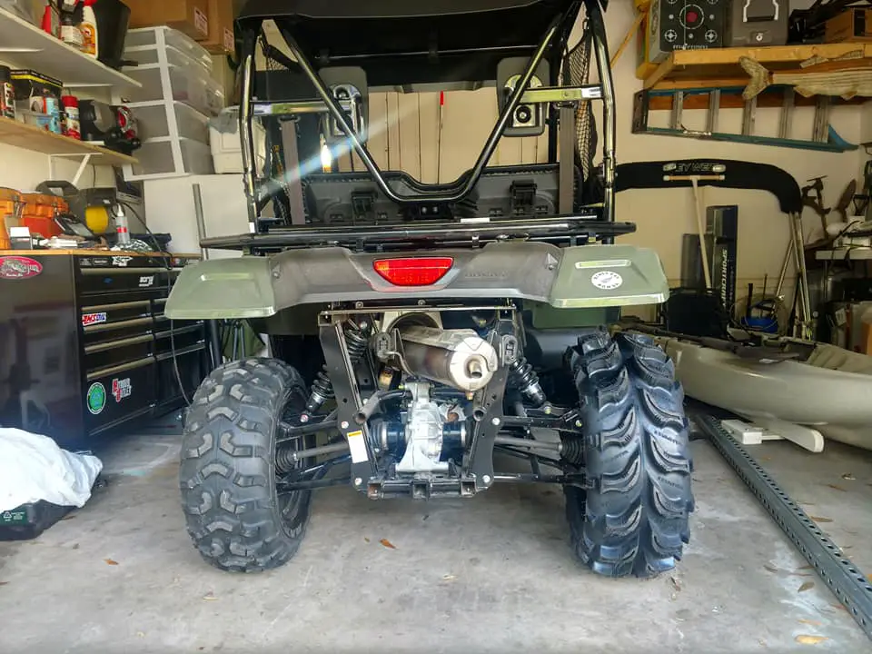

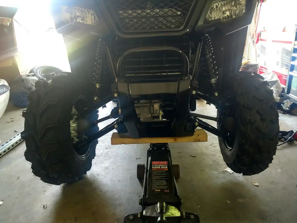

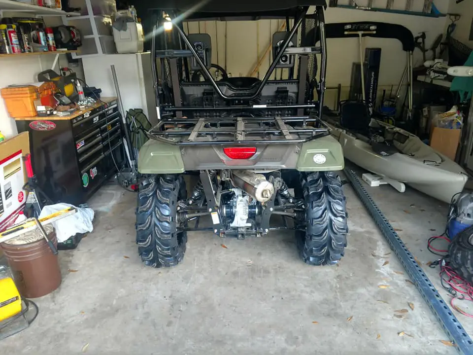

Finally got my wheels and tires in. I went with MSA M12 14 with a +10mm offset to give me a wider stance then the 5+2 offset. I went with 27” vampire 2’s. 27x9-14 front and 27x11-14 rear. They measured 27” with 10psi and 26 3/8” 5 psi. Got me some much need ground clearance (2”) to be exact. Will put them to the test soon a report back since this is a new tire and not a lot of people are running them yet.
