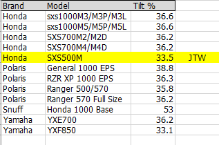

I believe that with the width
I thought it might be worse...
But think about this for A minute...they are saying the X4 is less stable than a 500? Who would have predicted that?
We all know there are various types of "rolls" and most of them don't involve rolling straight sideways off a hill, so these have to be taken with a grain of salt. Still, some suprises here...

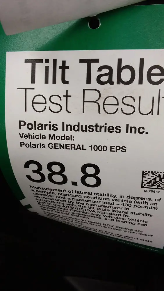

Having trouble uploading pics...
The highest I saw today was a 2 door General at 38.8.

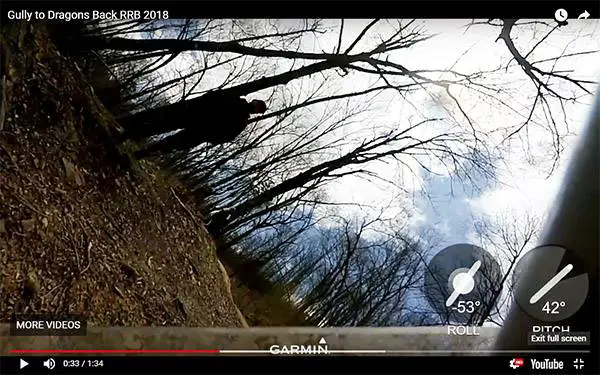

U am trying to remember where @drfubar tilted over when he was doing the measuring via the Garmin camera. I remember he tried with a tractor to see where the tipping point was.
Does any one know if it affects where the tilt gage is located ? meaning the floor vs headrest - I assume an angle is an angle but who knows..
Also strange that a 1000-3 and a 1000-5 would be at same angle or maybe the angle of measure is for a specific unit model and encompasses all the models - like a blanket so they test the heaviest P1000-5 and that covers the lightest P1000-3?
