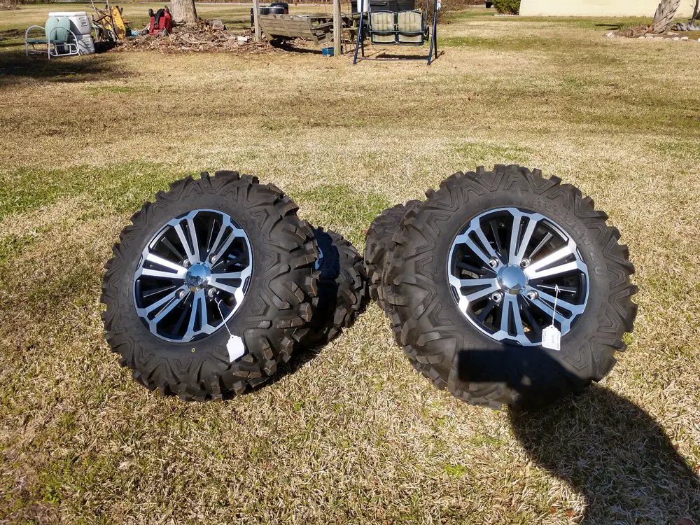

THEOLDMAN
THEOLDMAN
Apr 4, 2018
238
351
Washington, North Carolina
Price? Pictures?
$600 for tires and rims.
