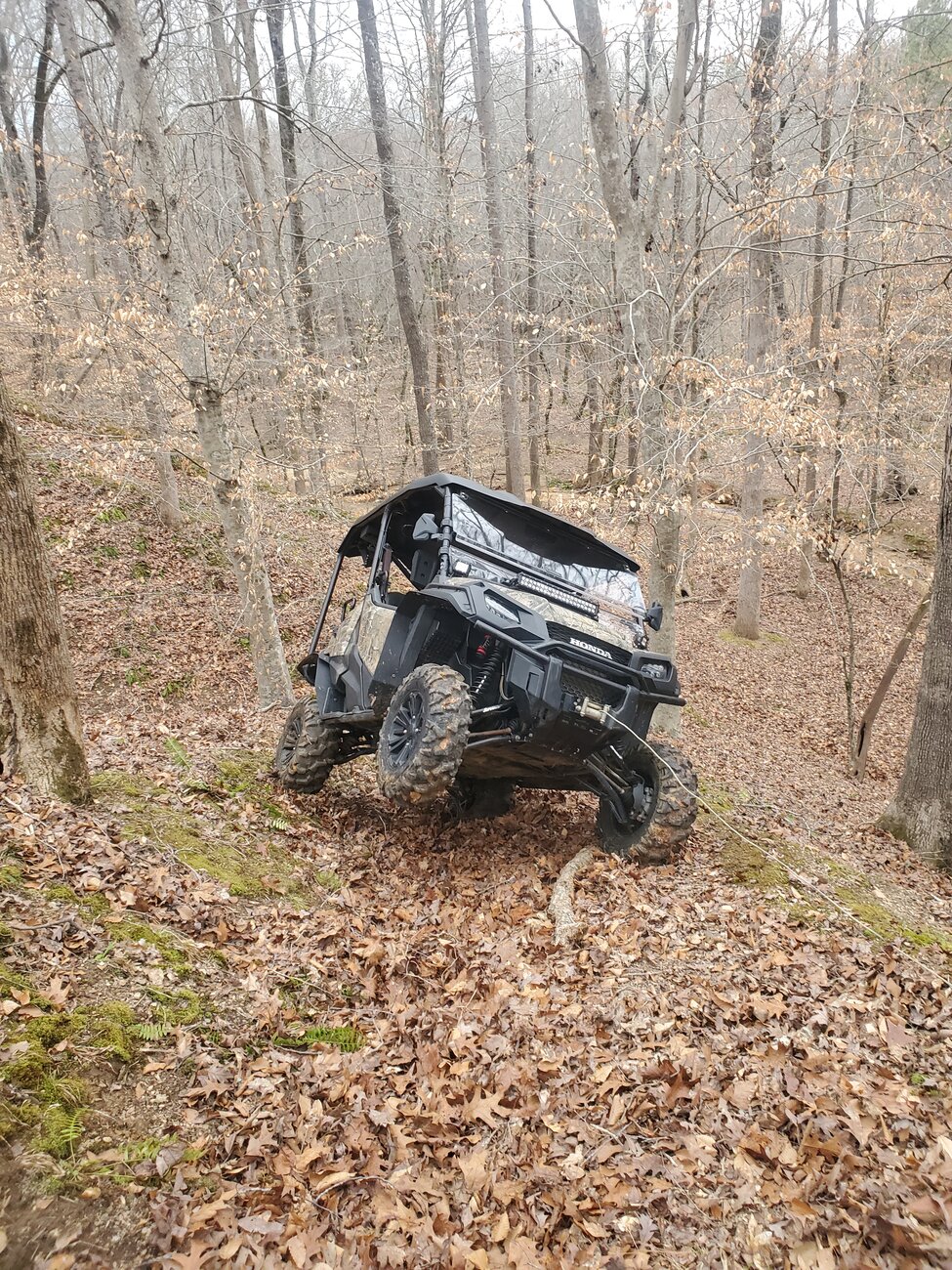

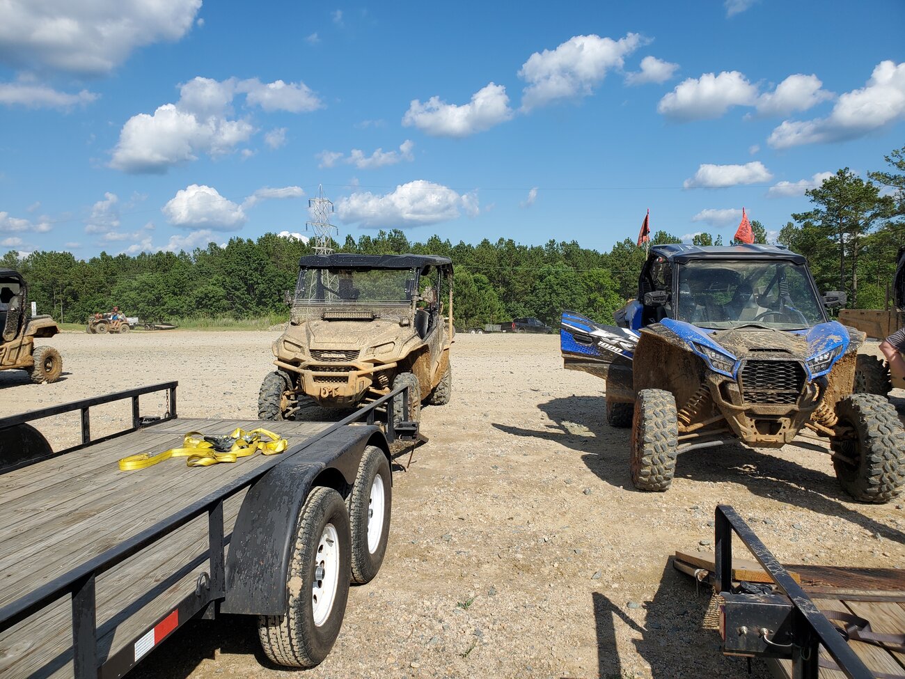

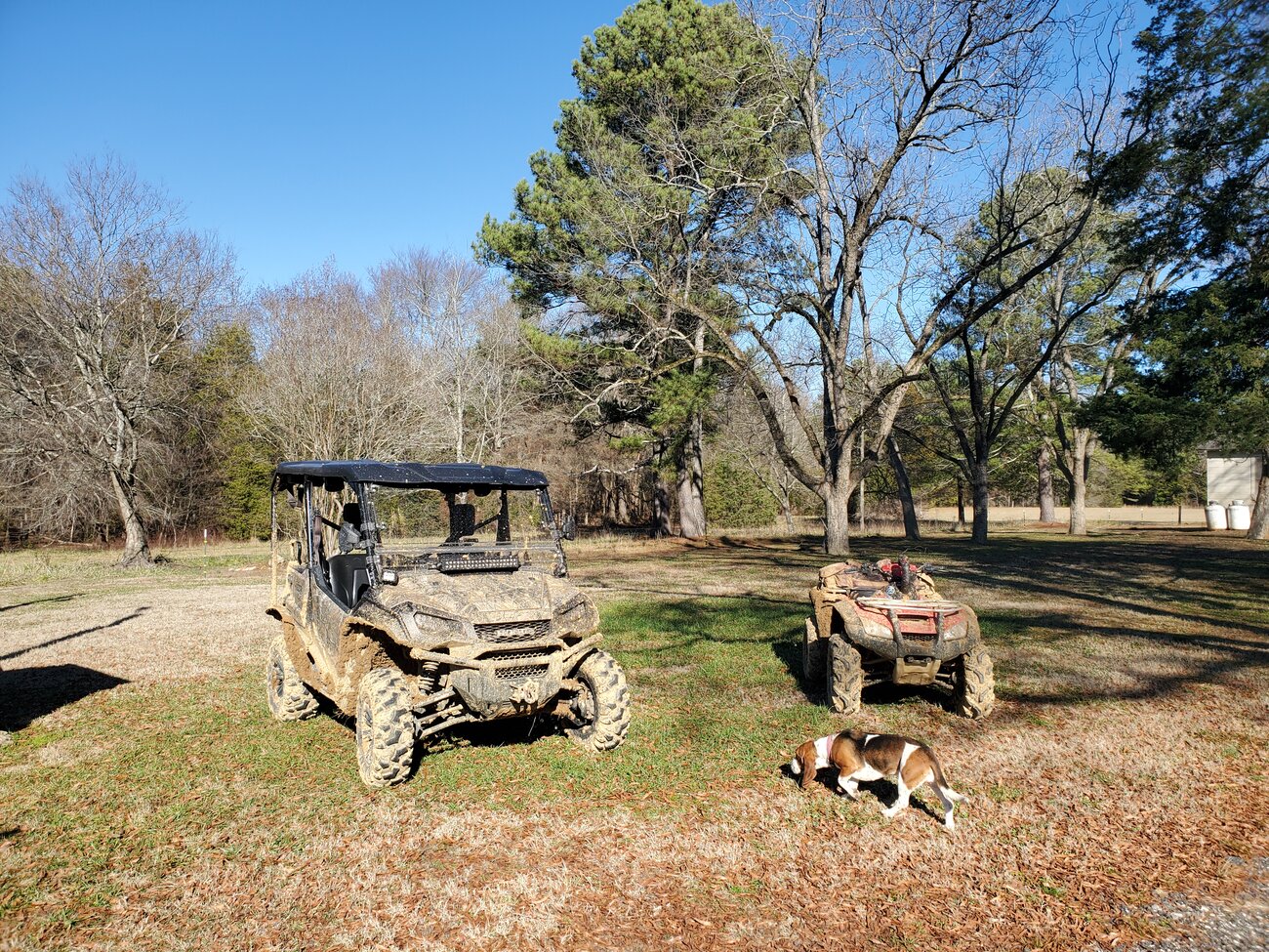

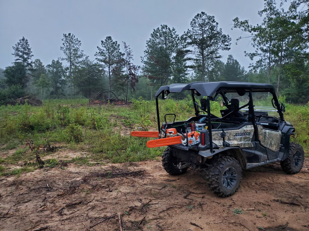

I went up to 28's on my 1000-5. Got 9" wide on the front and 11" on the back just because I didn't want to buy aftermarket wheels. I also got the widetrack spacer kit from RB3. I know this set up is different than what most guys go with on here but it has worked for me so far.
Everyone will say you can't notice a difference but technically if you put 10" wide tires on the stock rims then the back tires will end up being a little shorter than the front because the back rim is wider than the front rim. There are some people that are running 10" wide tires on stock rims with no issues though.
I don't have any really good pics but here's a few of my set up
View attachment 424553View attachment 424554View attachment 424555View attachment 424556
